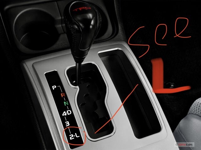

    I was driving down a steep colorado hill in a blizzard with a automatic transmission. historically ive had some issues engaging 4lo so when things got sketchy and steep i was already in 4hi and then shifted my gear stick to L. I drove probably 10-15 miles like this. The car was def moving slower than 4hi so im under the impression the lower gear engaged but there wasnt any cranking or anything while driving or since.
    any thoughts/would you think there was damage?

    As long as you stayed under redline it's fine

    What you did is no different than driving a manual in first gear while 4Hi was engaged. Drive all day in 1st gear (or Lo) in your case as long as you are within the operating limits of the motor (temp + RPM) and the xfer case (not binding it up doing tight turns and whatnot on high traction surfaces) you're fine. When I think low speed and 4WD in an auto my first concerns are engine and transmission temps since you are moving so slow. You were in a blizzard though so temps shouldn't be a concern.

    He said he put the transmission gear selector into L = 1st gear.

    Not that I’ve tried but can you even bury the needle on an automatic 2nd gen Tacoma? I’m pretty sure that if you shift into L while going too fast, the ECM will not allow the shift to actually occur, or will it?

    the rpms stayed between 2-2500 and the temp gauge never diverged from right down the middle between hot and cold. really appreciate all of the insight!

    If you drove in the lower gear for an extended period about all that might do is raise the transmission temperature... probably fine but i wouldn't make a habit of it.

    The chances you went 10-15 miles in 4Lo is slim to none.
    4Lo in 1st gear (L) is like 3-5 mph.......and for 10-15 miles?....Nahhhhh
    If the switch was in 4 High, you were in High range 1st gear (L)

    What you did is called engine braking and it’s the most important technique for safe driving in mountain passes in any weather, and safe braking on any slick road condition. Read up on it and use it, every time! It works regardless of transfer case setting.

    The op said he was in 4H with the auto shifter in the L position... never said he was in 4L. Like metioned above it's normally used for engine braking/slowing down steep grades instead of riding the brakes.... not to be used for extended periods of time per owners manual due to possible overheating of tranny iirc.

    Lmao at all the keyboard warriors in here. Go and re-read the OP, as many times as it takes to comprehend he was not touching his transfer case gear selector.
    @TacoTuesday1 ”L” means locking an auto trans into first gear. You never drive an automatic?? We still have choices too you know ;)
    to expand, whatever gear you select there will be the max gear the ECM will allow but it can still shift lower. For example, put it in 3 and come to a stop, then go again, and the truck will start out in 1st but never shift higher than 3rd unless you shift to 4 or D.
    edit: oh and “R” stands for Race :D

    The problem is, OP didn't make his question clear.
    He says he has issues with 4Lo.
    Then he says,
    You can't be "lower" than 4Hi, with out being in a gear lower than 4Hi. The transfer case houses 2 ranges, Lo and Hi.
    The transmission has nothing to do with 2Hi or 2Lo.
    There is not but one way to be "lower" than 4Hi, that is 4Lo
    You (TireFire) may already know this.
    But this is where some have gotten confused and answered the way they did.
    The question is, what is OP calling 4Hi?

    No dude, there is no 2L. It’s 2 (2nd gear) on the left and L (1st gear) on the right. It’s to allow engine braking with an automatic, VERY useful and critical to keep brakes from fading. Also super useful off-road.
    IDK what your talking about with “simply revving too high, sounding bad vs later mechanical overrev” …. There is no difference. Overrev is overrev. The engine is connected to the wheels thru the drive train. Even with full fuel cut bad things can happen (think valve float, rods, main bearings, belts & chains, etc).
    by the way, both in manual & auto trucks the ECM already cuts fuel under engine braking in all modern cars. I’d you had an AFR gauge you see it read all the way lean
