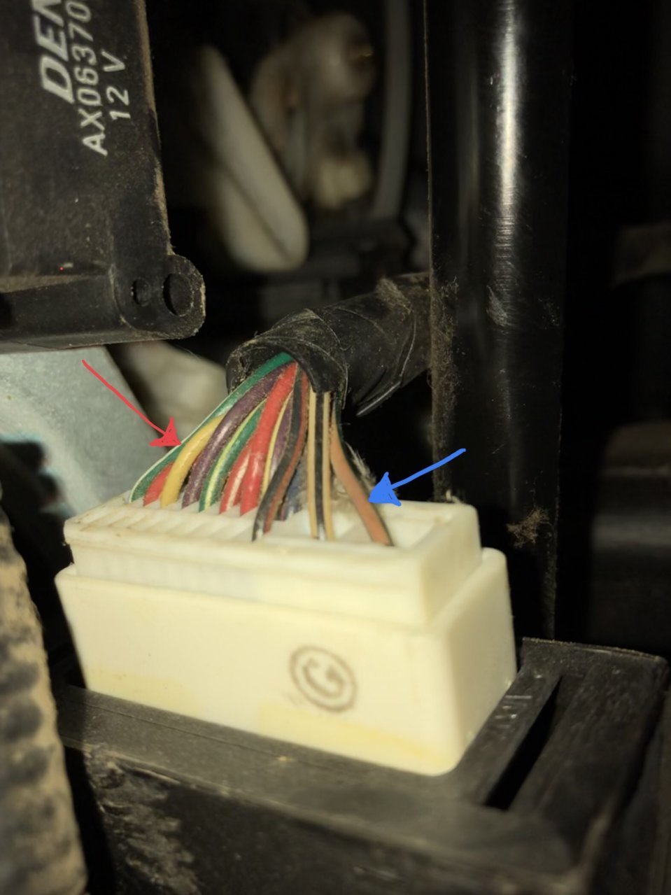

    The plug is only for the old models.
    From @Ace115
    I cut the one in the pic with the red arrow.
    From the other articles I read, Ishould have cut the one with the blue arrow. I’m going to try it tomorrow morning and see how itgoes.

    Hey chrslefty, thanks for the reply. I can't find the thread with the wire cut pictures right now but I do remember it is supposed to be the white with green wire. In your pic that connection looks right but I would be sure that the wire is white that has faded to yellow, before you cut it. Maybe pull the harness wrap back a little and see if that wire has faded and is truly white with green stripe.
  12. Oct 17, 2019 at 8:22 AM
    Ace115
    Ace115 Well-Known Member
    Jul 2, 2016
    #191086
    1,553
    Andrew
    Tucson AZ
    '03 DBL CAB 4X4
    I would use the wire color as secondary information when doing this job. From all the research and photos I saw the wires color was not consistent through the different years of the 1st Gen. Instead just pay attention to the port on the plug. I did in fact cut the wire with the blue arrow from that photo. You’ll notice on the plug that it is the wire closest to the end of the plug and the wire socket is larger than all but one other wire socket(the one next to it). There was one post that had a very rough diagram of the plug, made in a program like MS Paint or something, that had the ports labeled and tagged correctly. If you stumble across that post I’d use that info to make your decision as to which wire to cut.

    I cut the wire the other day. Hasta lueogo DRL. I cut the harness wrap back enough to expose enough wire so it could be spliced back together if needed.
