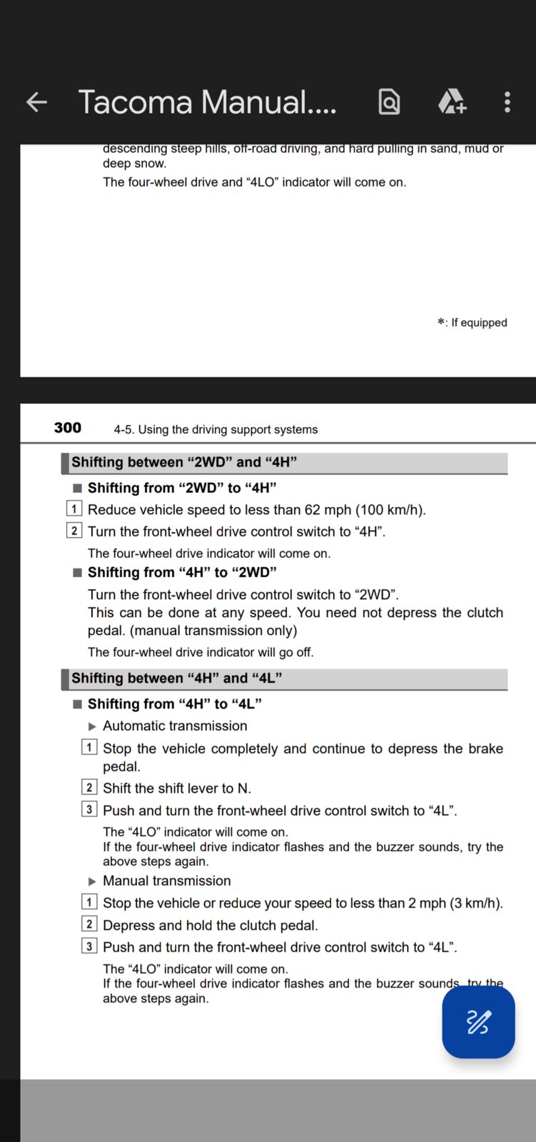

    Ok, I have a question to the first question. At what speed can you engage it in?

    For me, it’s as low a speed as possible. Remember, the front drive shaft and ring&pinion are sitting idle. Only the axles and spiders are spinning. When you shift into 4WD, the drive shaft and gears are suddenly brought up to speed. Whatever limit they give in the manual is where they think things start going from ‘maybe still ok’ to ‘don’t do that’.
    I might shift at higher speeds, on snow or loose gravel, if I needed to. (But never over the limit.) Otherwise, I slow down as much as possible.

    55MPH is the limit for 4H engagement. If you try to engage it above that it will beep and not engage until you slow down .

    I will stick to dead stop and switch over
  13. May 10, 2024 at 11:20 AM
    fathomblue
    fathomblue I used to be disgusted; now I'm just amused.
    Sep 13, 2014
    #138206
    1,462
    Richard
    Eastern Kansas
    Cavalry Blue 2019 DCSB SR5 4x4
