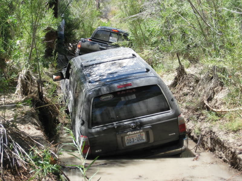

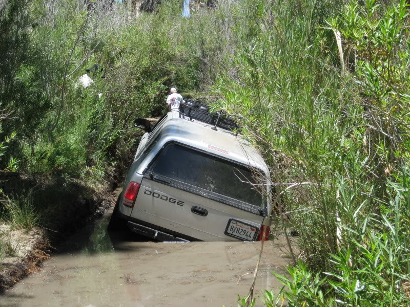

    2 feet with a 3 foot hole along the way... this was where my differential got contaminated and why after I got home, had the fluid changed and did the differential breather mod (link in my sig)... Photos taken from inside my truck of others on the run. TW member HBMURPHY was with us... see his YouTube videos taken while driving through the BOG, between the Widowmaker and the mission.
    Paul's video... specially after 1:28 min. with volume up to hear Zoom scream! LOL:
