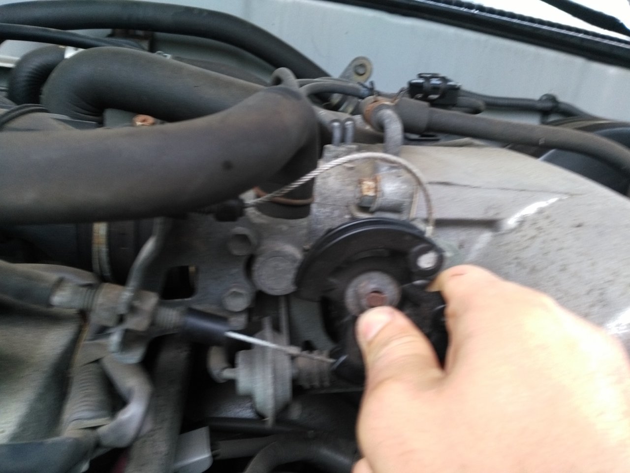

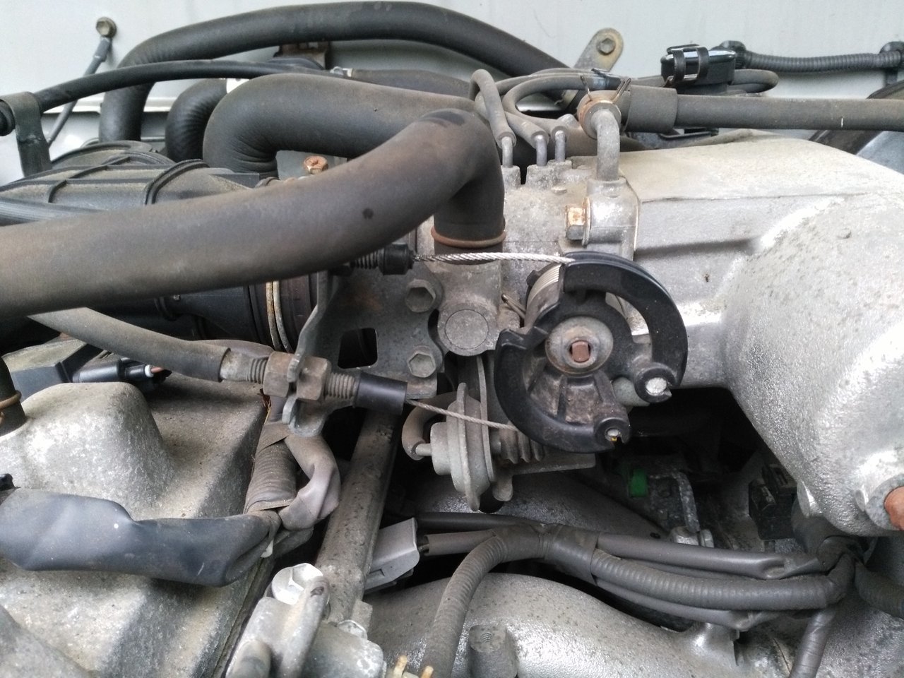

    I inspected the throttle cable. The cable from the gas pedal to the throttle body is pretty loose, so I think I'll tighten that one a bit. I played around with it to see how the cables were responding. I'm aware that the cable on top is attached to the gas pedal and there is tension applied to it when the gas pedal is pressed, so this picture I show is not exactly how it works since I am pushing it the other way by twisting the pulley, but I found it an interesting observation that if I turn the pulley fast and fully, the cable binds up on the rubber boot and looks like this picture. But if I turn it slowly, the binding doesn't happen at all or it just slows the return of the cable. As I tried this action back and forth repeatedly (I made a video) it was like the same experience driving up the hill - the kick would happen HARD if I continued at a constant pressure or more pressure on the accelerator or it wouldn't happen and the shift wouldn't happen either, but if I let off the accelerator quite a bit, the kick would always happen but much softer and then it would downshift, and I would apply the accelerator again to continue up the hill. Anyways, I'm going going to try to tighten that cable and see what happens.
    As far as the ring and the boot on the lower transmission cable goes, I checked it and it is very close to flush with the opening of the rubber boot OR it is slightly inside it. I'm thinking that adjusting it so that it sticks slightly out of the boot as per the spec says (0 - 1mm) might help? Trying that as well, might as well do them both at the same time.
    Also, in this 2nd picture above, I noticed back where the spring is, there are 2-3 pieces of metal that seem out of place to me that you can see here underneath the upper accelerator cable and above the black plastic round pulley material. What's up with that? Maybe just the tension for the spring?

    Alright, that's all folks. I did the adjustments stated above, sprayed some PB blaster on the upper cable as far as it goes into the boot and out of the boot, no more problems. So there.
