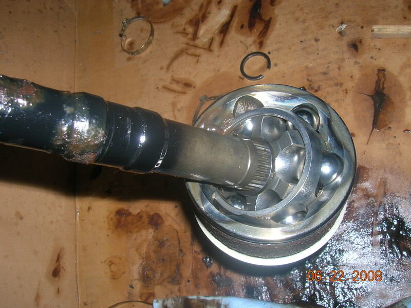

    One solution requires you destroy/dismantle a couple cv's. Take the hub side/outer part of a cv and separate/cut off the shaft at the joint.
    Then take the outer cv and bolt it into the hub and torque the nut to 170 ft lbs, pain in the ass no doubt and cost you at least $100 for parts store remanufactured cv's
