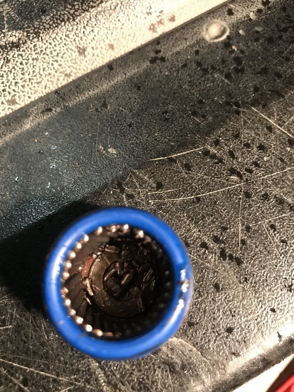

    I finally got them removed!! Old cap was stuck but I was able to get it...I was replacing all 3
    Here why my new spicer wouldn’t go in properly :anonymous::annoyed:

    Been there, done that. It may not be kosher, but clean it out really well, repack the needles with new grease and borrow a roller from your old u-joint if there's one that's in good shape.
    It's not the best solution but I did it years ago and it worked. OR you could buck up for another new one.
