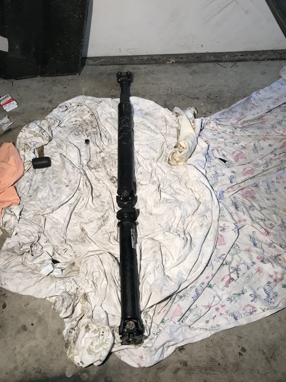

    Got it done!!
    Everything works great. Just have to fix the 5-10mph shudder though3D5A8052-4A68-4528-8330-5A55F58B8BDC.jpg

    Damn it, lol you destroyed those fallen bearings. Use a good finger of grease to hold things in place. I've dicked up a few myself. You'll get it man take your time. If resistance increases significantly when pressing caps in it's better to back off and take a look than apply tons of torque to your press.
    I see you got it! that shudder may just be axle wrap not a shaft problem. You running stock springs?

    I’m running dakars
    I think I may need to lower the carrier bearing more.
