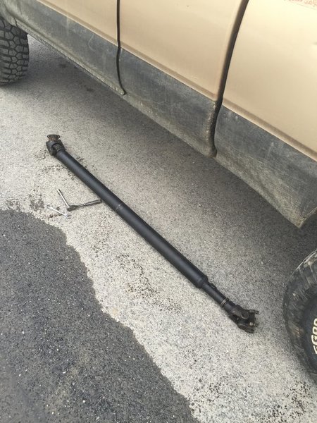

    image.jpg Boom new one piece shaft, $183

    Drove the 110 miles round trip to get my shaft today, got home and it's only got about 1/4" until it's bottomed out so its gonna stay out till this weekend when I swap in the 5 speed and free up 2 1/2 inches. Also, truck vibrates a little at 70 probably from an unbalanced front shift? Or maybe transfer case slack
