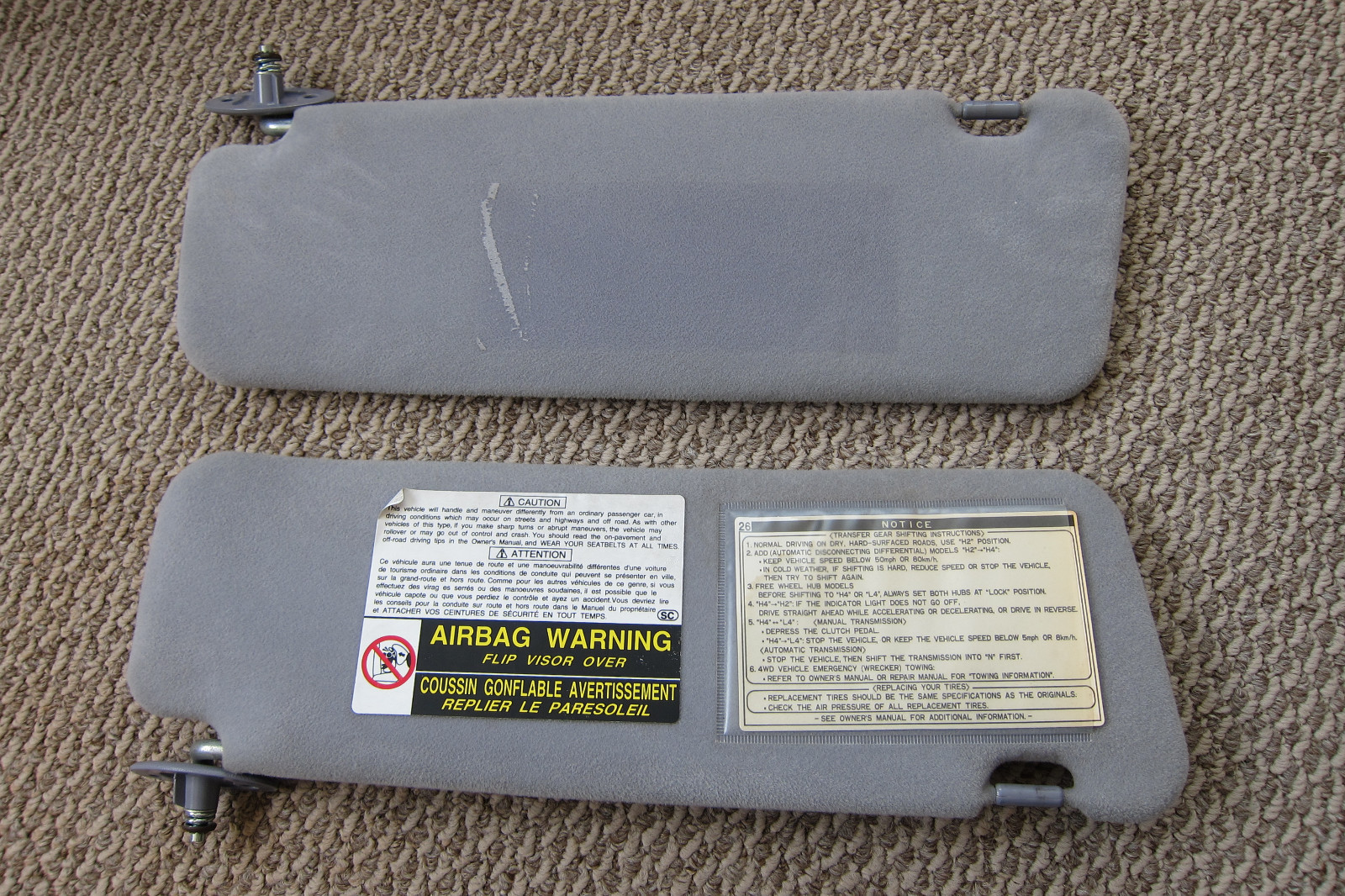

    also, it says not to "engage" 4wd over 50pmh. doesn't say you can't "drive" over 55 pmh :D
