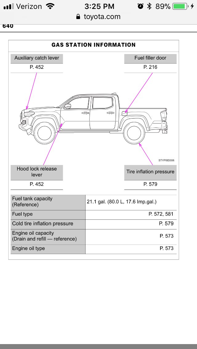

    21.1 gallon tank and more in the fill hose when you top it off.

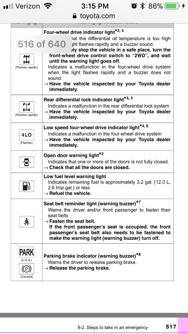

    ~3.2 gallons when the light comes on
    So if you’re averaging 18 mpg you should roughly 57 miles until you run out of fuel

    Did a real life test on the gas light coming on and how much you have left in the tank this past weekend on a return trip from L.A to Phoenix. Came rolling into Phoenix to the gas station below E. The process goes, x miles to empty, once it hits zero says "refuel the vehicle. The 3 gallon reserve is accurate. I filled up and it had took 19.6 gallons and I believe the tank holds 21.2. So as I said, came into PHX extremely light.

    21.1 Plus whatever extra someone might have stuffed in the filler tube
