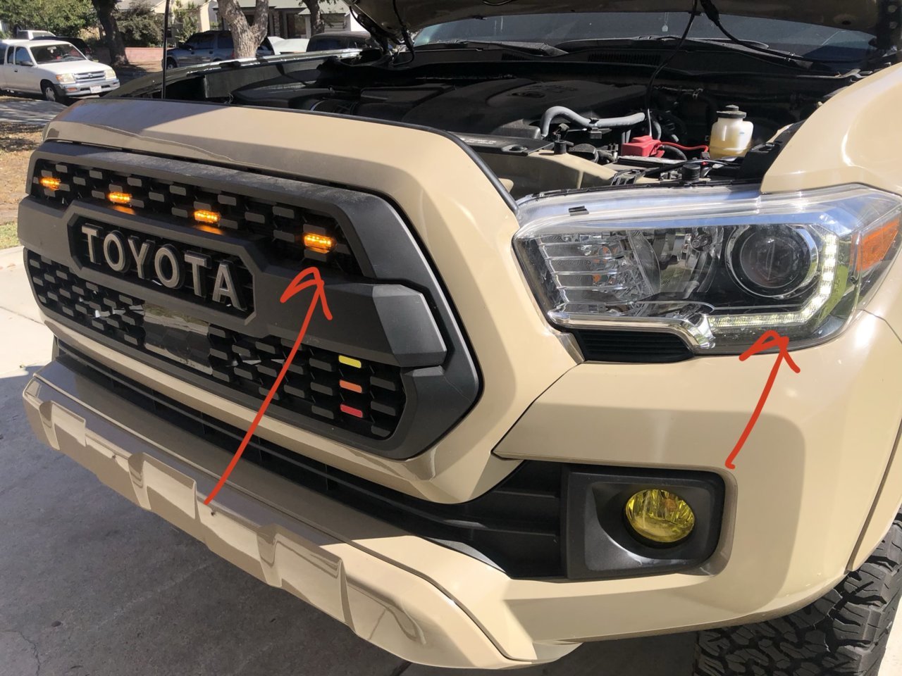

    Hello everyone,
    I’m new to this forum, but i was hoping someone can help me trouble shoot my headlights....
    A few days ago, i blew the DRL fuse while swapping out my raptor grille lights and ever since then, i cannot get the DRL’s to work with the headlights at the same time. I replaced the fuse and the DRL’s/grille lights only power up when i don’t have my low beams on (only when switched to DRL & parking lights). When i have the headlights engaged, the DRL’s and the grille lights won’t turn on. They function perfectly fine, just not all together.
    When i originally added my grille lights, i spliced into the low beams and the DRL’s. They worked flawlessly until i switched them out a few days ago. I don’t know what happened after that.
    Any help? Thanks!

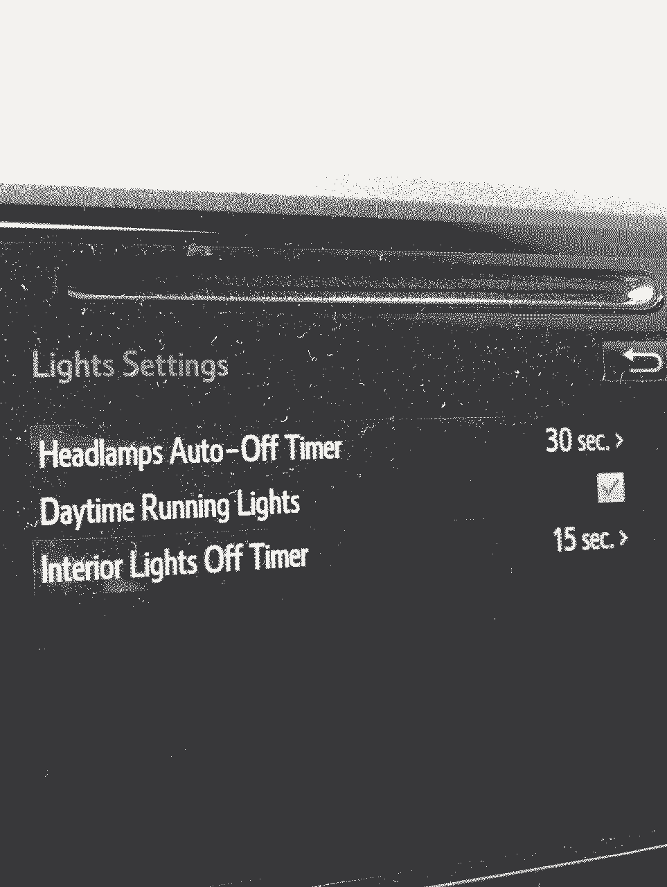

    The DRL box is checked on.

    are you tapped into both DRL circuits? I think the DRL circuit for low beam is another wire? The DRL circuit is a 3 wire plug. Green wire is DRL without low beams and Pink/Blue (Driver/Passenger respectively) wire is DRL with low beam on.

    I tapped into both green and pink wires.
    I followed a YouTube tutorial video and followed it step-by-step. After completing the installation myself, it worked perfectly fine. When i swapped out the old grille lights for the new ones, the wiring assembly remained put. I never messed with it. Just the LED lights themselves.
