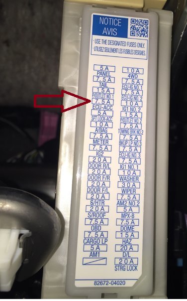

    Hey @Ceego3 ,
    I watched the same exact video as you did and blew out my fuse in doing so too. My DRL's and taillights are all out when driving with my headlights on but work when I break. What fuses exactly do I need to replace in order to fix the problem?
    Thanks

    Check the 7.5 amp ECU-ACC.

    Hood Struts, My version Fogs always ON, Map & Overhead Light Mod,
    You don't. The vehicle does, CAB fuse box...

    2019 White Tacoma TRD Off-Road
    It was the 7.5 Amp TAIL
    I never stated anything about my truck's DRL circuit. I stated that my DRL's and taillights were all out when driving with my headlights on but worked when I hit the brakes. Then, of course, I asked which fuse to replace because the creator of this thread fixed the same problem that I had, but never stated what fuse. But thanks for being so literal.
    It's implied. Check your towing harness for damage. Since they turn On at stop, it is the most likely cause for the Parking/tail circuit to fail and the stop circuit wires are close...
