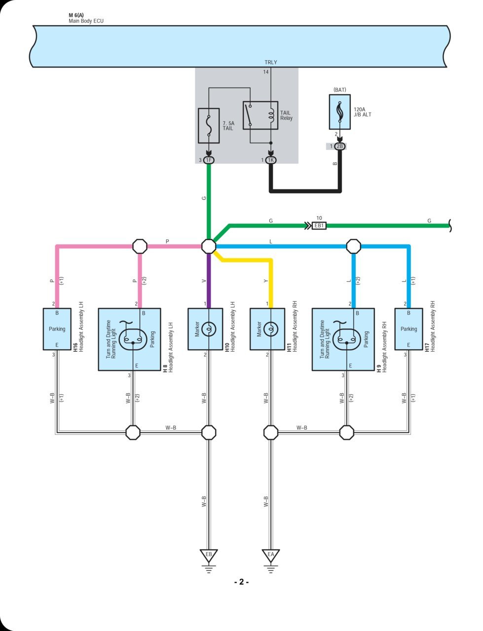

    Need some help with this one. My DRL and parking lights don’t work on my 2018 TRD sport. I’ve checked, it doesn’t come on when driving and the parking brake isn’t engaged. The lights DO work when I turn on my headlights.
    Any help would be appreciated! I’ve done some mods but nothing that should’ve caused it I don’t think.
