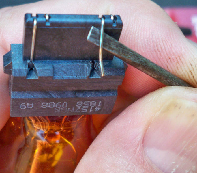

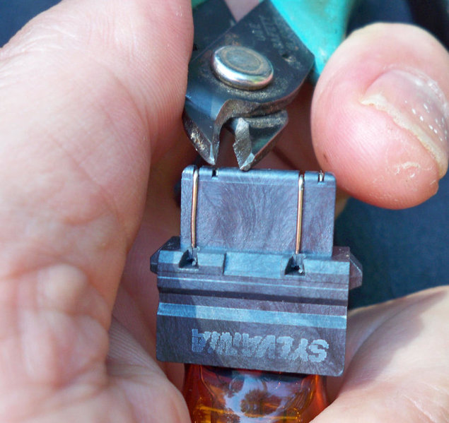

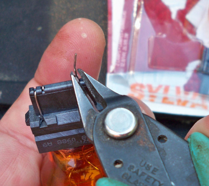

    So here's what i did and it works on my 09.
    (standard YRMV disclaimer implied here...)
    The 3157/4157's are dual filament bulbs. My idea was to disable
    the 2nd filament...(Not sure if a single filament bulb will work,
    but i didn't have any and this simple thing did work for me so far.
    In this method i'm disabling the upper filament (the one closest
    to the top of the bulb)
    Pic1: Carefully pry those inside terms away from the base and
    extend them upward to be trimmed.
    Pic2: Trim the two leads very close to the base.
    Pic3: Trimmed nice and tight...now do the other inside pin.
    (Note, just trim the two inside terms on either side of the base)
    Now the lower filament is the only one that comes on for both the turn signal and DTRL.
    In the standard bulb, both filaments are on when the DTRL is on...
    that is why they get so hot...so with this method the DTRL is
    some dimmer, but seems ok to me, no difference in the turn signal
    brightness btw.

    btw, a 3057 bulb is around 6.7 watts, but still a dual filament bulb...
    so not sure it would be that much better, but it should work if you
    don't want to trim terminals.
    Also, my DRTL/Turn Lamp Socket is the 2 wire type...not three...
    some year Tacoma's have a 3 wire harness??
    Hope this helps...too bad i waited until my driver side started to melt.
    PC

    So you're saying you clipped the 2 inside wires, right? One on each side of the base - clip one, flip it over, clip the other?
    Also, what about just using 3156/4156's which I think are single filament. Would they burn cooler?
  10. Sep 9, 2013 at 9:16 AM
    Collins
    Collins Well-Known Member
    Oct 9, 2009
    #24013
    314
    North Carolina
    09' Tacoma, 2.7L, 5spd, 4x4
    yes. that's correct...and make sure to nip them off close to the
    base so they don't touch the metal contacts when putting the bulb
    back in.
    Not sure about the single filaments?...a quick check says those
    are around 27 Watts, which would be way to hot i think??
    It looks like the outer pins are right though...just no inner pins.
    I'd have to get a single to know for sure, and my local place didn't
    have any ambers Saturday.
    oh, and thanks for the props guys!!
    Actually i was just trying to disable the DTRL and only have the turn
    signal with this...but was surprised that after disabling the upper filament,
    the DTRL still illuminated?...like i said, i don't know how much cooler
    it will be...but i'll do that temp. measurement this week and
    get actual comparison temp. numbers between the mod'd and unmodified
    bulbs.
    Good luck with it.
    PC
