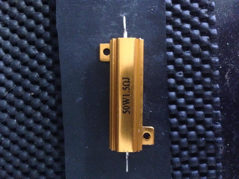

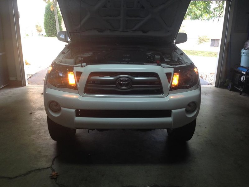

    I added a resistor to the stock bulb like mentioned in the above posts. I used a 1.5 ohm. Looks and seems like it will work pretty well. Didn't measure temp difference from before and after, but you could feel the difference easily. Maybe this will keep my new housings from melting again. Thanks for the ideas guys!:)
