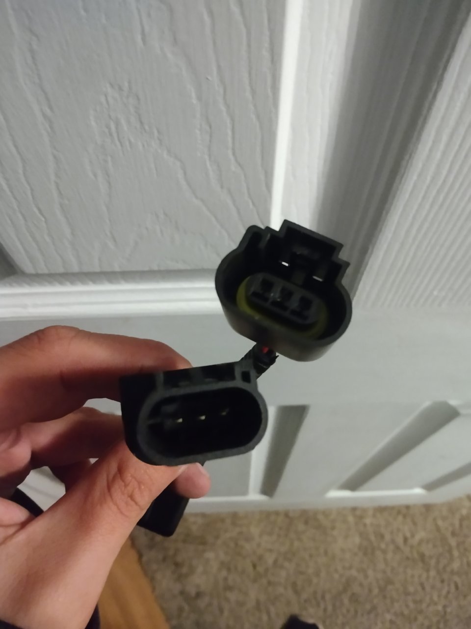

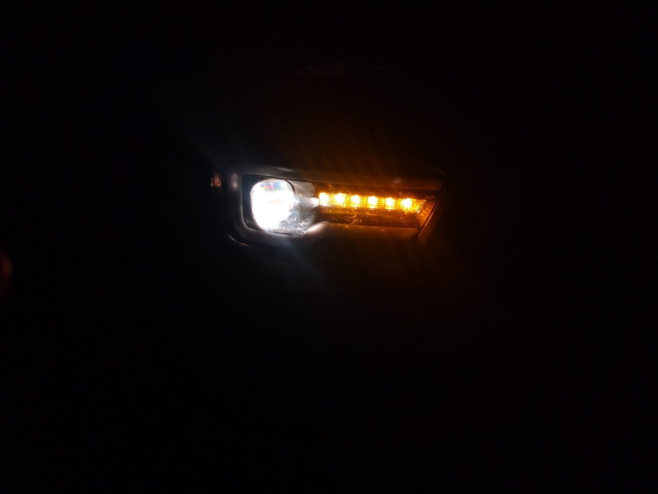

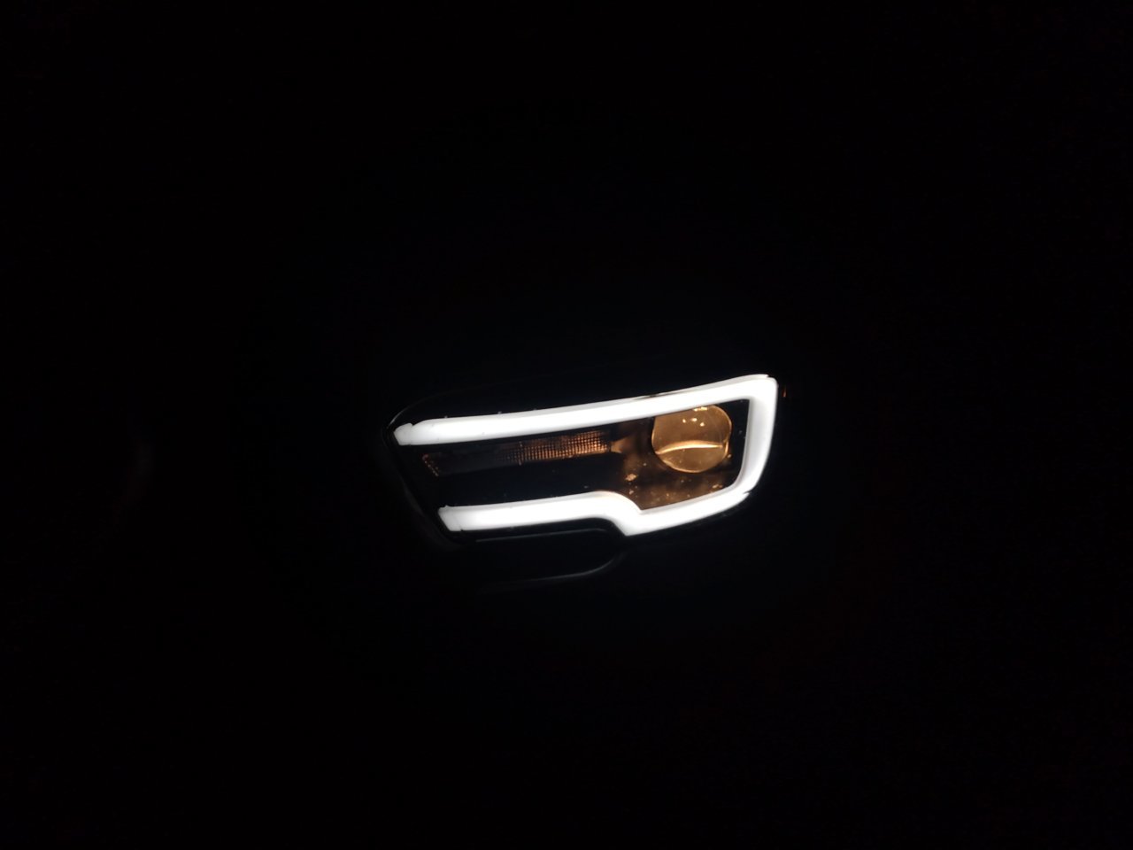

    Does anyone know how to fix this.. I changed my headlights out now one side will light up the led strip the other the yellow.if I switch them around the same thing happens so I know it's not the strip. When I turn the turn signal on the one with the with the white led on will blink the yellow strip for the turn signal and the one with the yellow strip on will blink the white light for the turn signal...i bought bulb resistors for it but got the wrong ones they are for the high and low beams two prong plug..i thought I found the right ones and bought h13 plug Bulbs Resistor still Wong plug..they do have the three prong that's why I thought they were the right one..I have a 2017 access cab tacoma...also my drl lights don't turn on I checked my fuses and change them out...i did see some one mentioned a smaller fuse box in the engine bay I can't locate that one...any help would be much appreciated..IMG_20210921_201238636.jpg IMG_20210921_201222261.jpg

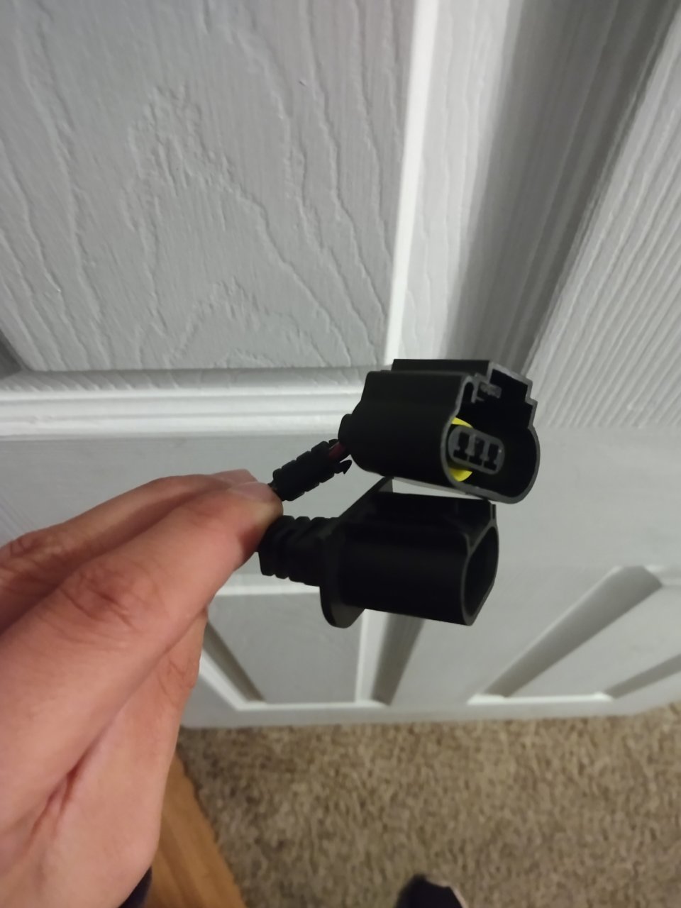

    That's the plug and the resistor I got..
    IMG_20210921_202916627.jpg IMG_20210921_203057487.jpg IMG_20210921_203101068.jpg IMG_20210921_202943300.jpg

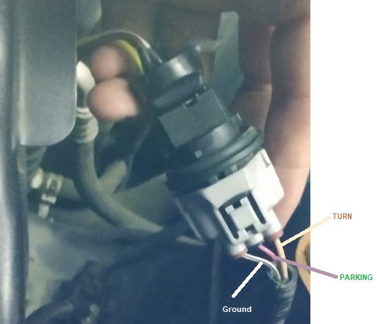

    Hood Struts, My version Fogs always ON, Map & Overhead Light Mod,
    Verify that the circuits on the headlamp match the pigtail circuit.

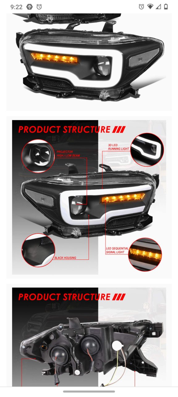

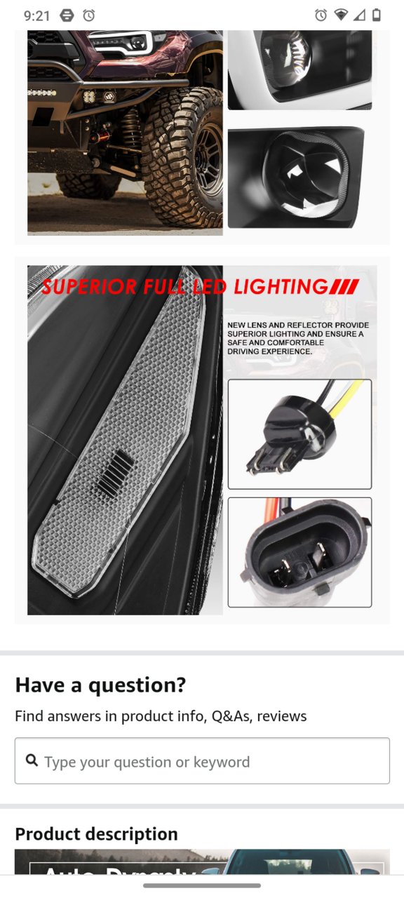

    What headlights are they? Are they made for the SR?

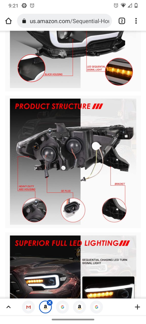

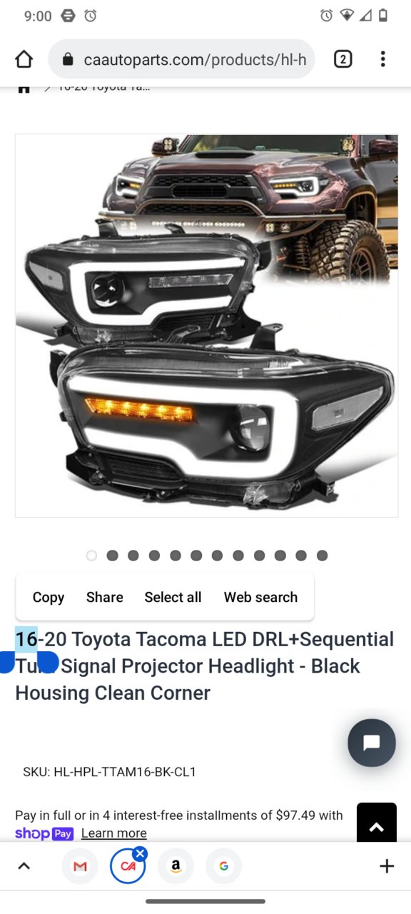

  13. Sep 21, 2021 at 9:02 PM
    #33
    Jtc9
    Jtc9 Well-Known Member
    Nov 25, 2019
    #311698
    64
    That's were I think I messed up i was hoping I could do something to the system if they weren't..
    Screenshot_20210921-210045.jpg 16-20 Toyota Tacoma LED DRL+Sequential Turn Signal Projector Headlight - Black Housing Clean Corner

    2019 Black SR

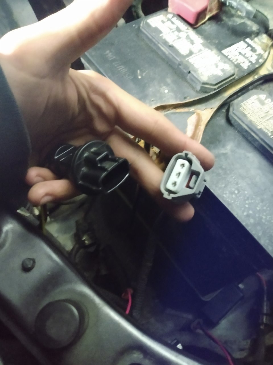

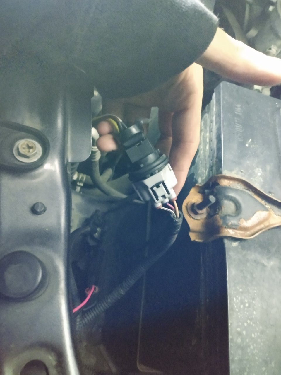

    The White surround is DRL, the amber is the turn signal I assume? The easiest inexpensive way to do it will be to turn off the DRL if you can via the headunit settings, and run the DRL wire to the Fuse box to come on anytime the truck is on. Do you have a picture of the connectors on the headlight? I can make a conversion harness to go from SR to TRD fittings as well if you want it to still function with the stalk switch.

    Ya the white is the DRL and the ambers the turn signal. And yes please if you can make something that would be awesome.

    I can make something, and do at times. They aren't cheap though. I am selling them for $175 for the one you'd need. They are plug and play though, and require no splicing or anything. If you'd still be interested, let me know and I will add you to the list :)
