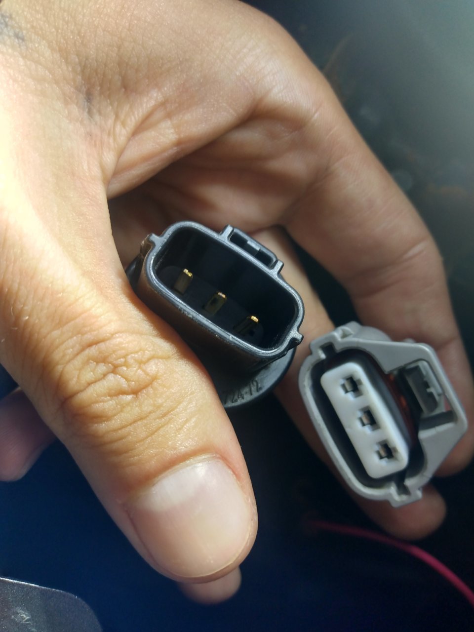

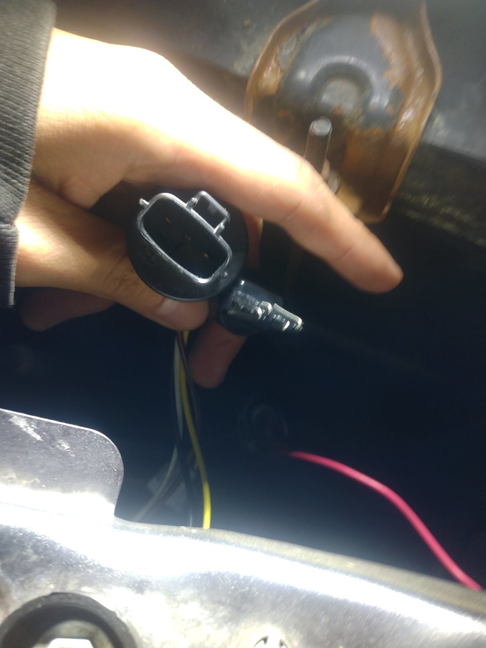

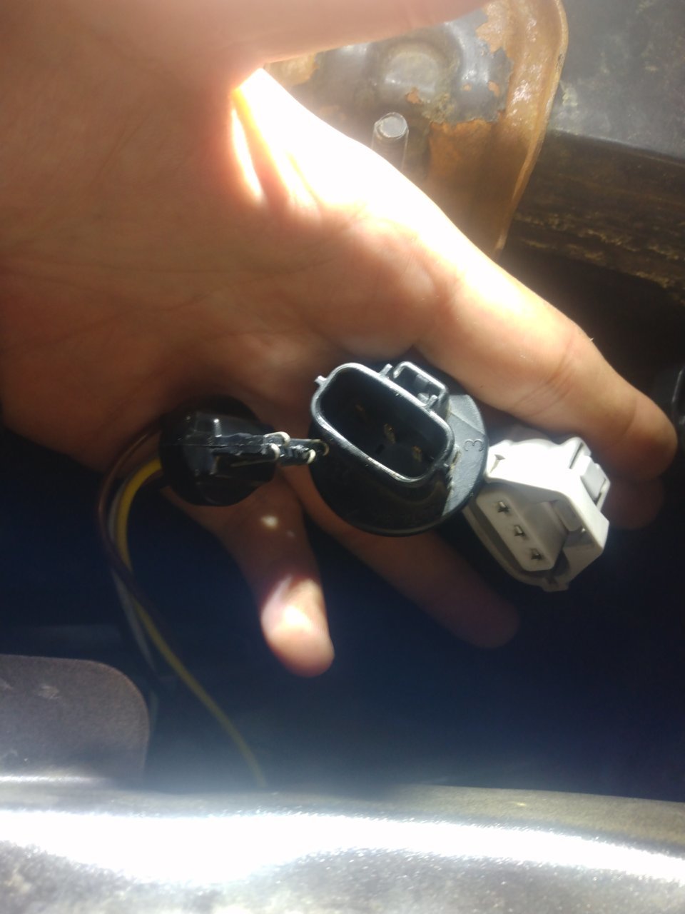

    Is this the connector coming from the headlight? The one on the left? That looks like it was made for the SR.

    OK, looking at the pictures there, I think these are made for the SR. I am wondering if it is a 7443CK base? Do you have a link to them on Amazon?

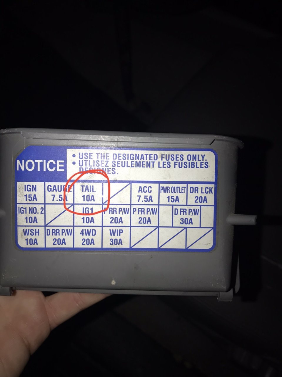

    I have a 05 Tacoma trd off-road and if anyone is still wondering the DRLs and tail light have the same fuse(see picture). This is the smaller fuse box located under the steering column.
