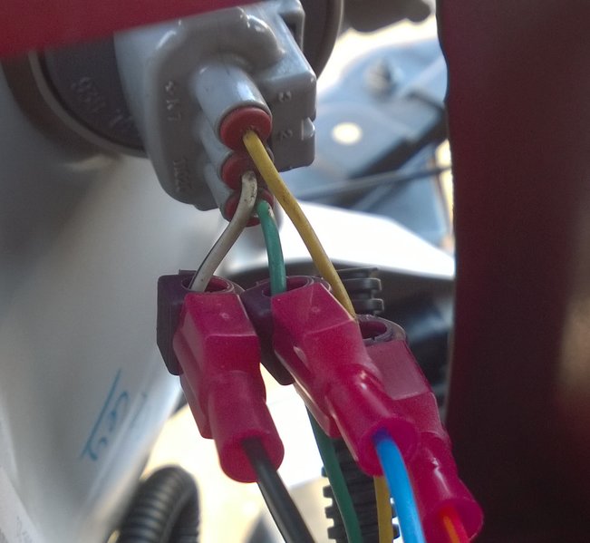

  10. Dec 7, 2015 at 7:12 AM
    #30
    Hennessy
    Hennessy Well-Known Member
    Oct 20, 2013
    #114857
    396
    Charlotte NC
    13 Red DC TRD Sport
    Demello Baja bumper, Mcneil Fiberglass, Fabtech Uniball Upper Control Arms, Emu Dakar leaf springs, Fox 2.5 Factory Series Coil-over IFP, Fox 2.0 Performance Series IFP
    great that you got it worked out that "truck running" got me too, for others here are some pictures of the splices I made. WP_20151207_012.jpg WP_20151207_013.jpg
  11. Dec 7, 2015 at 8:26 AM
    #31
    Annolino122
    Annolino122 [OP] Well-Known Member
    Oct 19, 2012
    #89332
    820
    Evansville
    2014 Tacoma TRD off road
    Those look nice, if they had amber I would probably get a set
