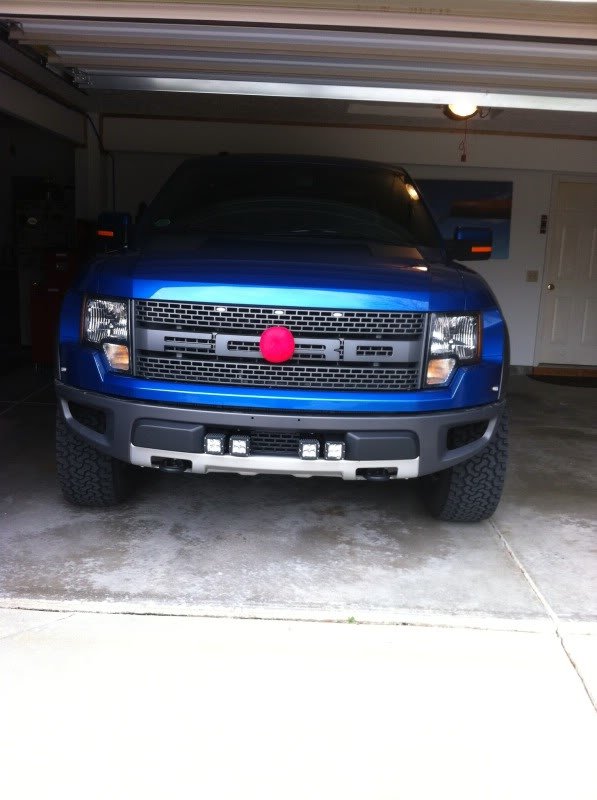

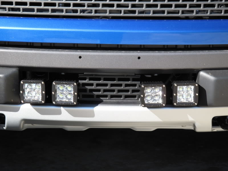

    I never use mine.
    I installed LED for DTRL on my Raptor (which didn't have DTRL) and never had an issue, so I just ordered some for Tacoma as well.
