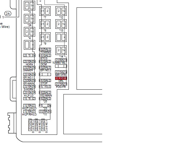

    If your OR does not have LED then this:
