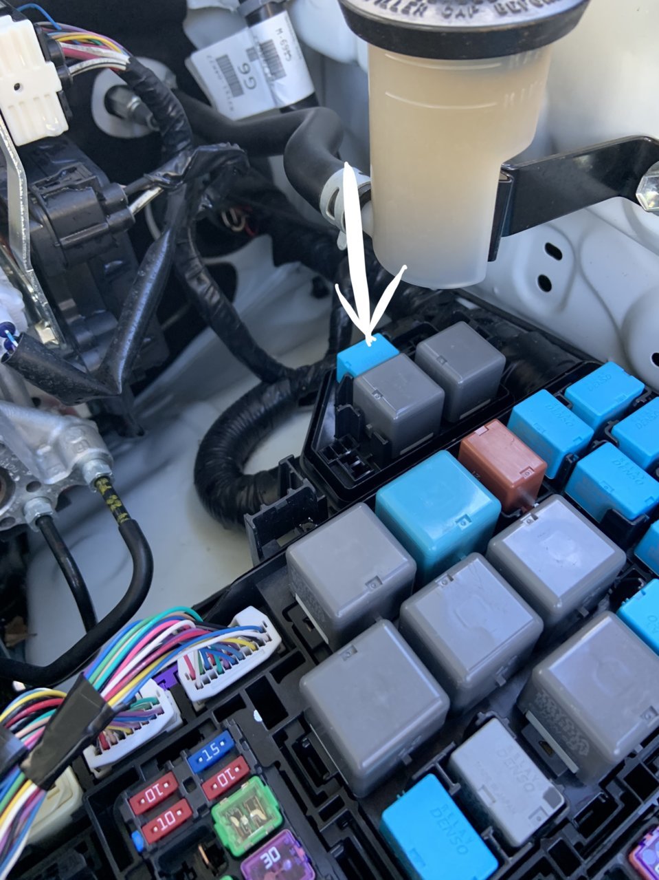

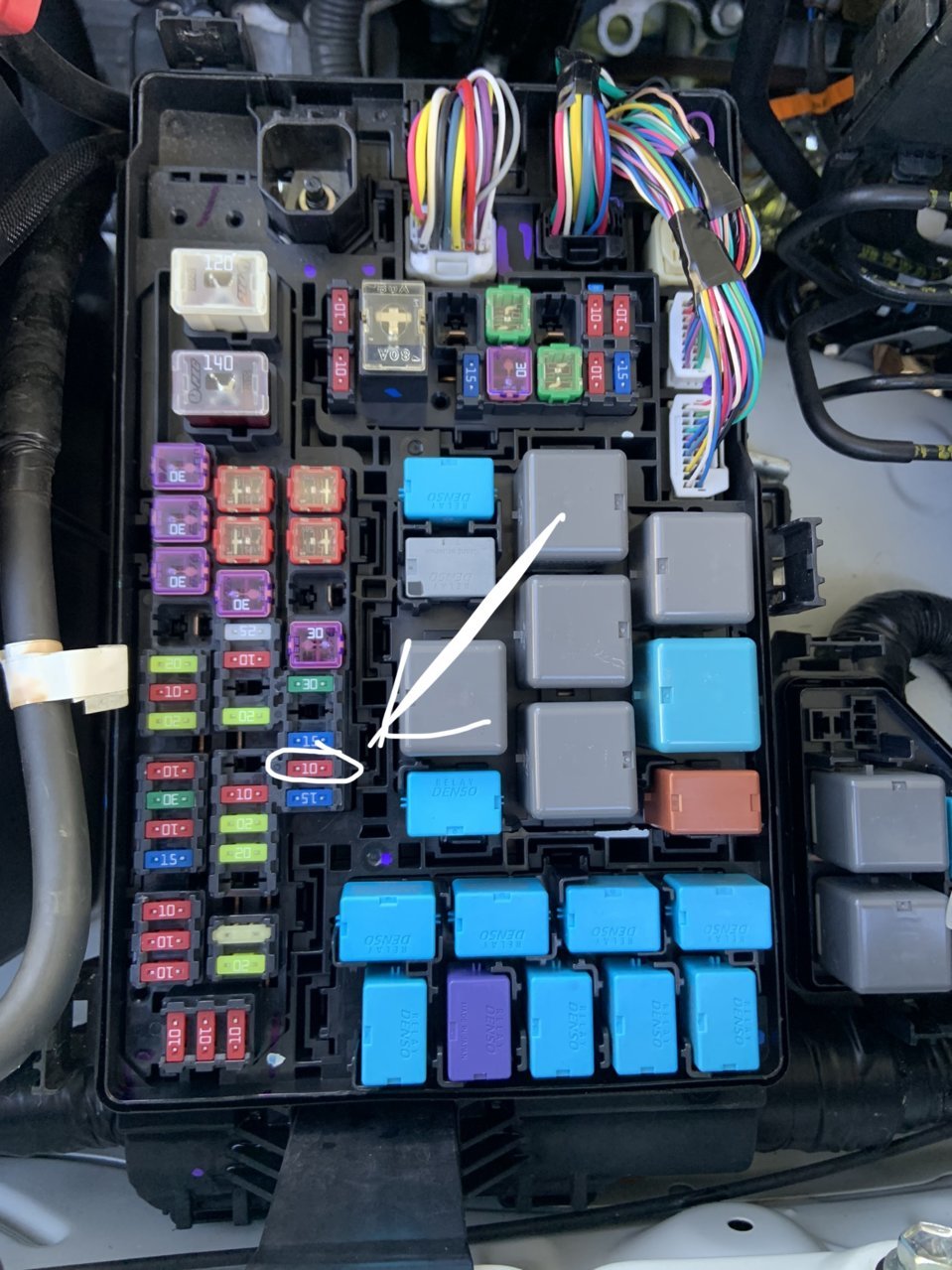

    A56C2E24-6D82-4080-B48A-45970673477F.jpg 8B8C2D95-863A-4BCD-BFF2-FDFFA5C01CD8.jpg
    Another case here.
    Zero mods on my truck.
    LED strip works on headlight on (dimmed)
    LED strip would NOT work on DLR switch position and handbrake off and/or driving.
    swapped horn and Dlr relay and horn worked so relay works but it won’t make any sound or actually work when plugged on dlr plug.
    10 amps fuse for DLR is perfect.
    Any help is greatly appreciated!

    Just for shits n giggles, swap the fuse for the replacement in the fuse cover and test again.
  10. Jul 16, 2021 at 6:15 PM
    #30
    Claudiomartinof
    Claudiomartinof Well-Known Member
    Apr 18, 2016
    #184668
    1,466
    2019 TRD OFF ROAD 6MT
    did it… nothing changed…

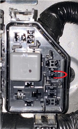

    Jumper wire from slot 5 & 3, (relay removed) and again, verify.

  13. Jul 17, 2021 at 9:04 AM
    #33
    Claudiomartinof
    Apr 18, 2016
    #184668
    1,466
    I jumped the relay as you suggested and it worked.
    Now, what should I do now? What would be the problem?
    thanks again!

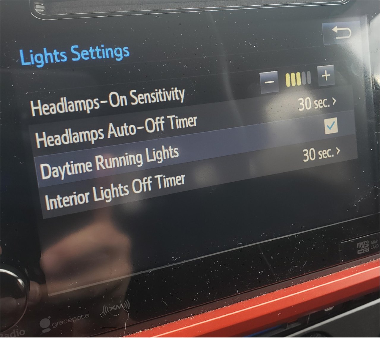

    Since you already tested the relay on the horn circuit, it leads to the actuation side (Negatively actuated). Unfortunately that is controlled by the Main Body ECU. A cut wire towards the cab, or the circuit no longer works.
    Find the menu on the Head Unit, see if the setting is set to off.

    So I lied… I do have only one Mod on my car and it is the head unit…. I bough a joying headunit (android based) that has Apple car play (my truck is 2019) and this mod that I did not shared with you. (Completely forgot) is relevant to the situation because the head unit under car info section, it lets turn on and off the DLRs but in my case for some reason I press the button and nothing happens… so thank you very much for your help and now I will move into the joying head unit thread to see if sometían help me over there.

    Sorry, I posted in a different thread and got mixed up, but you answered it anyway. And I fixed it. Somehow the cabin touch control panel settings for the lights must've been reset because that's all it was. Forgot that was even a setting, but I saw it on another thread. Thanks!
