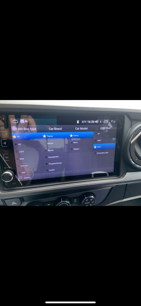

    Claudiomartinof
    Claudiomartinof Well-Known Member
    Apr 18, 2016
    #184668
    1,466
    2019 TRD OFF ROAD 6MT
    Make sure you have your hu set up like this. Do not remember how to get to this screen but drl will work if these are chosen.
