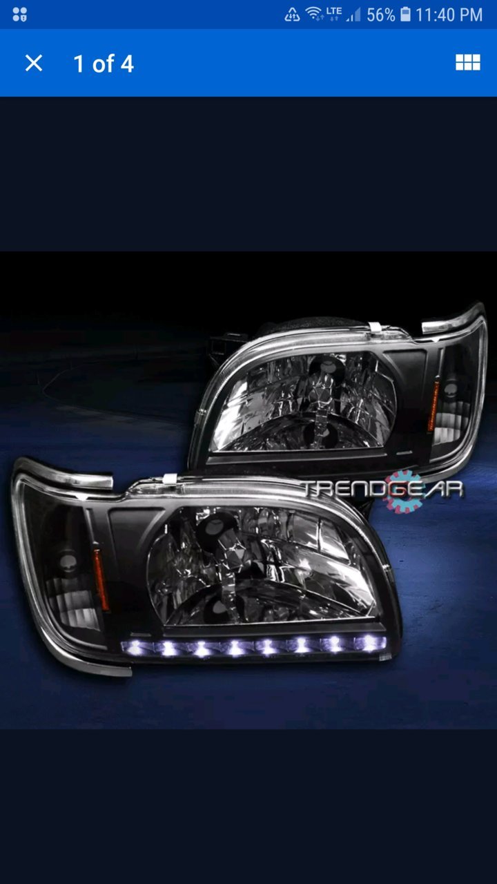

    So I had to replace my headlights on my 2003 Tacoma Prerunner v6. I bought a pair off the good ole eBay that came with side markers built into the headlight plus DRLs. The issue is how should I go about writing the DRLs up? Has anyone done this to their 1st gen?
    Thank you and please reply with helpful information.

    DRLs did not come on Tacomas in 03. These aftermarket headlights I bought came with some and they have 2 wires (black & red) sticking out of headlights.
    I just don't know where to wire them. I was thinking of having a switch in the cab to work them.
    How hard is it to hook them up to the parking lights?
    Also I'm concerned anout the leds on the DRL will overheat. My buddy had that issue and melted the headlight. So I need to wire them up where there's not a lot of voltage.

    My take is that these are just accent light, not true DRL. True DRL LED is about 7-10W per lamp (about 900lm per light), these are probably close to 1-2W. You can wire it to ACC (for constant ON when engine is running), side marker (ON when the light switch in is tail position). For true DRL functionality they would require kind of controller that would turn them ON when engine is running (or key in and ACC position) and turn them off when the light switch is in Tail position (for night driving). But with these accent lights, you can run them day and night, nobody would care (besides you of course).
