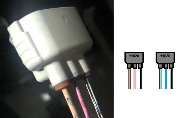

    I need some advice on a headlight swap. I have a Base SR 2017 Tacoma without the Daytime running lights, but I installed a pair with DRL those any ones know how to rewire them to make them
    Work ??????

    Passenger's side: Beige = TURN/DRL; Pink = Parking; White with Black stripe = Ground.
    Driver's side: Baby Blue = TURN/DRL; Blue = Parking; White with Black stripe = Ground.

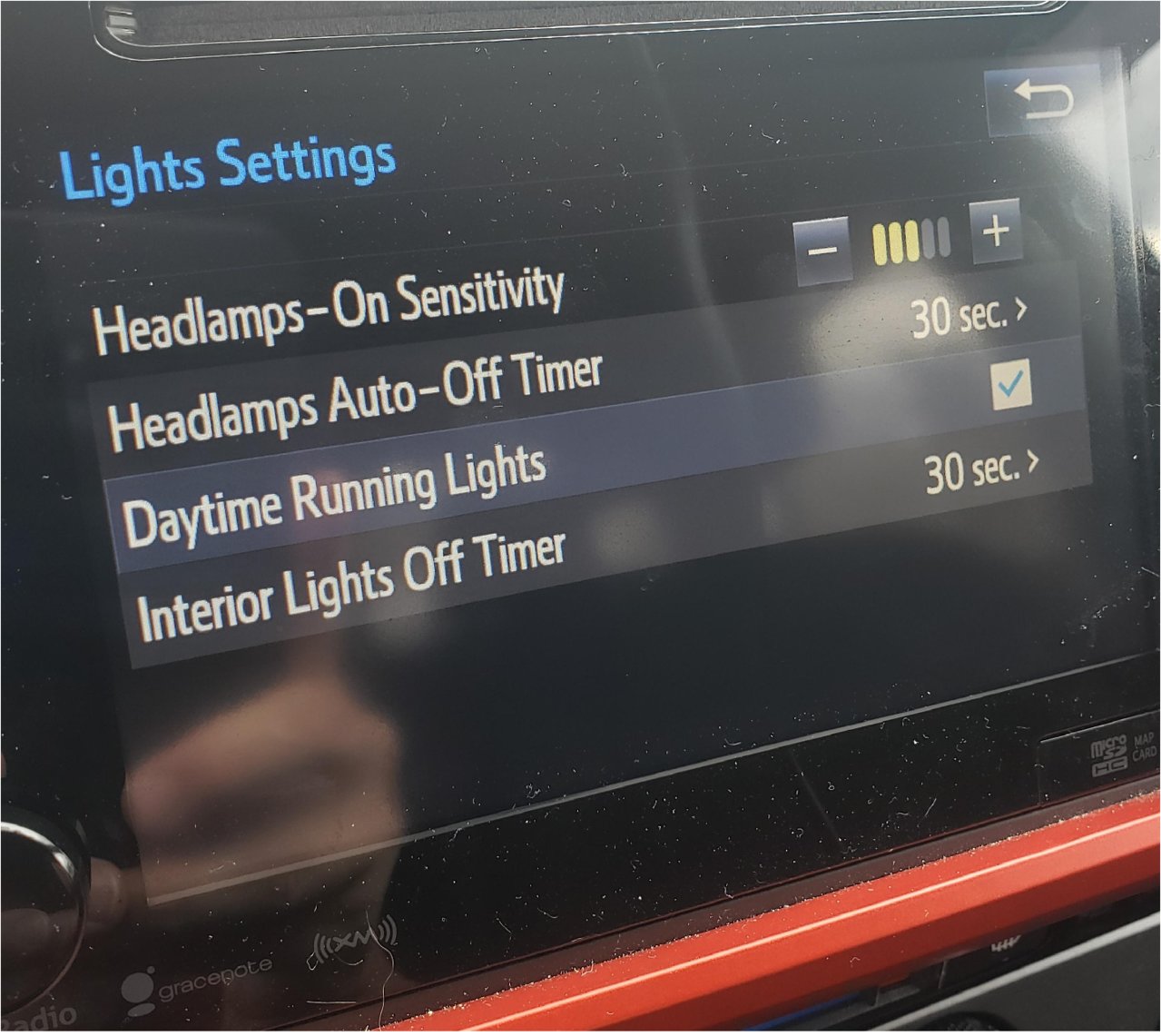

    Could be that it's OFF in the Head Unit.
