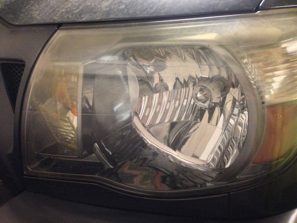

    I'd like to bring this question back up. Will they inspect my headlights or just give me new ones?

    They inspect and take your old headlights

    So they will most likely deny mine since they have been taken apart for the BHLM, correct?

    Not sure.. would be worth the shot

    Find out if they don't then you could buy eBay lights crack them open switch turn lens and take those in...Oo but thats unethical lol

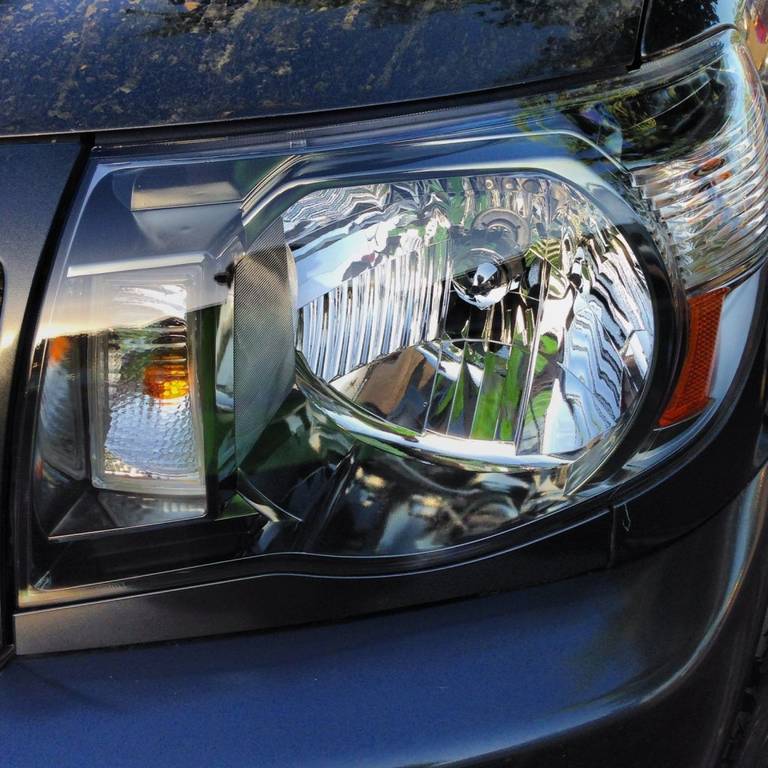

    How long did this take? Per light?
    I like the way this looks! But for hire long I estimate this taking about 2 hrs per light.man idk.
