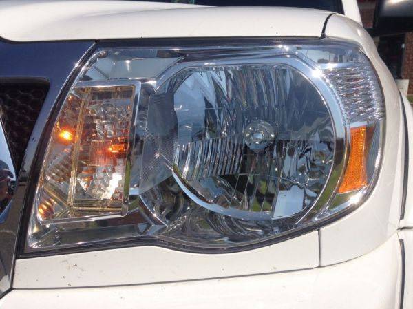

    Ah thank you.
    The lens insert is different. It looks glass.

    They did, didn't even notice that in the pictures.
