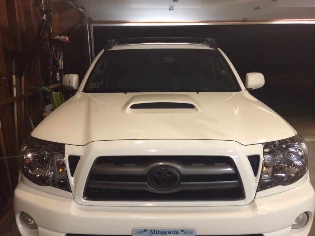

    took my 09 in last night brought the extended warranty paperwork. The service guy jumped to the "secondary coverage line" initially, but I pointed out the no mileage limitation under the "primary coverage" and he went right ahead and ordered the lights for me. They said about 3 days to get the parts
    in.
    Update: got the lights installed today. The new inner lens is glass to prevent heat damage.

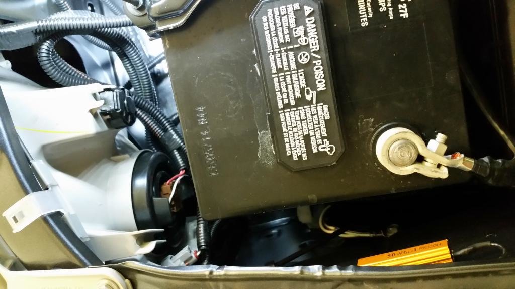

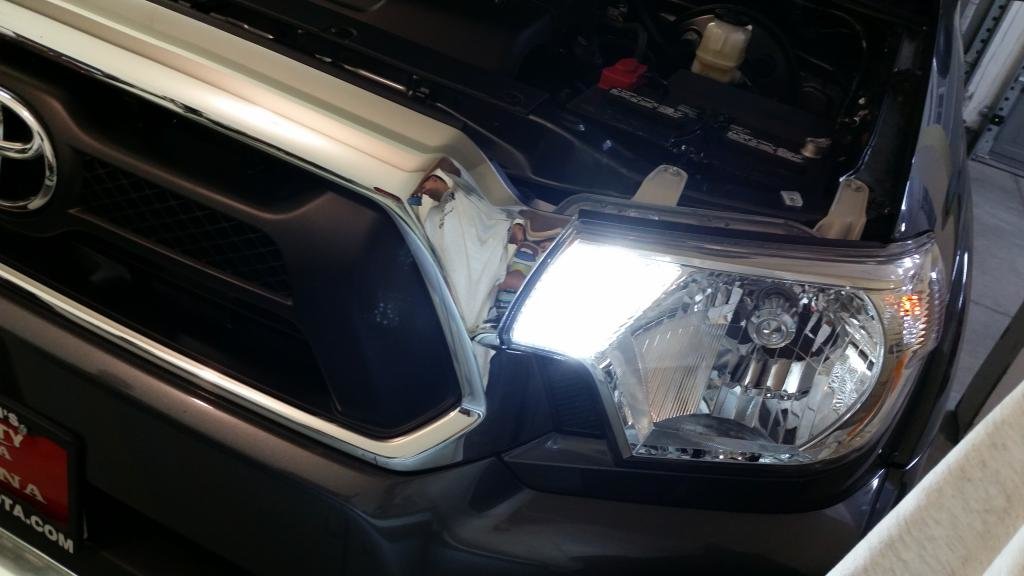

    I think LED is brighter and works just fine as a DRL. I got the white/amber switchback type, it's white as a DRL and changes to an amber turn signal.
    Here's what it looks like:
    And here's the location of the load resistor: (bronze color, next to the battery)
    If the resistor is made of aluminum and mounted to metal, the heat dissipation will be adequate. The mistake is buying those cheap ceramic resistors and taping them to the wiring.
    Bonus: your headlights will no longer have the "fried egg" look where the DRLs are. :)
