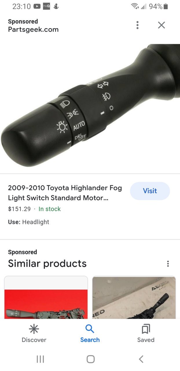

    What is considered “marker position”?

  11. Sep 27, 2023 at 11:12 PM
    #31
    Vlady
    Vlady Well-Known Member
    Dec 20, 2017
    #238986
    4,433
    Issy, WA
    2017 White SR5 DCSB V6 4x4
    One above Auto in attached example.
