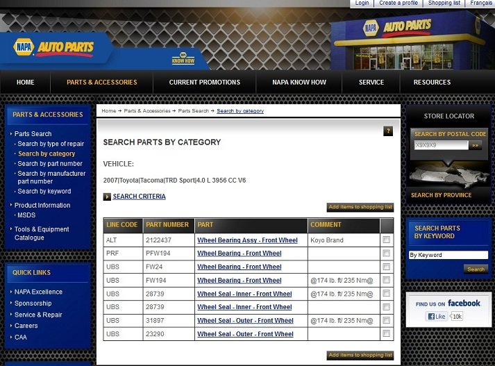

    I will try that. I can't seem to find that p/n posted earlier on napa canada. Will have to continue searching for now.
    These are the ones I found, but different p/n and no price? Sorry link did not work. Here is a screenshot.

    Dealership says 5 hours of work @ $130/h, Midas for instance 6 hours of work @ 120/h.
    I found all parts at a dealer in states for $310 + $41 shipping willing to even ship USPS. Dealership parts cost is $650.
    For labor so far, I haven't found anybody for under 5 hours.
    For aftermarker, SKS aparently has two bearings available.
    - premium one, p/n: PFW194 for $189.25 @ NAPA
    - economy one, p/n: FW194 for $122.49 @ NAPA
    Midas sells the cheaper FW194 for $257.39 :eek:
