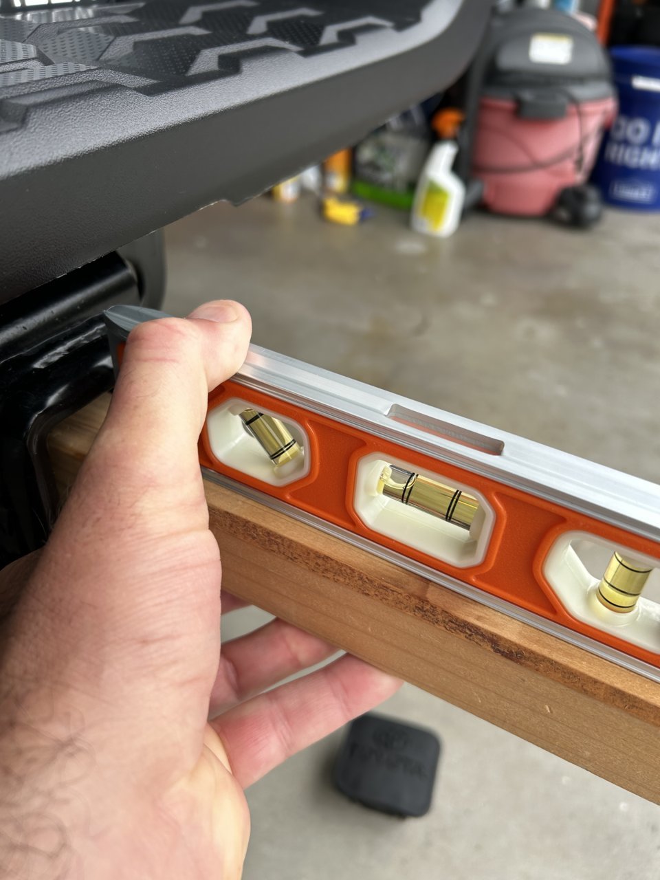

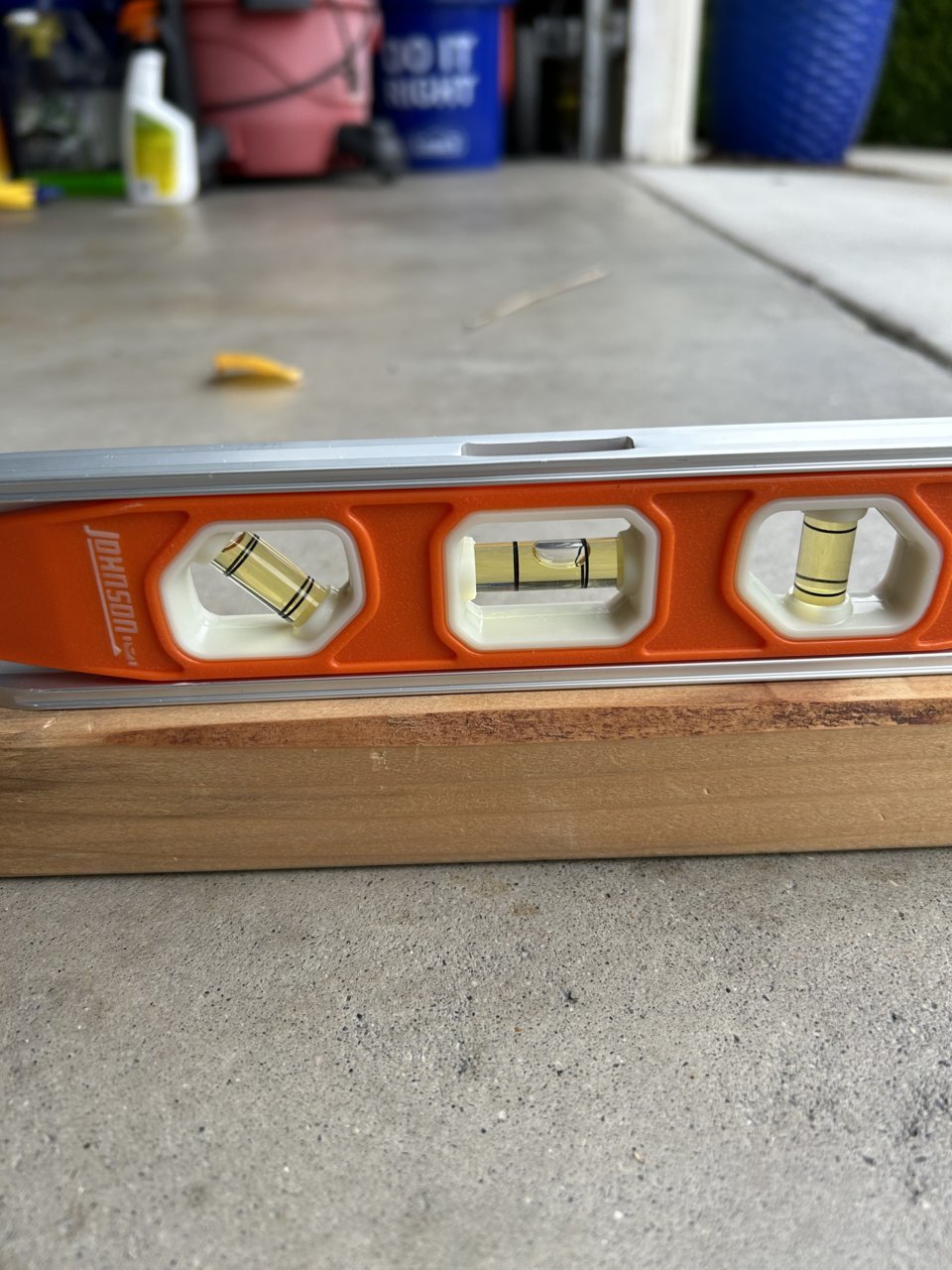

    So a hadn’t attached anything to my hitch until today and in true fashion to my beloved truck something is miss aligned… I think. Is the hitch supposed to tilt down? Roughly about a 1/4 inch or a little less? I added a picture of the floor level and a 1 by 1 with a level on it inserted in the hitch. As always any help is appreciated. :thumbsup:IMG_3493.jpgIMG_3496.jpg

    Lol. Just to show the level, i knew what I was setting myself up for with this post :rofl:

    In all seriousness, its fine. If you think about it, any amount of weight in the bed (assuming someone has a perfectly leveled receiver) is going to experience some sort of sag, potentially even more than 1/4" when weight is added to the bed; just sit on the tailgate and watch the level. The hitch is also going to have some extent of play in it (unless you have one of those fancy hitch pins that takes up the slack), and its only going to sag/equalize more when you put tongue weight on it. If it makes you sleep better, give it a good kick test and make sure its not loose.

    Considering that the next bit of geometry in the system is an articulating ball, the exact levelness of the receiver isn't critical. As long as all hardware is properly sized, rated to the task, and there's no damage, send it.

    Dude your hitch is a loose fit into receiver so when you put tongue weight on it it will drop.
    It makes zero difference in the greater scheme of life.
