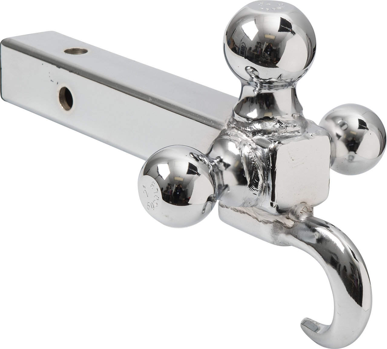

    I got the 2ish" drop hitch that came with my Taco, but also bought this puppy from Princess Auto. 3 common ball sizes and Captain Hook!
    I don't have a lift, and this setup is only good for temporary pulls as it isn't a drop hitch!
