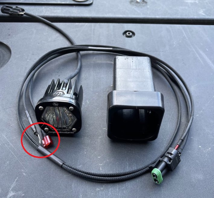

    He wouldn't?o_O
    This is what I'd like to view installed:

    That was a customer that made his own wire connection. I am not offering any PnP at this time, I will leave it up to the customer how they want to wire it. (reverse, brake, switch pro,spod, etc)

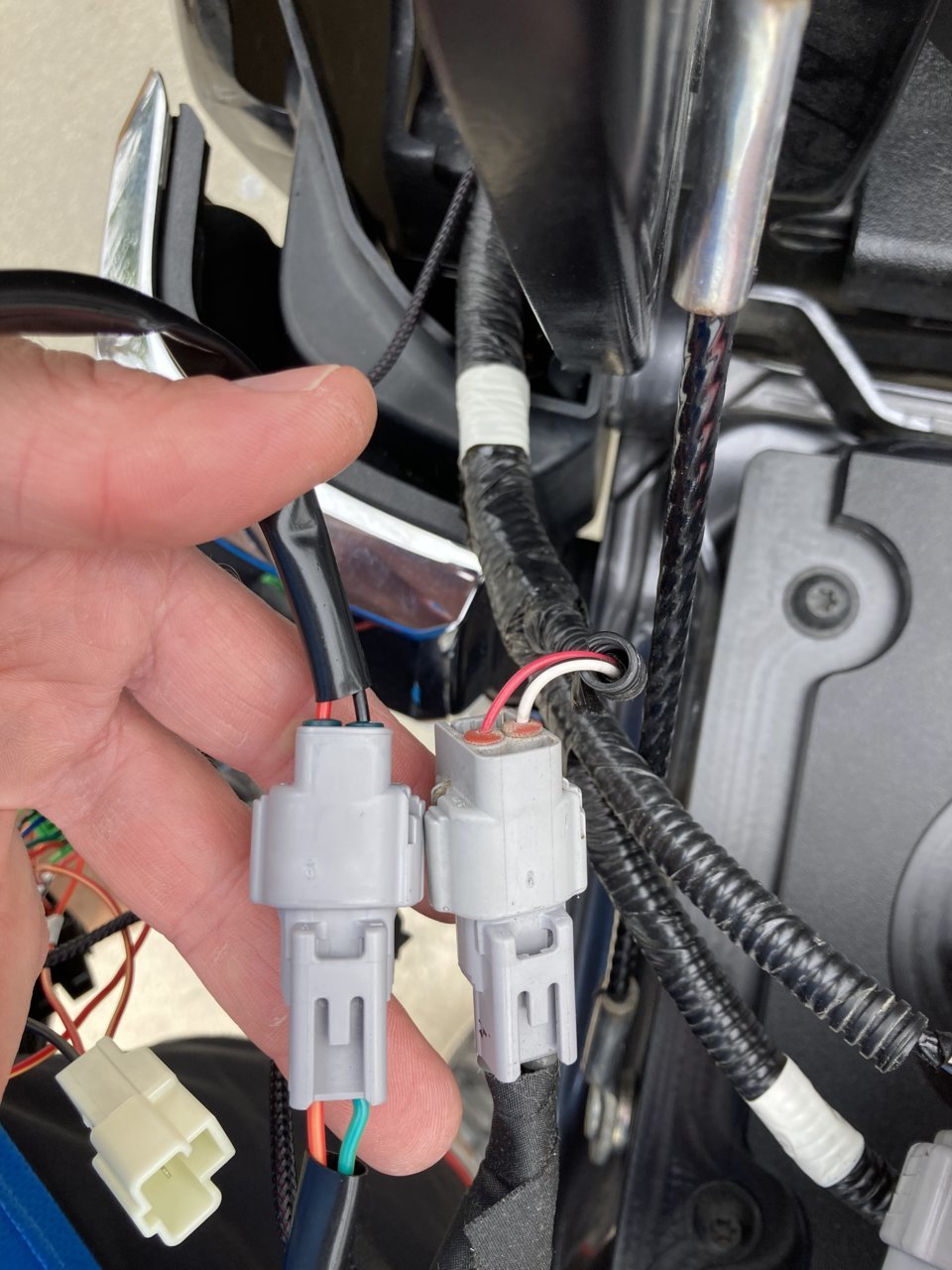

    Oh, hey, sorry, I goofed with that last post because it wasn’t meant for this thread. But now that I think about it, the photo could be of value to anyone contemplating DIY. Though taillight removal is trivial but just in case it adds value. This is the reverse connector. White w black should be ground and red is power. Harness provides female and the original halogen bulb is a male as is the feed into total tail. Just in case someone gets value from having this documented. Right side is OEM to total tail, left side is my test harness for license plate light DIR (hence the goof on original post)
    Oh, and this is 3rd gen Tacoma, 2nd is different and I don’t know about T4R or Tundra.

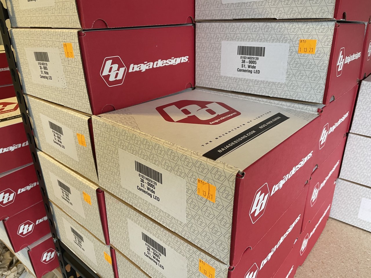

    S1s are showing up... :cool:
