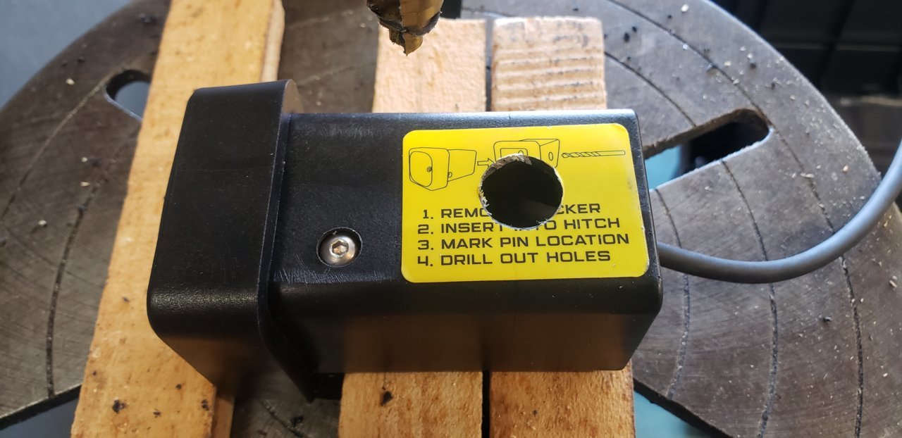

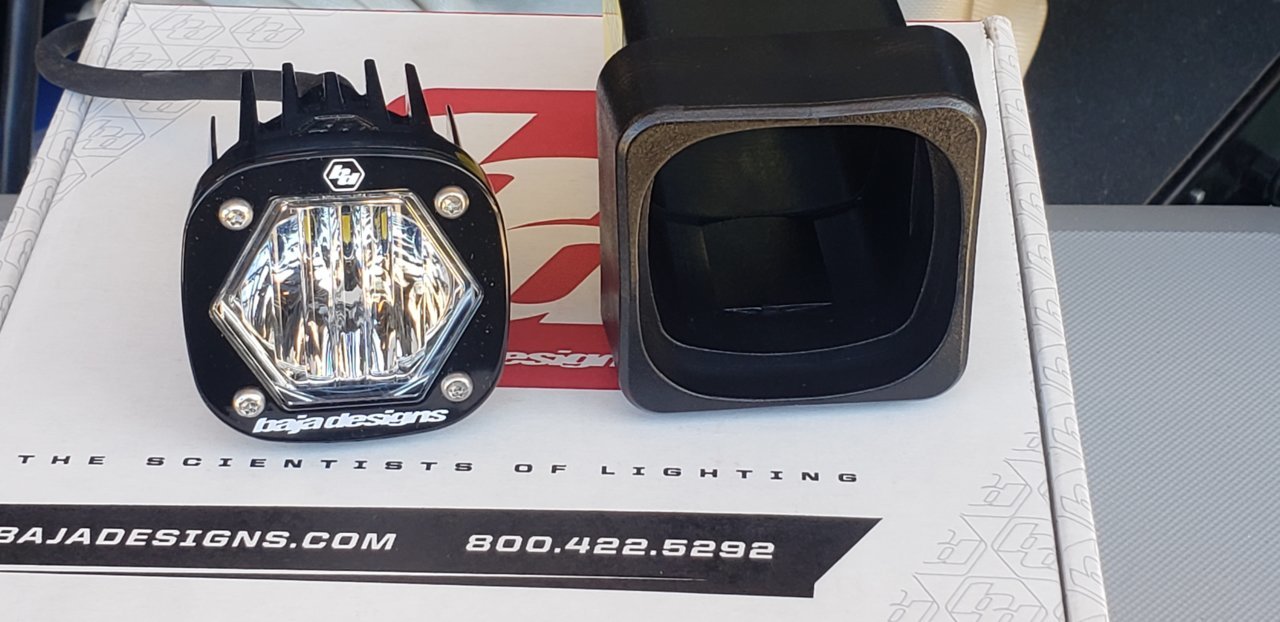

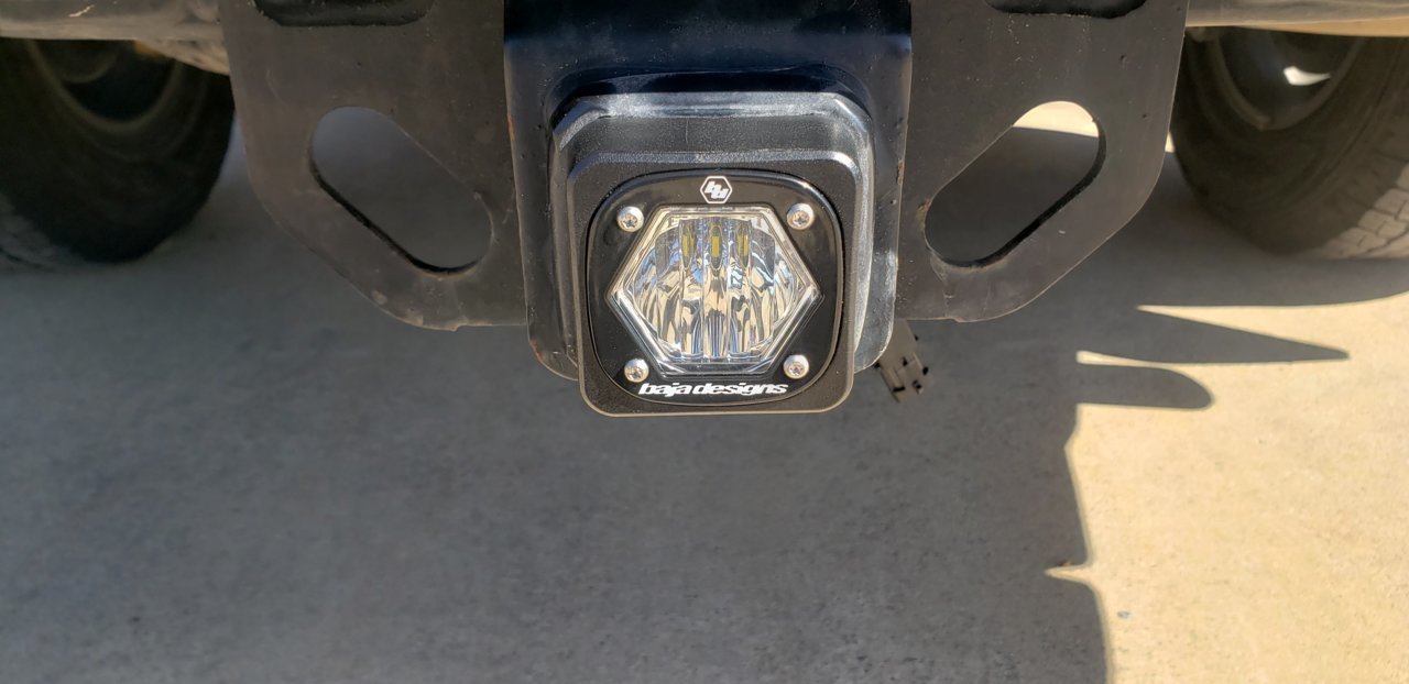

    Look what arrived, now that the roads cleared up..
    Simple and quick to put together. but as you can See not real good at following directions.. I left the sticker on, to use as a marking surface for
    the Black marker, since I was able to find a Silver Sharpie
    Drill slow... The drill press was a bit fast, and it created a bit more of a burr on the inside than I would have liked to see. however, it only took a short time to clean up the and deburr the inside of the hole
    Now to get the Harness and get this working... and a locking pin to keep those who "need it more than me" from being tempted.

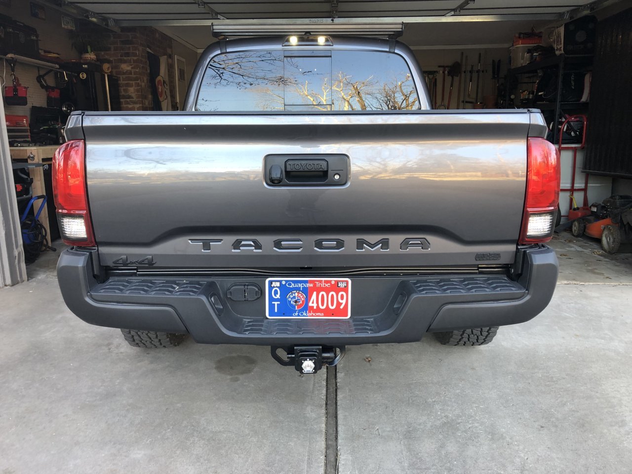

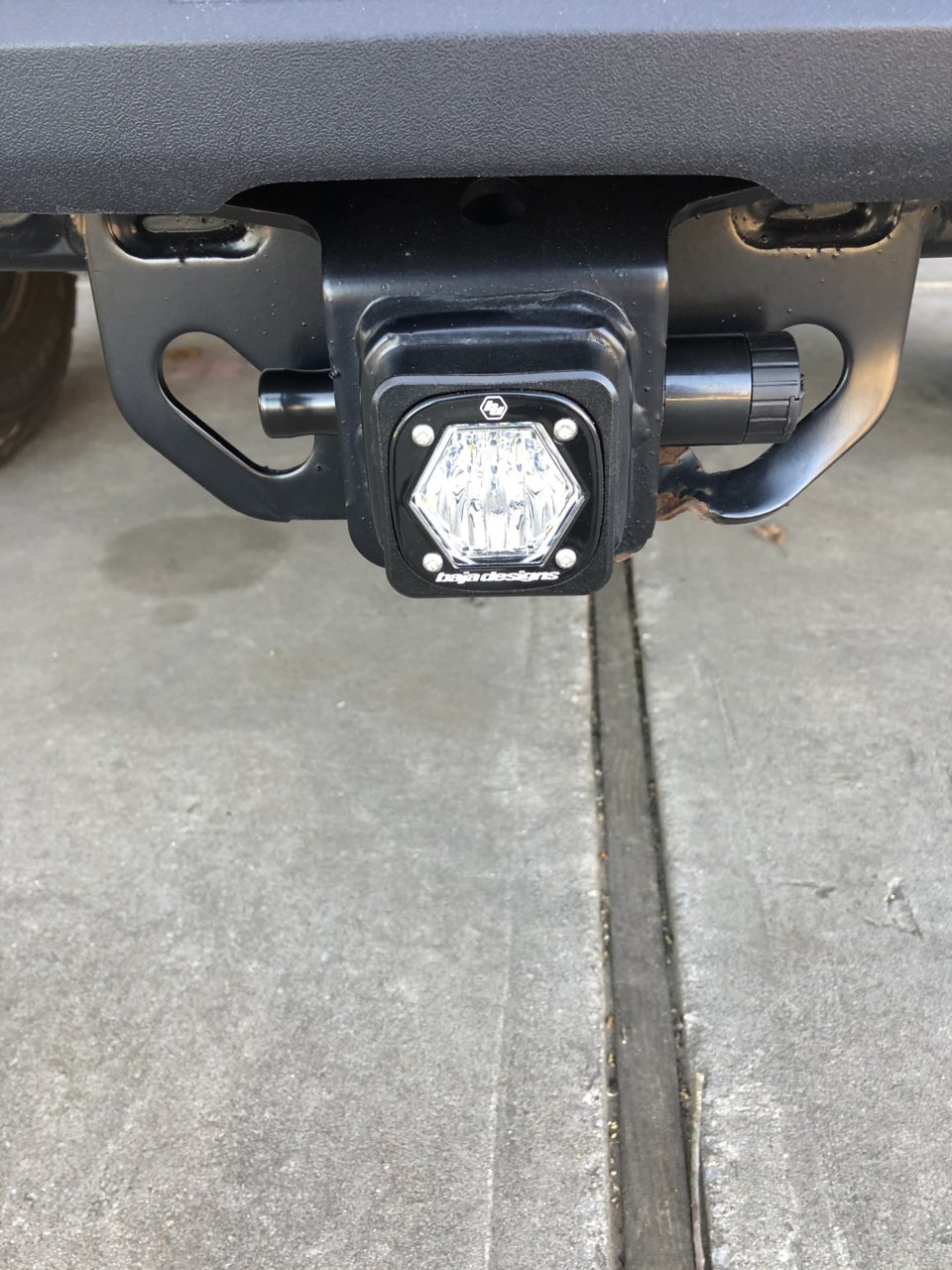

    Very nice. Which hitch pin is that?

    No problem. If you get this one it’s a 5/8 bit and pretty snug but it’ll fit. Hard to tell in my pic but the length could not be more perfect
