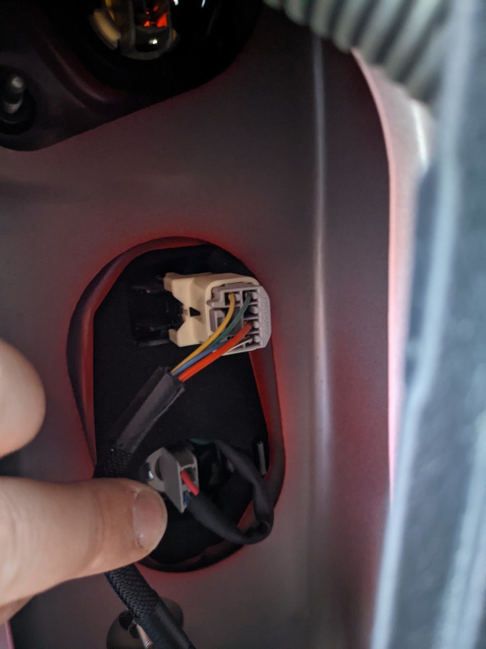

    I’m expecting a de-pin, possibly extend, feed through a grommet with liquid electrical tape as a sealer, and splice/tap accordingly

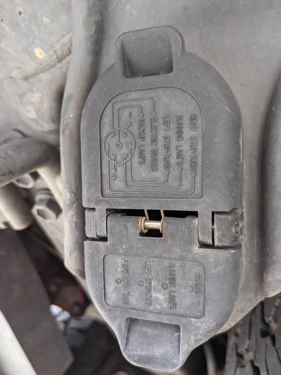

    Any reason you're opposed to using the trailer plug?
  6. Mar 8, 2021 at 8:24 AM
    #506
    memario1214
    memario1214 Hotshot Offroad Moderator Vendor
    Oct 1, 2009
    #23628
    20,192
    Colton
    Missoula, MT
    SOLD - 05 Dub Cab TRD Sport 4x4, CURRENT - '21 Tundra MGM Limited
    I've got one. It's just a bulky look is all. It's nice for testing though since I don't have to roll around on the ground.

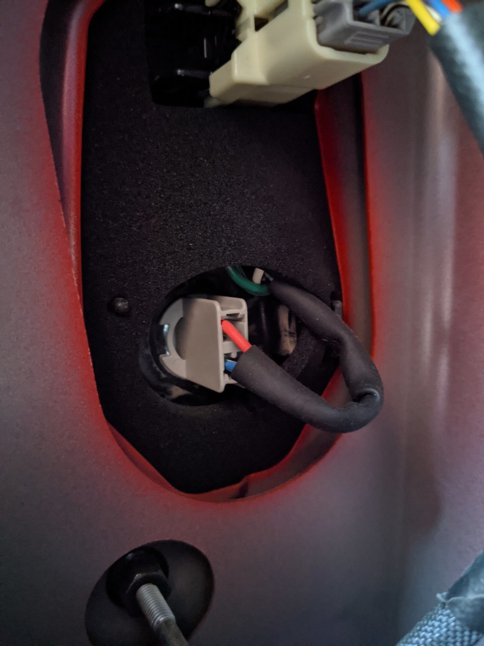

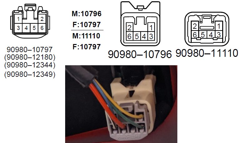

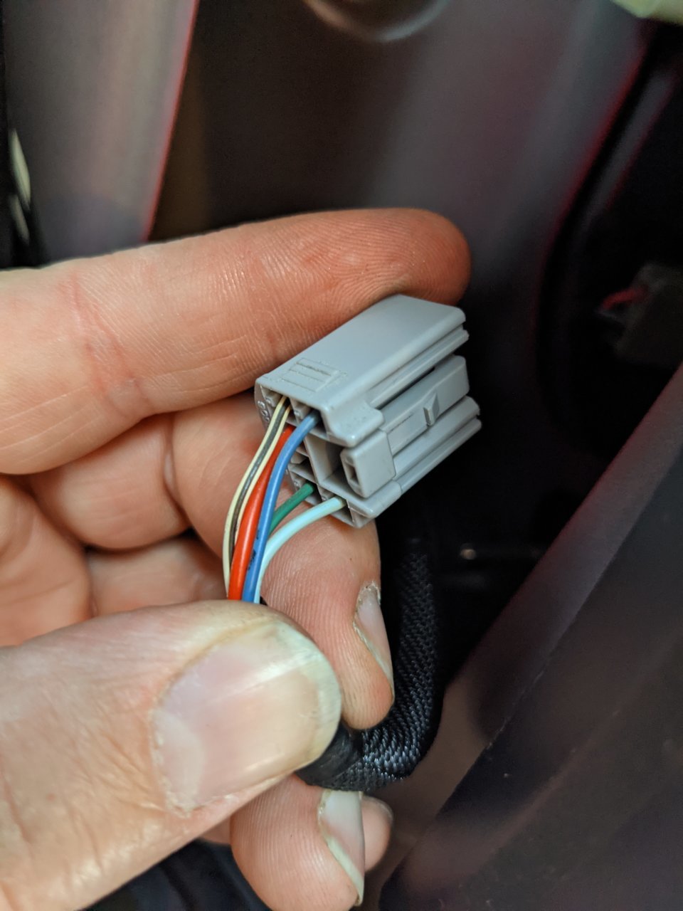

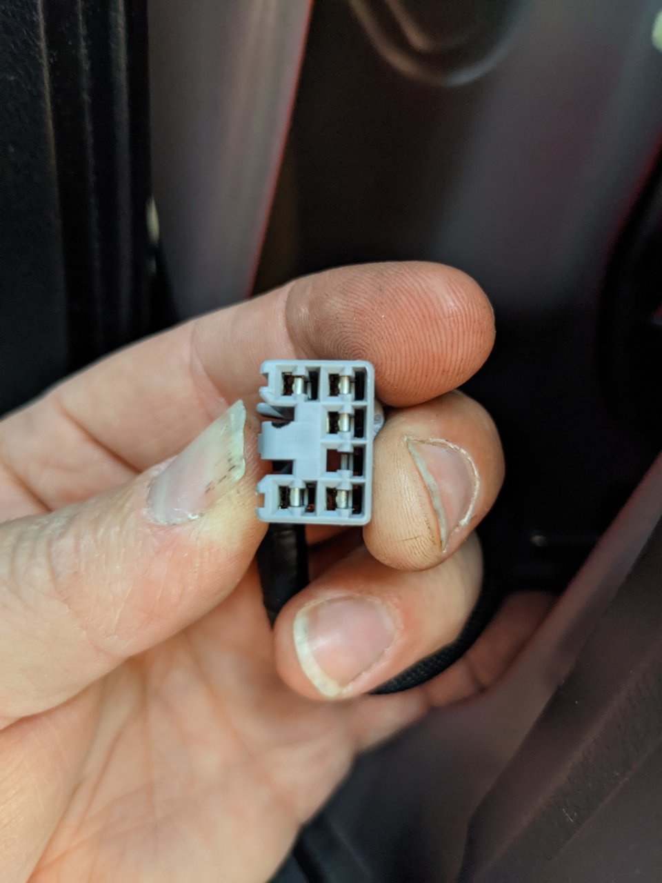

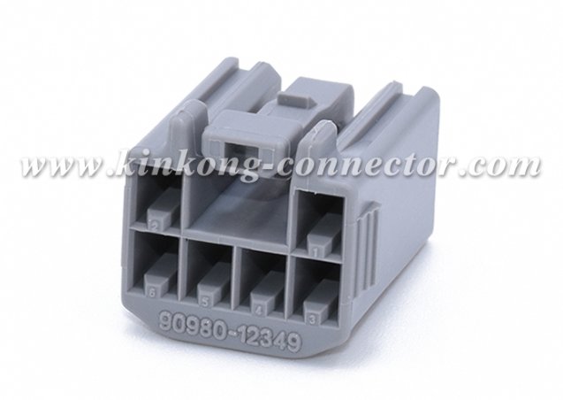

    Looks like the 090II unsealed 6 pin (same as the head unit rear speakers). I am not sure I'm reading that part number correctly but looks like 90980-12349.

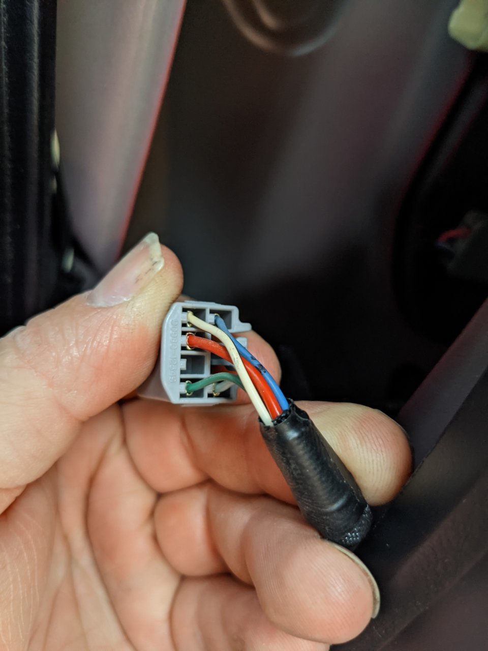

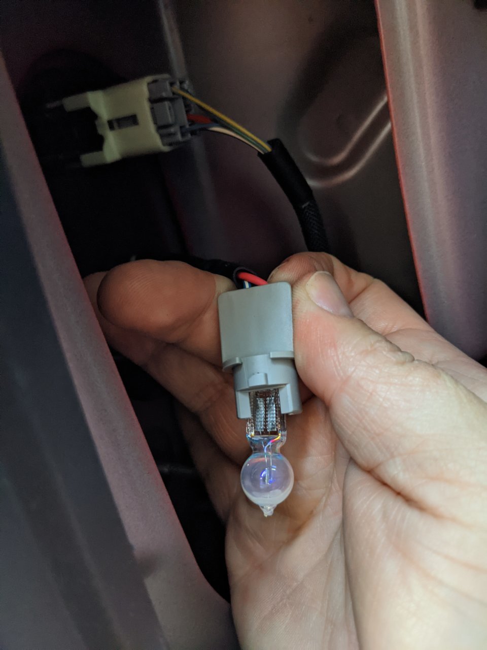

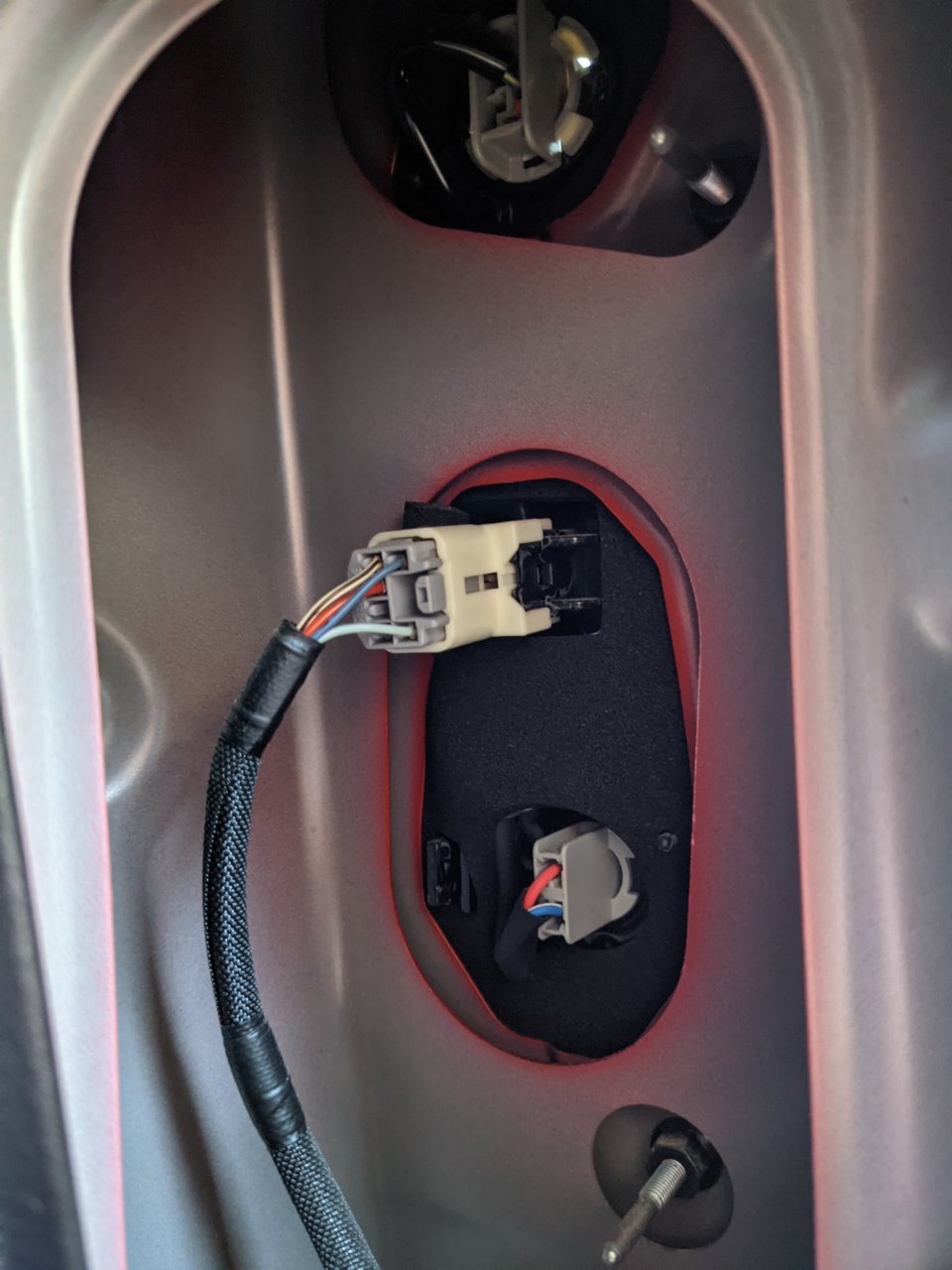

    Yes that is the part number, you can see it in full resolution. Keep in mind that it's for the turn/tail/brake lights. The reverse light bulb is the smaller 2-pin plug at the bottom.

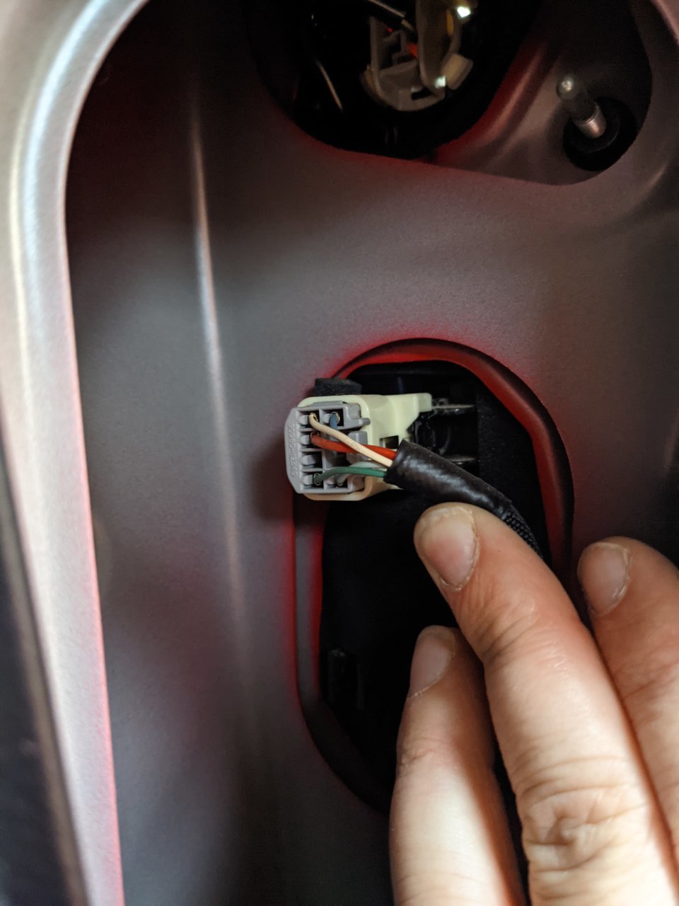

    In your 4Runner, where does the red wire (BU) hide into, the taillight assembly or the harness?

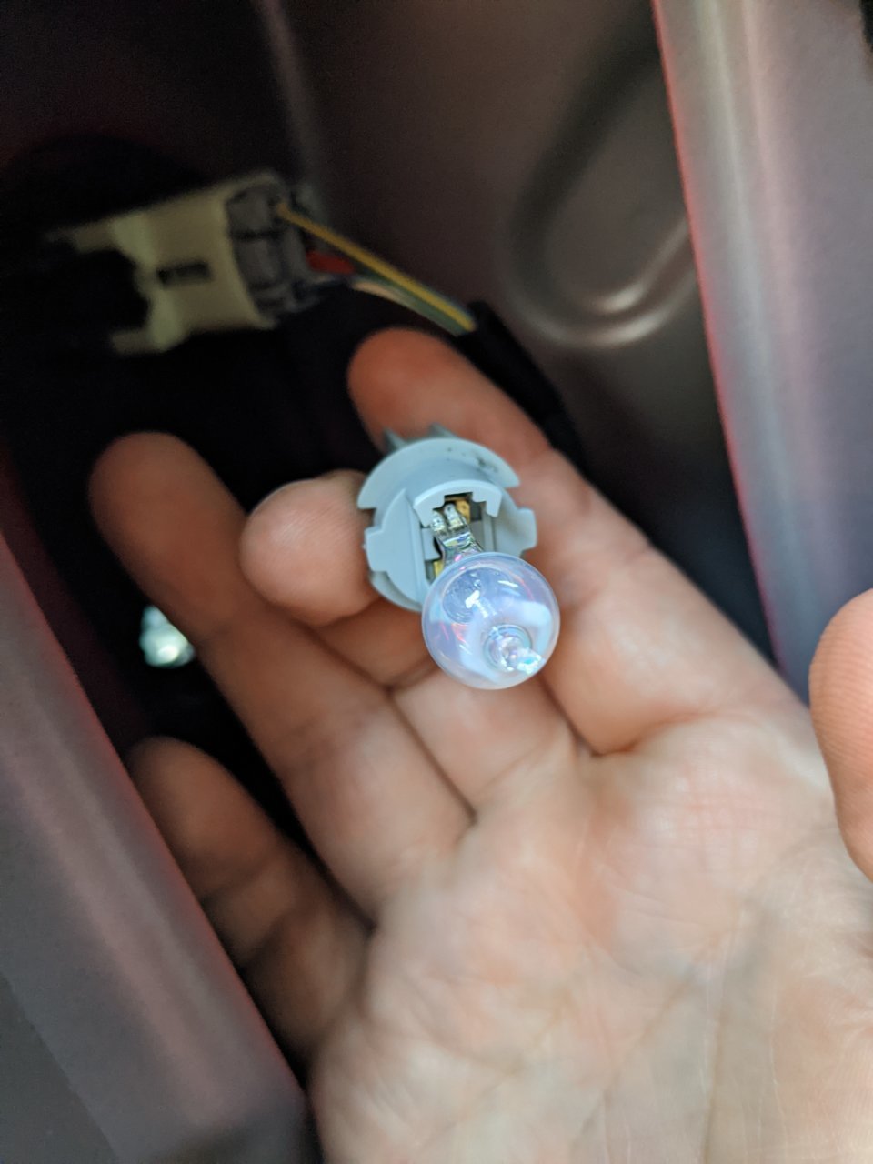

    Yeah the bulb looks like standard T10 socket. Per Caribe’s posts above I think the easy plan would T off the 6 pin to steal ground and reverse.

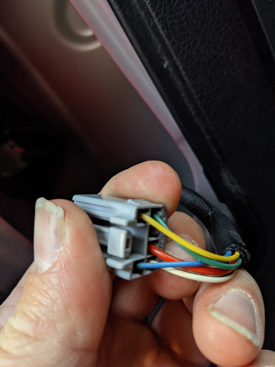

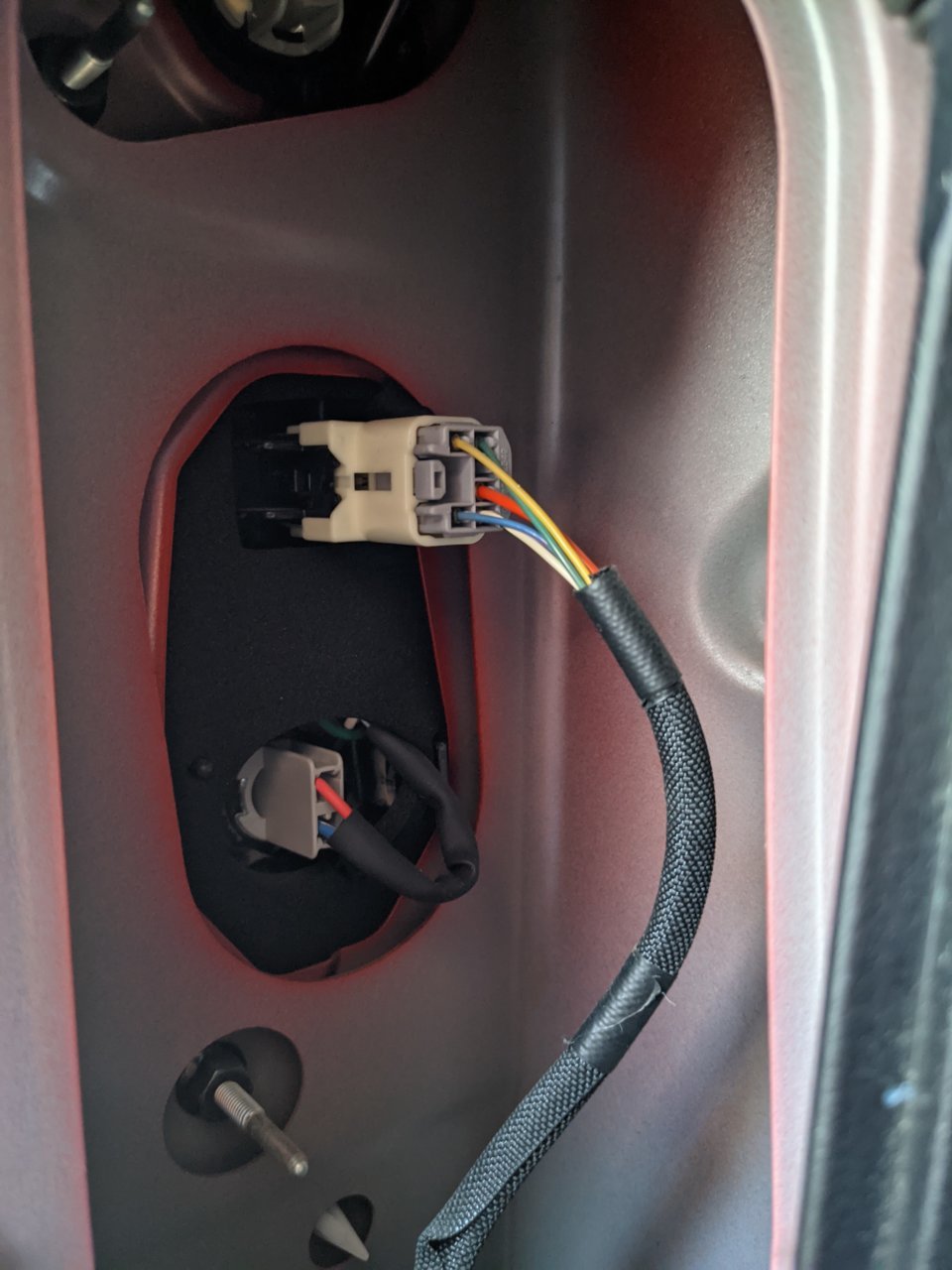

    I'll need to look again but you might be right. It may daisy-chain off of the 6-pin plug rather than run out its own lead.

    There are more than one type of rear lamp assemblies for 4runner...
    Meter it with transmission in reverse.
