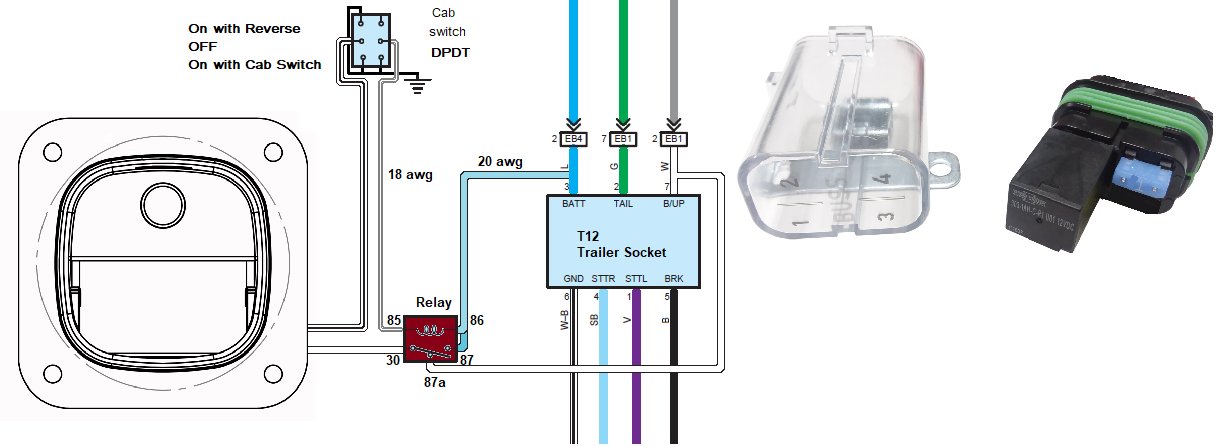

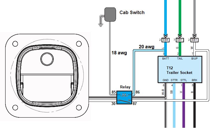

    I think we want to know from this photo (credit @mynameistory) how do we get to the hitch (outside the vehicle) with the shortest path, least disruption to the vehicle interior, minimal install time, and maximum waterproofing.

    The least intrusive method would be to craft a harness that incorporates power from the Transmission's reverse signal. I'm heavily contemplating a puncture in a floor grommet to feed into the cabin or just running a full length setup to the switchpro 9100 I have set up in the engine bay. Nonetheless the pigtail on the light will most likely get cut off for a DT plug.

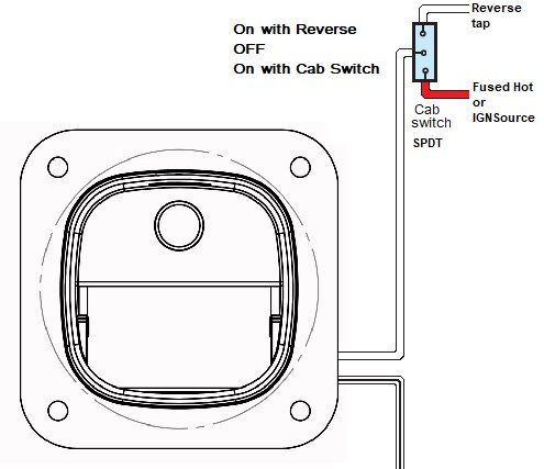

    Still want some way to enable when not in reverse right?
    kinda need the rocker for this to go auto or manual control.

    It was to caribe as I figured you’d go direct off Switch-Pros and just turn it on yourself if you want it on while in or out of reverse. At least that’s how I read it.
    I think he was solving for a disable switch in cab but didn’t also solve for the enable when not in reverse which is cool for stuff where you’re parked.
    If I get one for myself I’ll likely tie direct to Switch-Pros as well. Don’t think I’d want it on when in reverse most of the time.
