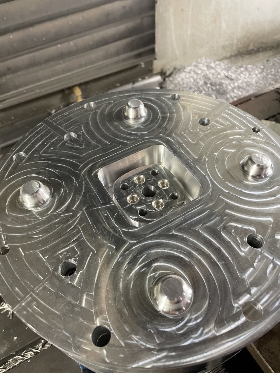

    Some final tweaks to the mold. Final fitment and testing should be over the next week here
    Working on plug-and-play options as well! They won’t be here at launch though :(
    Probably a month or so later

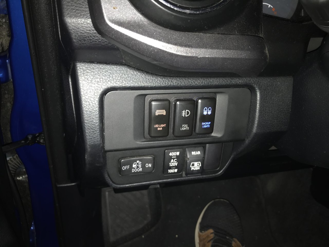

    Work in progress...
    Th
    These work great for that too!

    Almost there. Molds are finished and I got the first sample out. There’s a few minor adjustments, as well as dialing in the surface finish, but overall I’m stoked.
    The holes will be predrilled for the light mounting bolts, however I am going to leave it up to the end user to drill the through pin hole.
    Reason why; after testing multiple vehicles, they ALL had different pin depths. For a standard trailer hitch that doesn’t matter. But this had to shoulder off the back and sit perfect with no movement. So the best way is for the end user to drop it in, push it flush then just mark the 2 holes on each side. Pull it out and drill the 2 holes. That way it’s 100% with no play.
