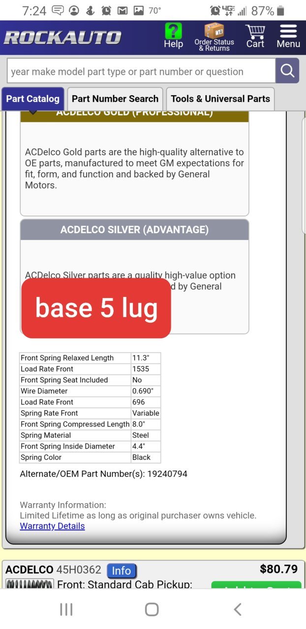

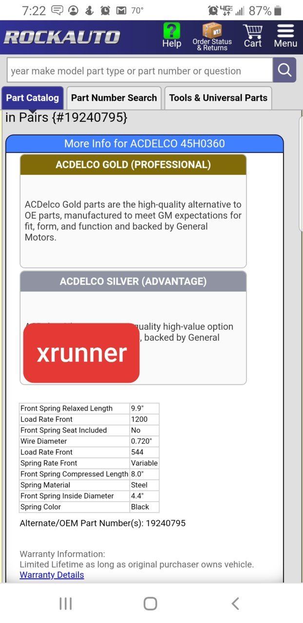

    Been looking to do the same thing this is what I have found everything seems to bolt up fine. 20200923_081324.jpg 20200923_081301.jpg

    To answer your question as cheap as possible without doing things like cut springs ect. I am running 17x7 and will keep them until I can get some 17×8.5. I am looking to drop ~2". 1.5" to 1.75" will be great. The tires I'll be running will be 225/55/17 on the 7" rims, once I get the 8.5" I'll run some 255 or so. I've looked for the SOS drop springs and cant seem to find an active link. I've also looked into the Xii performance drop coils, the company still exists but everything about their drop kits is gone. I also sent xii a email about it. Any help would be appreciated I'm sure not just by me either.
