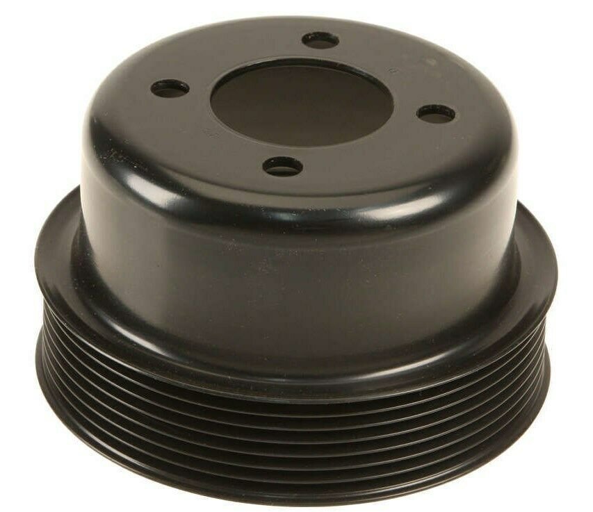

    While changing out my VTT solonoids to fix a CEL/limp issue (which seems to have solve the problem) I went and did an oopsie.
    I dropped the bolt that holds one of those solonoids in- and it fell down. I THOUGHT it dropped into the well between the left and right heads, and looking in there I see what looks like an abandoned mouse nest... but no bolt.
    So I said screw it and found a usable bolt from my bolt bins and moved on with my day.
    Wrapping up the job and putting it back together, I spotted the sucker- it was on top of the belt, with the threads behind the fan clutch pulley!
    But human hands can't reach down there, so I started with a magnet on a stick, to no avail... moved on to all manner of tools.
    A half hour later, I have it between my fingers, going... going.... ah damn it slipped.
    But it didn't fall out and under the truck, no- it fell INSIDE the BACK of the FAN CLUTCH PULLY.
    Test drive went fine, and I couldn't even hear it- I figured it fell out.
    But no. Stopped to fill the tank and when I started her back up I immediately hear that bolt dancing around inside there.
    Drove it home- over 2k RPM it sticks to the side and the noise goes away... stop at a light and rattaa-atttaaatattaat-ta-t-taaat-aaa horrible sound
    My worry of course is that it's going to bind up and break something back there, or the pully itself.
    Only thing I can think to do is PULL the pully off, which is not a job I want to do this close to winter.
    So I guess I'm looking for input- can it be safely ignored until it either falls out on its own or I can get it out next year, or is this a serious problem that needs to be addressed immediately?
    What clown made these pulleys solid on one face... what a pain in the bum.

    The fan and pulley are only held on by 4 nuts.
    Loosen the nuts and remove fan. Then remove the belt from the fan pulley.
    Take out the “dropped bolt”:rofl:
    And then bolt the fan and pulley back on.
    If you really care, you can torque the 4 nuts to 16 ft/lb.
    But that’s too much trouble, and I am not fishing a torque wrench down in there. :eek:

    Those four bolts will take the stupid thing apart?
    Brilliant! I assumed those would just ruin my day more so I avoided touching them until posting here.
    I can do that in the AM, then.

    I own a few of them- and the grabby things with the little arms.
    neither is getting behind this pulley-
    I don't think I could have managed to get the bolt behind the pulley without the use of the magnet on a stick, it was very helpful in getting the bolt moved into a situation where it could actually fit through that tight clearance.
    The backside of this.
    I finally looked up a parts diagram and that other guy is right- it should pop right off with four bolts.
