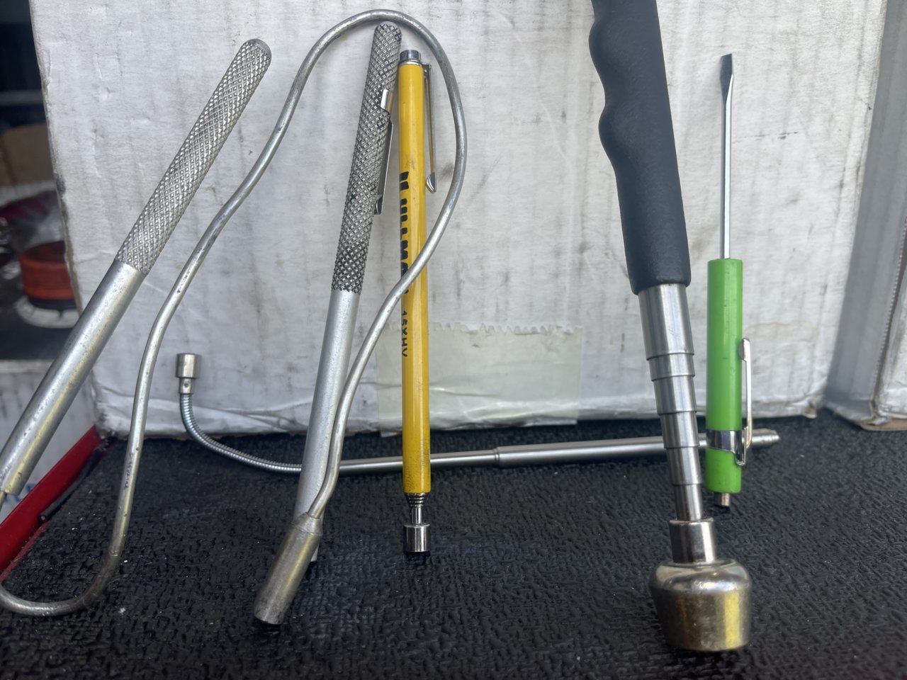

    I've got quite the collection of magnetic retreivers.
    I wonder if I'm the only one who notices, when I drop a fastener, it could go right, left, back, stay where it fell, or go under the vehicle. It rarely goes anywhere but under.

    I too have a collection of grabby tools- but due to circumstances only a few are available where I'm at right now.
    Magnet stick is a no go for sure- I am curious about what this "safety wire" is.
    Those lovely curved thingies are called hemostats where I'm from. I've got those too- not going to reach inside this pulley... MIGHT have avoided dropping it in there in the first place, but here we are!

    That is quite a collection you have there. LOL

    The bell shaped one is great for retrieving. The side doesn’t stick to metal, just the bottom. So it doesn’t get stuck while fishing it down.
    The one in the very back is good for reaching around behind something.
