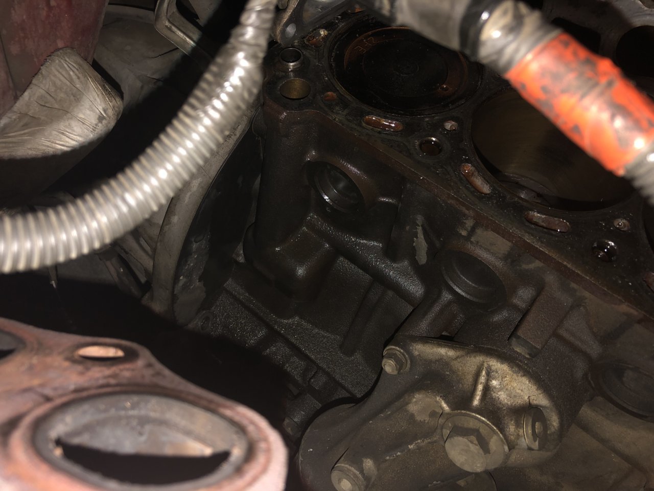

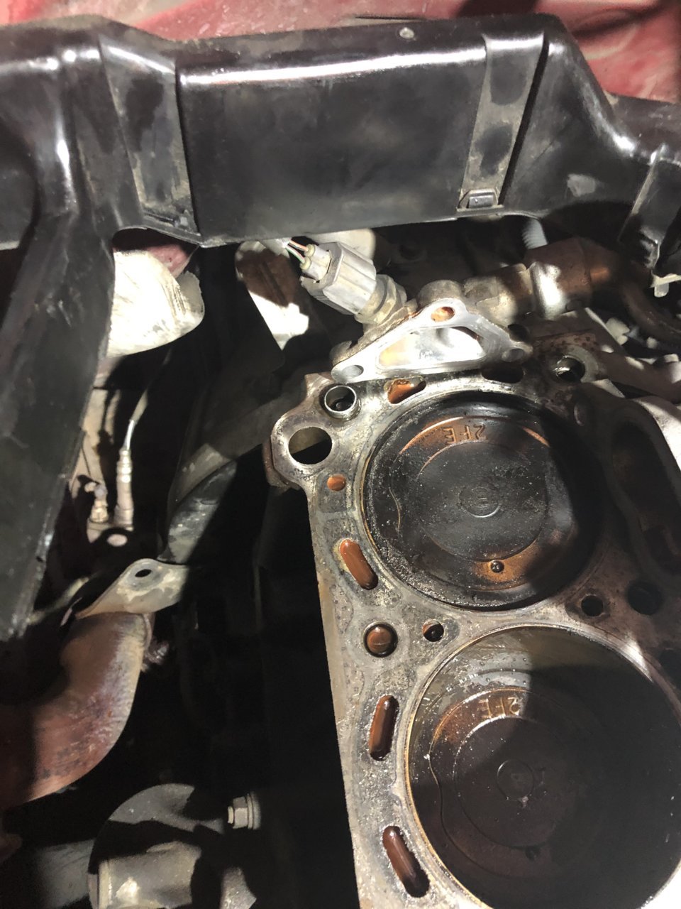

    So I made a horrible mistake while replacing the head on my 2000 tacoma 2.4 and I dropped a bolt down into the back left coolant hole that goes into the block, I really have no idea on how to get it out I’ve tried a multitude of magnets and such but it’s just too deep. Would I have to drop the transmission to get to it?

    Can you unbolt the piece from the Block with the transmission removed??
    It is not part of the block it is where the sensors bolt into correct?

    2
    It is part of the block, it’s that bigger hole on the top left

    Predator tube steps, Ranch Hand grill guard, Magnaflow CatBack exhaust, Toyota tool box & bed mat, 2LO Module by @Up2NoGood, Rearview Compass/Temp Mirror, Tune by @JustDSM.
    If your referring to this 1 I believe that hole is an oil drain so your bolt may be in the oil pan, if it's not an oil drain it's an oil feed but I'm not sure.
