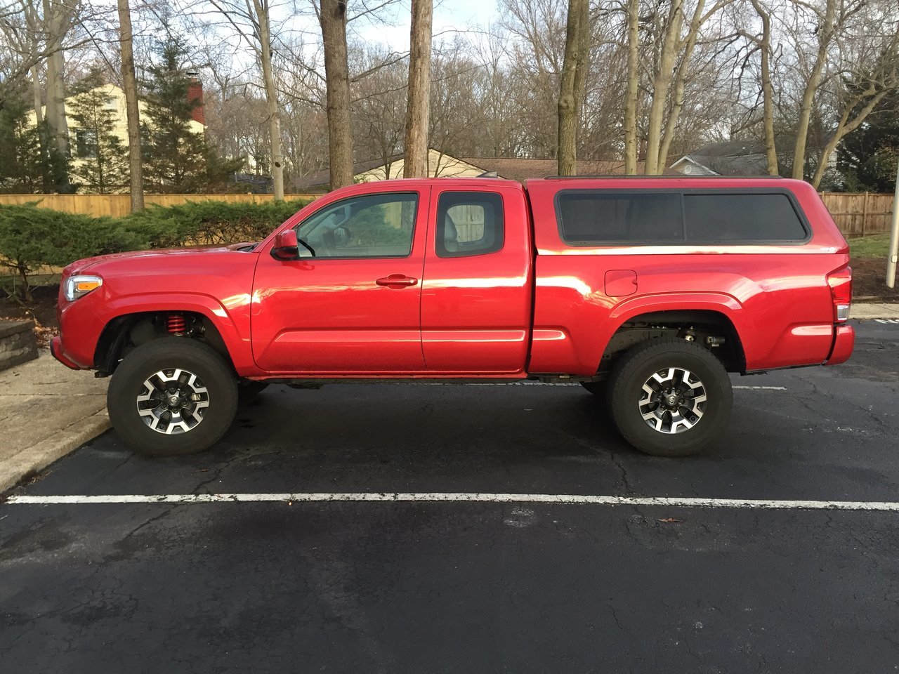

    So here is the funny thing- my truck stock, or the dealer lot- was 22" front, 23" rear. so it was already tall from the start. after the lift, 23/23. so measurements wise it gave just 1". BUT- its freakin tall. its weird.
