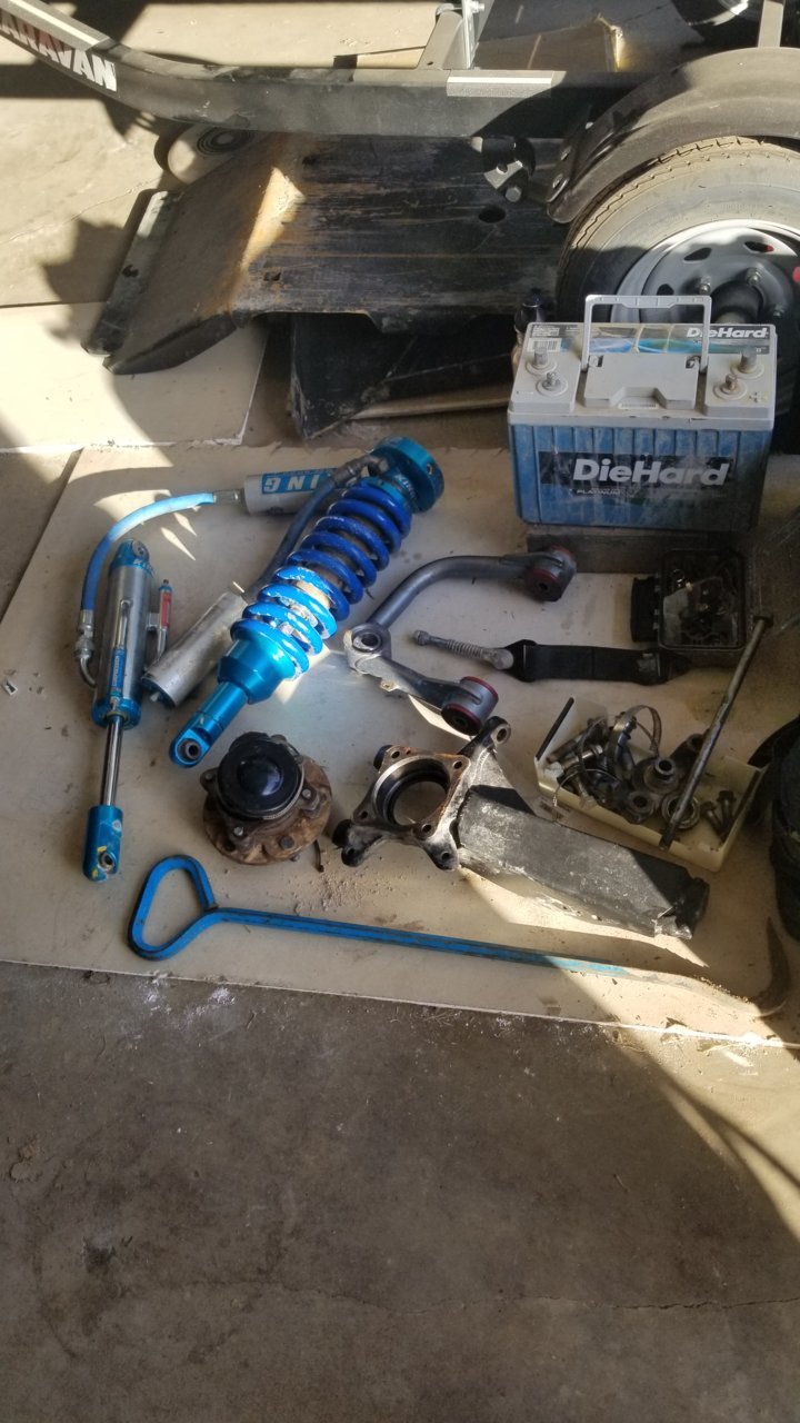

    Nice to be home.
    Thats me on the left and on my right is the best navigator ever!

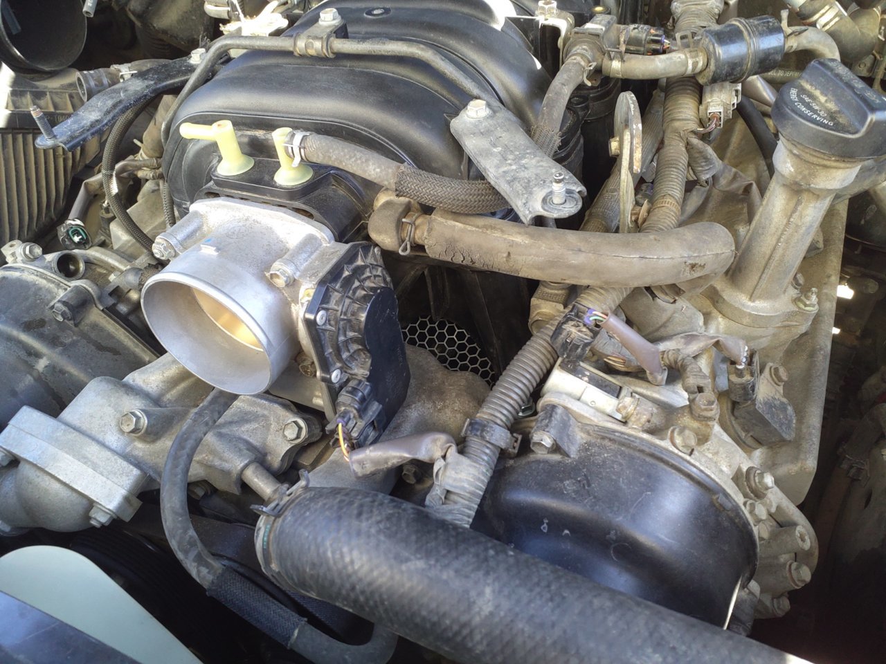

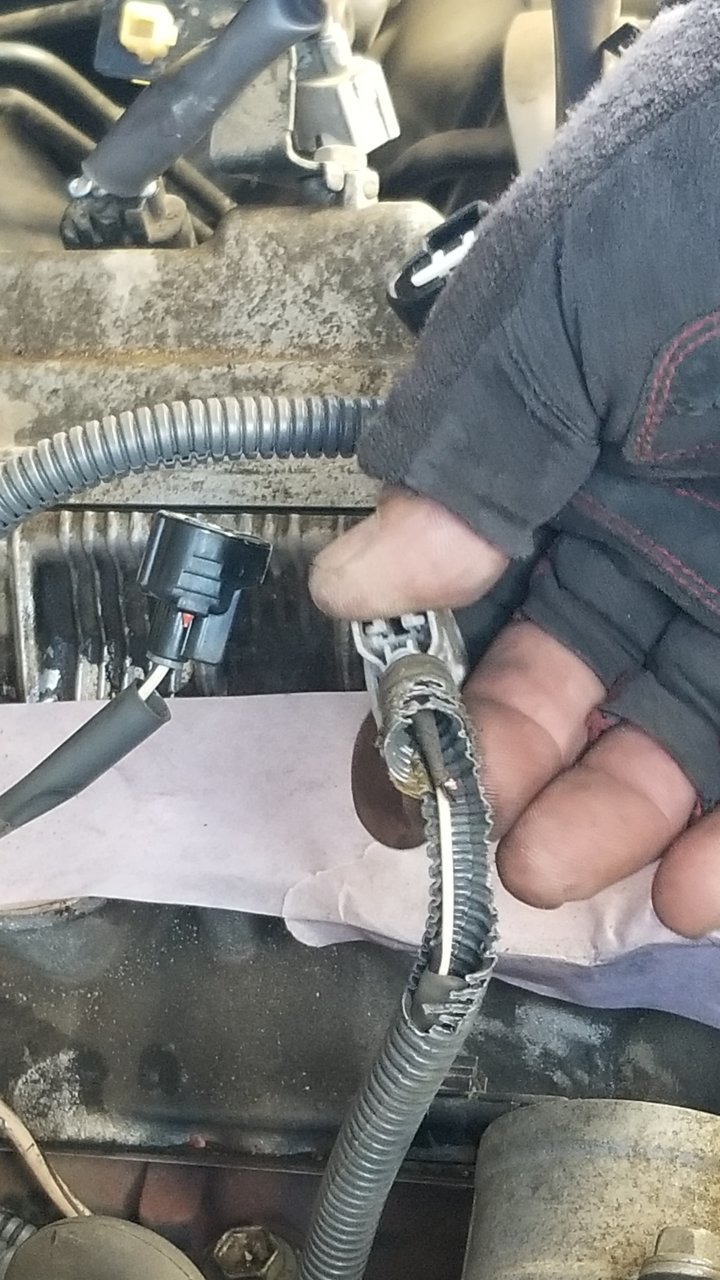

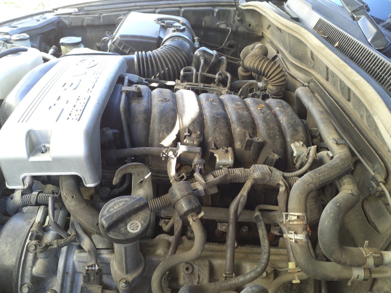

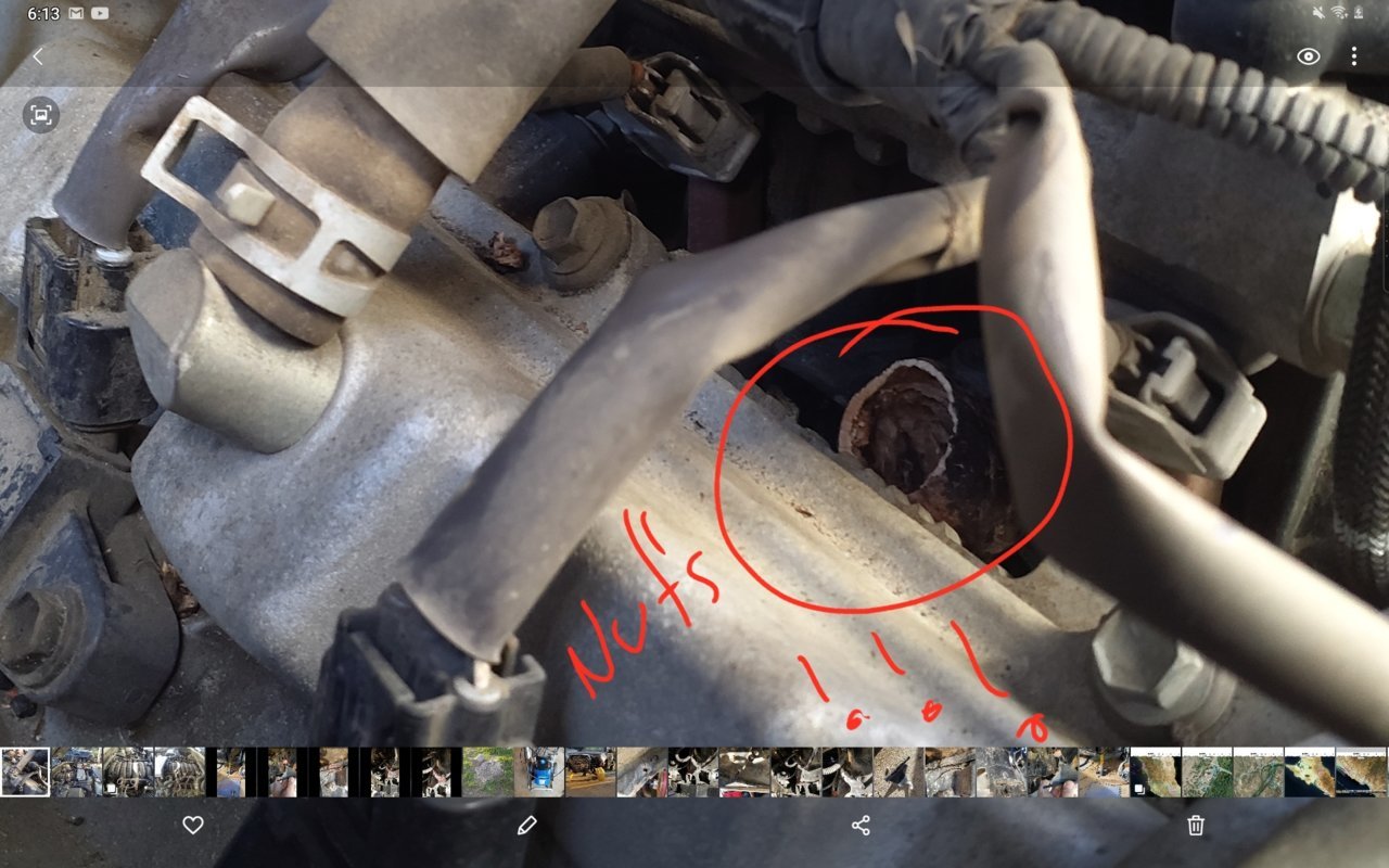

    And the hit just keep coming. P0333 knock sensor code on the 4runner. Wouldn't you know it there's a rodent nest under the intake manifold. Bet they chewed some wires. Guess the Tacoma will have to wait as this is her DD.20210221_153758.jpg

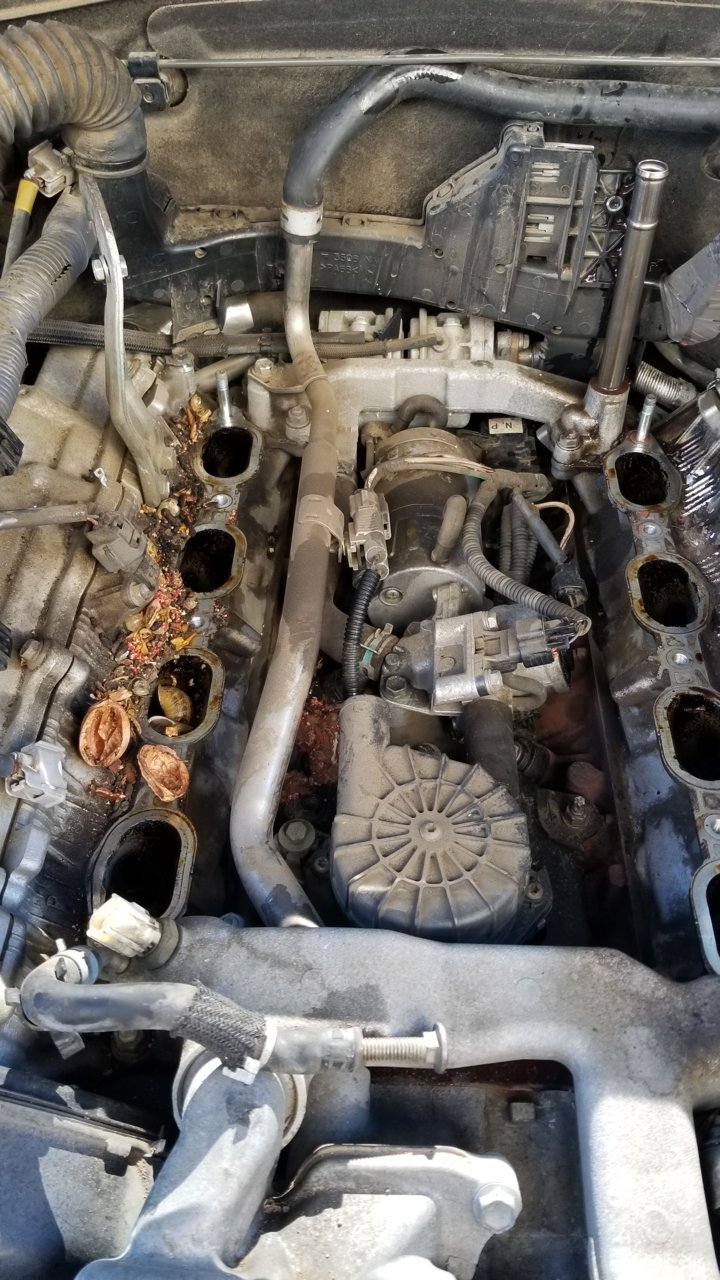

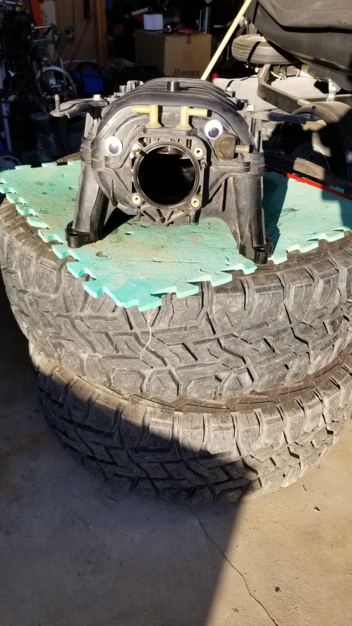

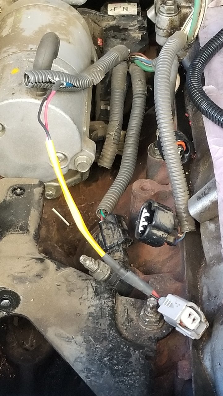

    Rats are now top of my hit list

    Now just waiting for some of that fancy capsaicin Honda tape and new gasket set so I can put this one back together and get back to repairing the Tacoma.

    And oh yea what f'n genius decided to put the starter in this location?!o_O

    you have to loosen/remove the header to take the starter off :bananadead:

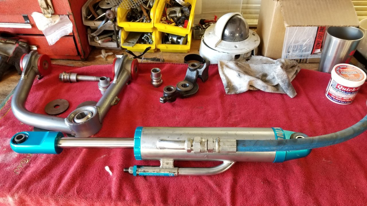

    Got some time to clean up the Tacoma

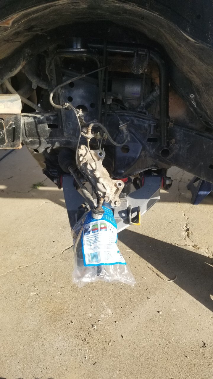

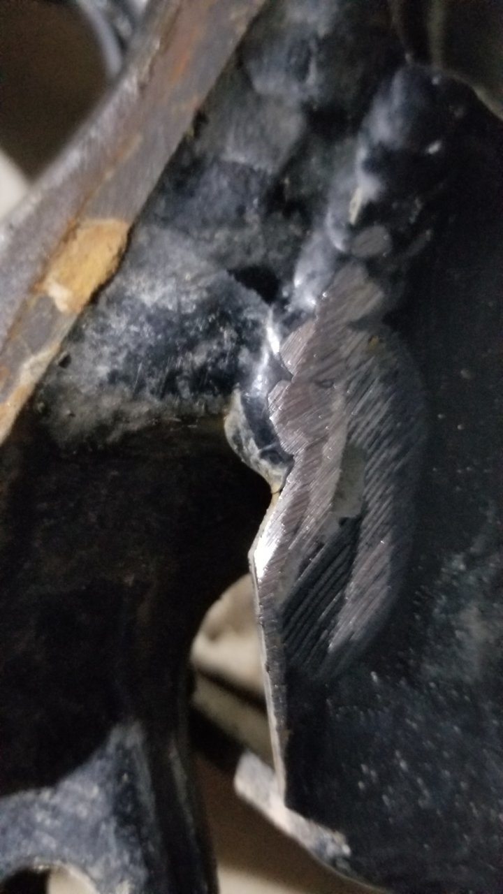

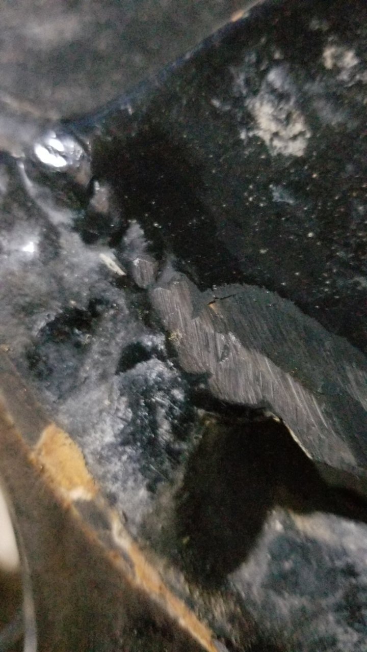

    May have found a crack int the spindle gusset? Take a look tomorrow.

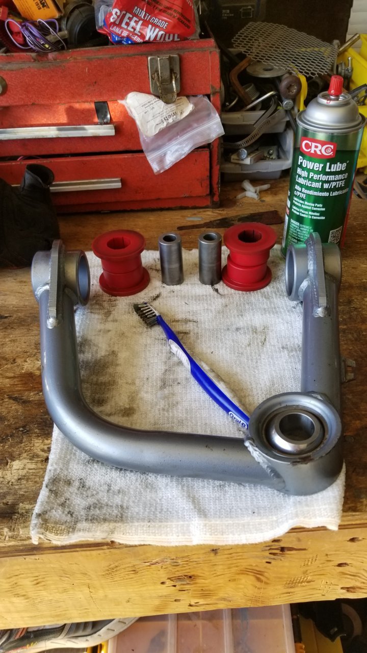

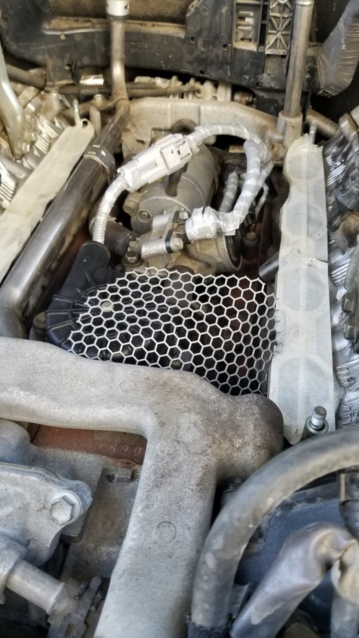

    See that screen in there? I put them anywhere I thought those varmints were entering.
    whatstcp likes this.
