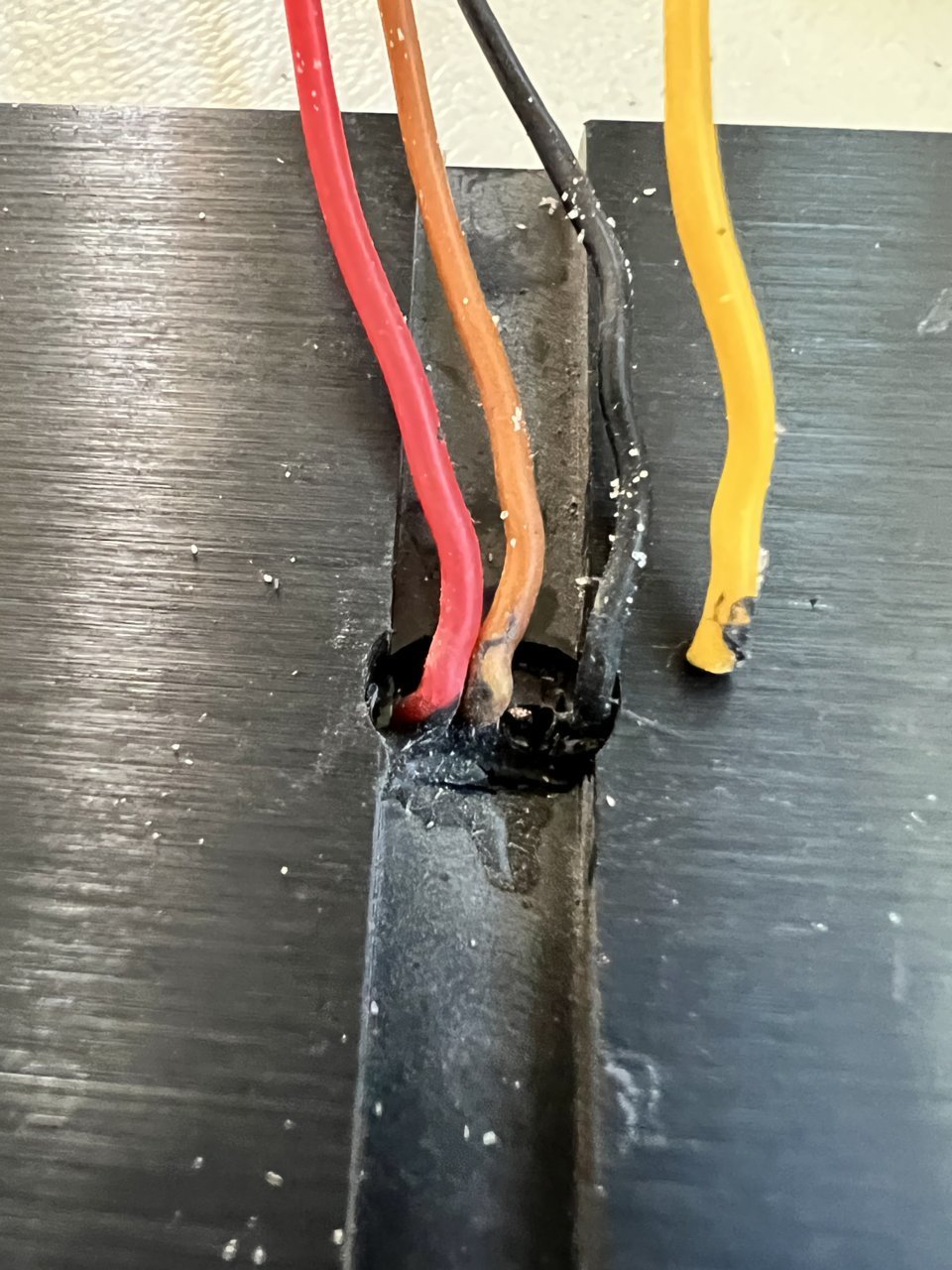

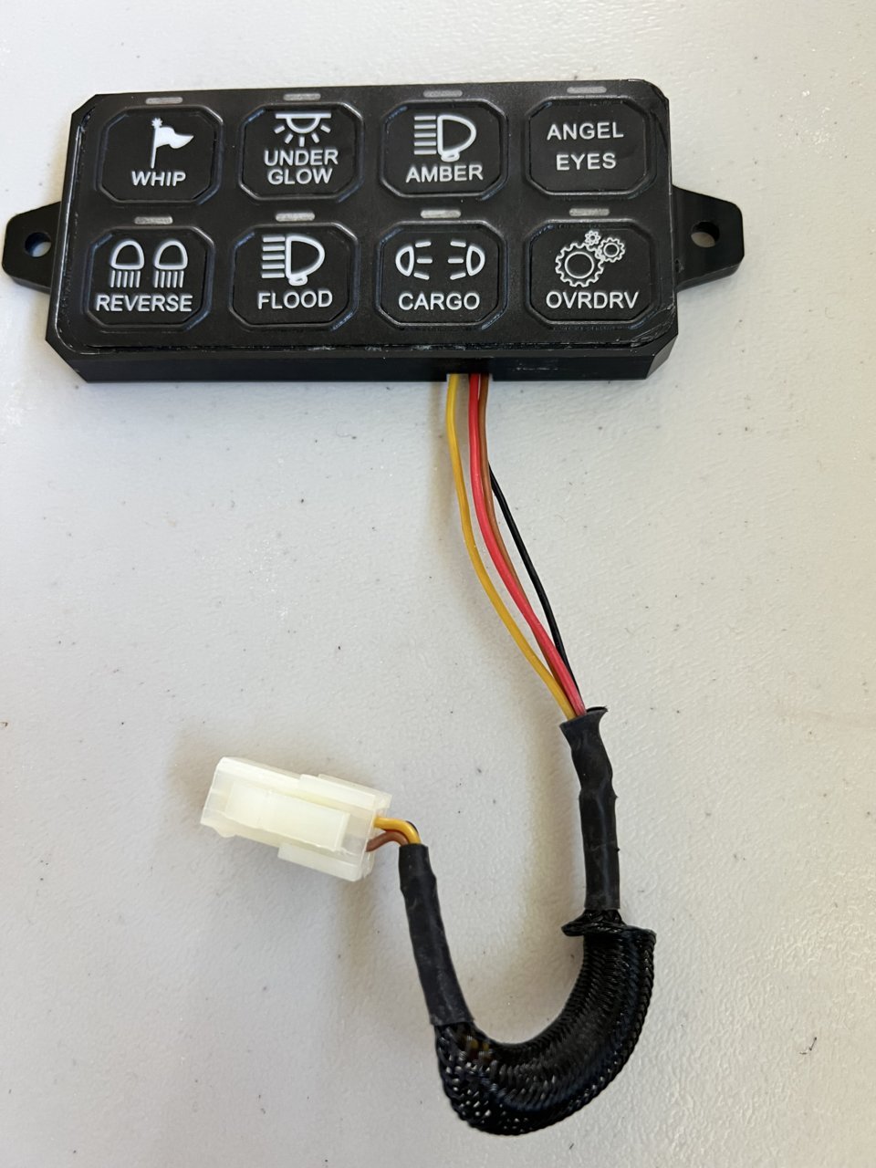

    IMG_0058.jpg IMG_0059.jpg my light control module is now been repaired- seems 3 out of 4 wires had come undone from their solder points - had to do some micro soldering work- all lights working again but now that it is back in some of the lights on the face of the control unit not working :annoyed:

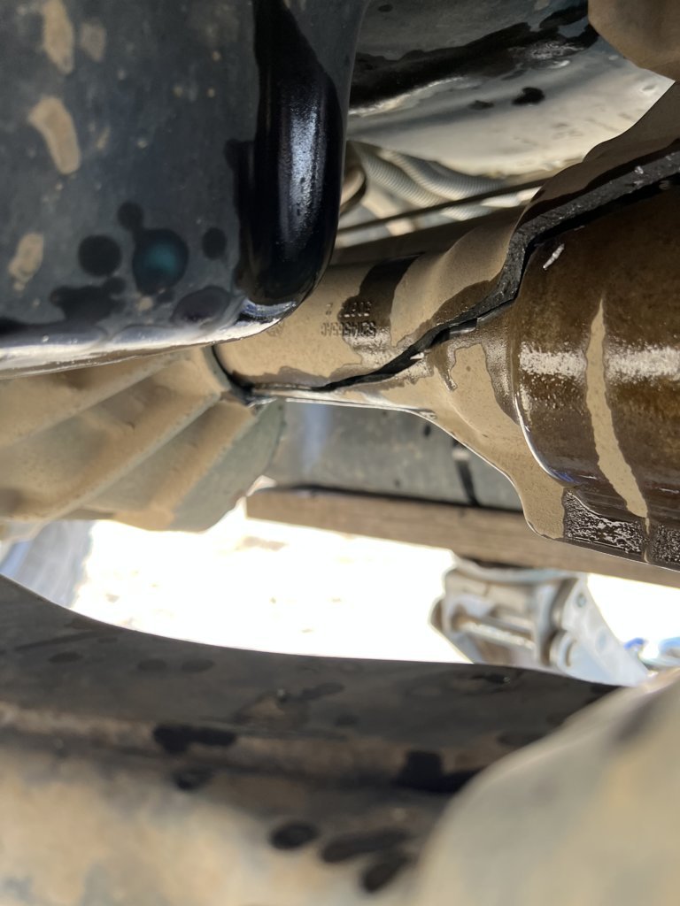

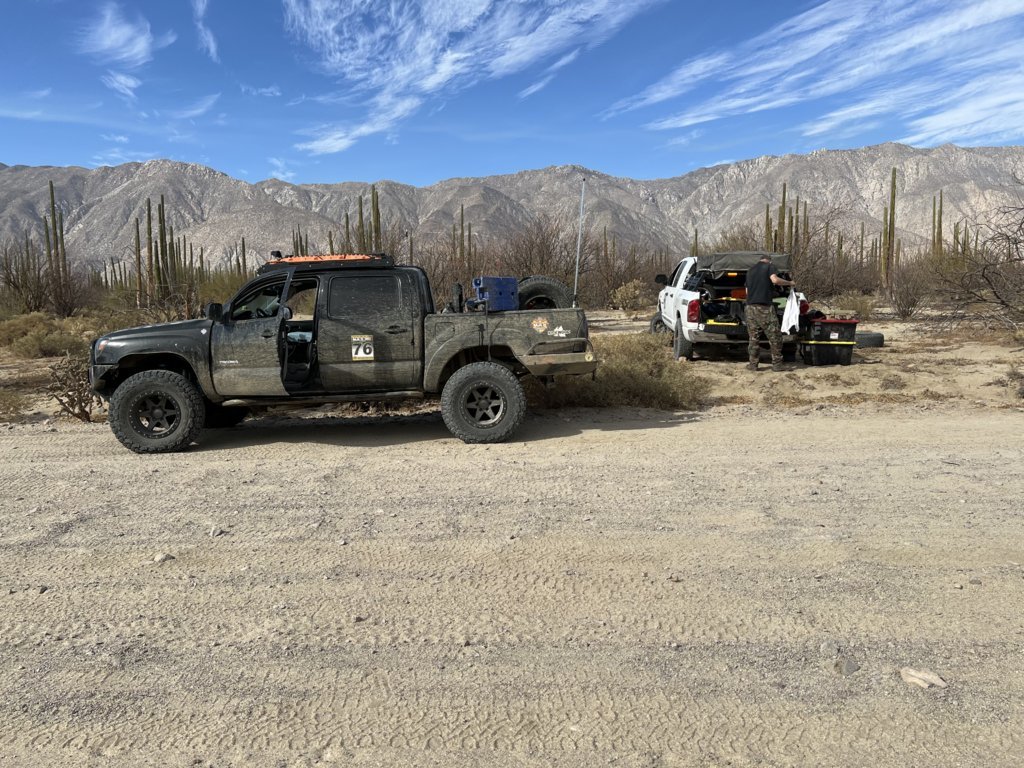

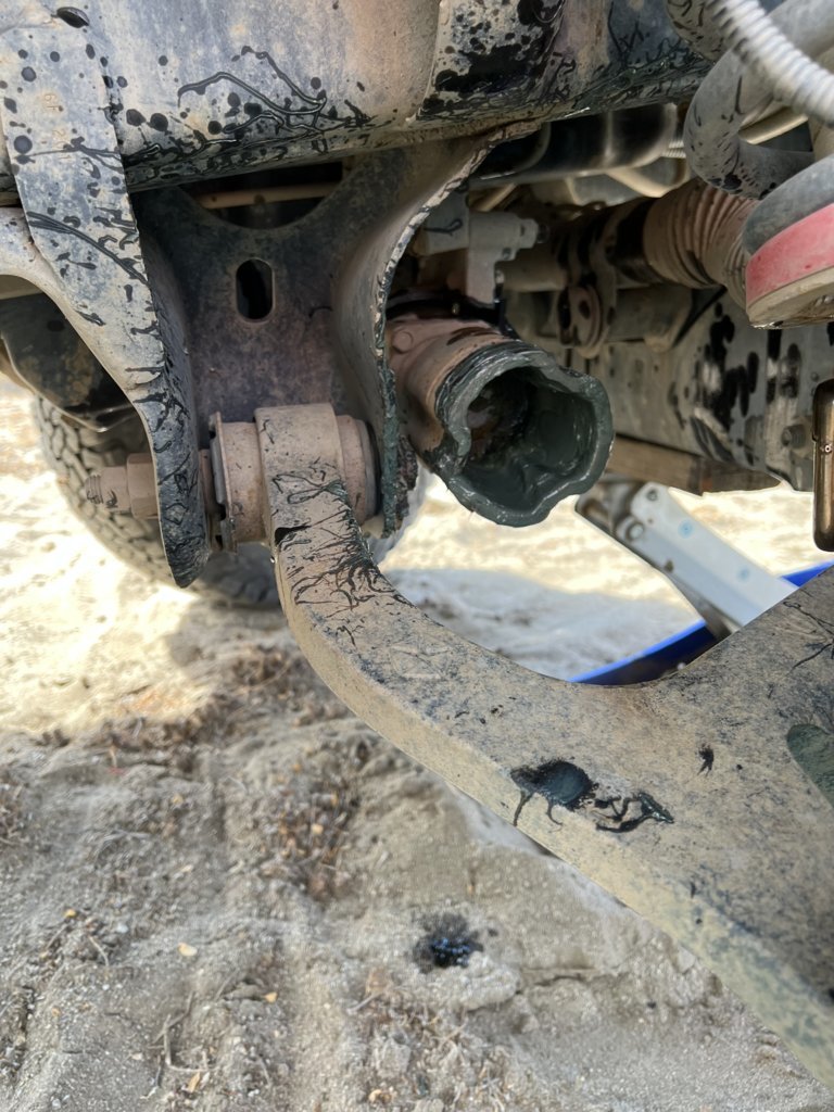

    busted front diff on the Doge- I just happened to be passing by and had the only 35mm socket for hundreds of miles that allowed us to convert from 4WD to 2WD and keep a good buddy in the rally

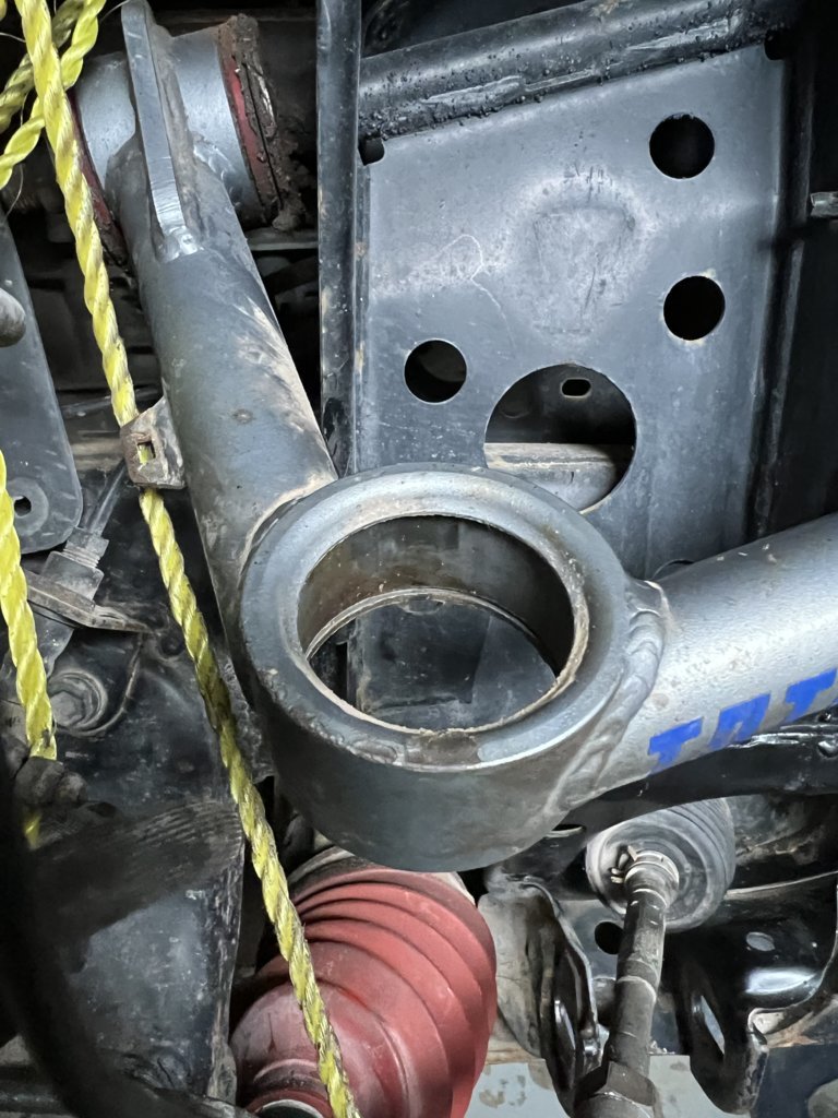

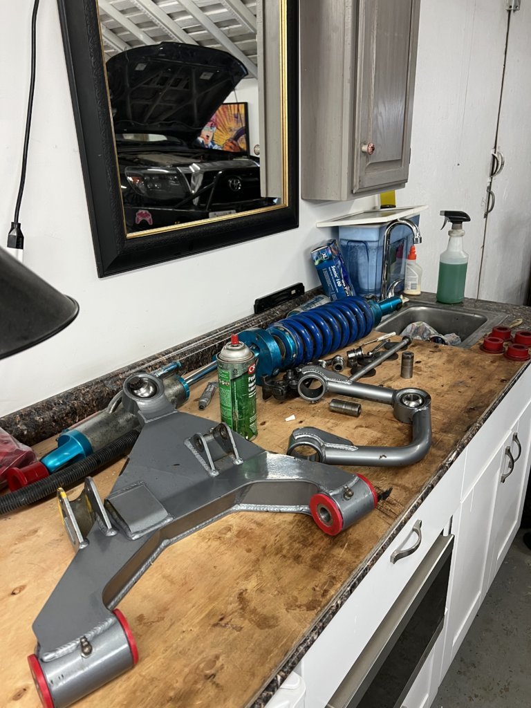

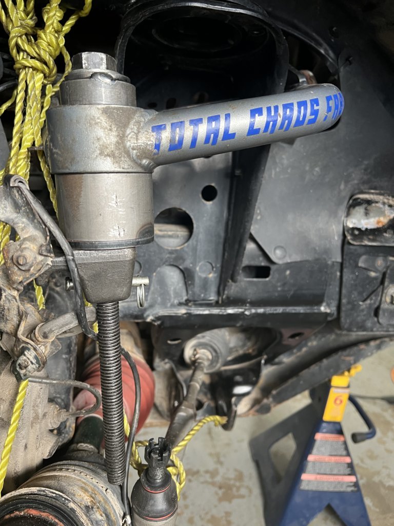

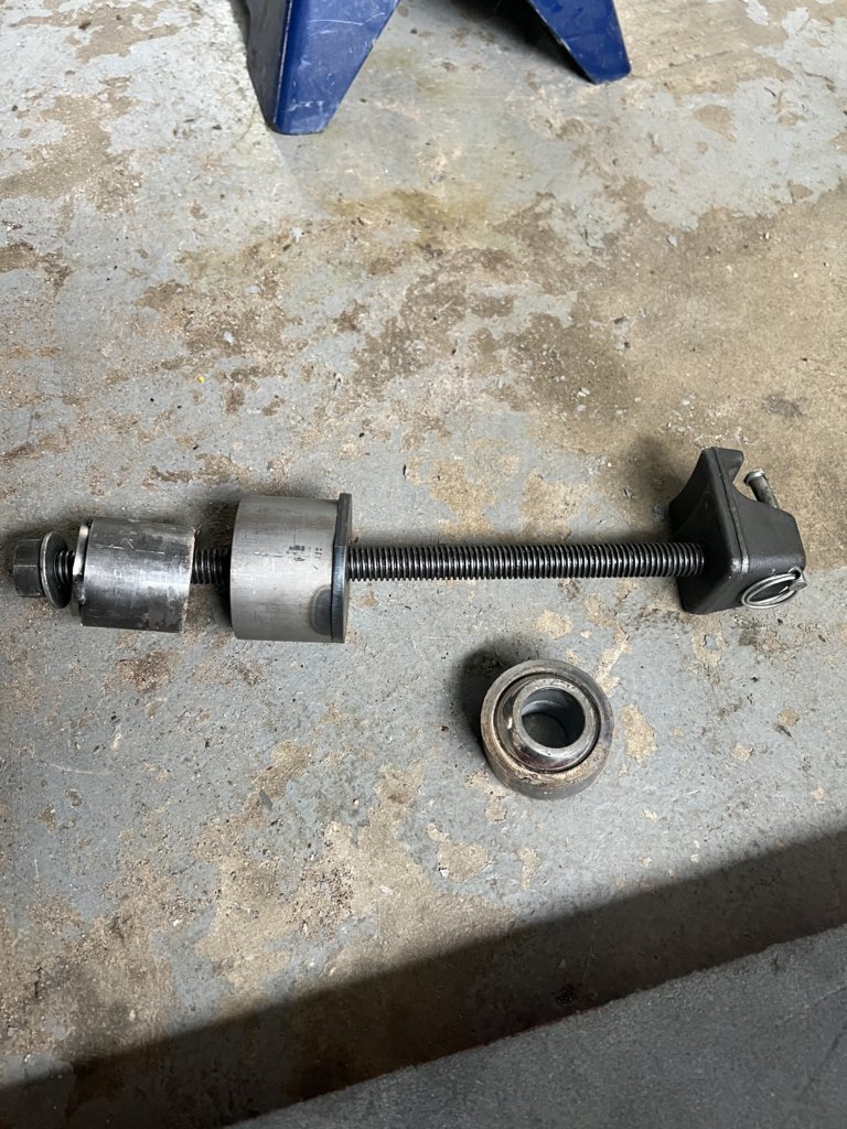

    and of course after rally repairs- I had a Total Chaos Steel uniball replacement tool that I modified to be like the Aluminum one they are selling now- just drilled holes for my spring compressor tool so It could become more useful
  17. Apr 28, 2025 at 8:26 AM
    #337
    Micatom33
    Micatom33 [OP] Under the Truck with Beer!
    Jul 17, 2013
    #108443
    1,673
    Santa Cruz,CA
    2008 BSP DCSB

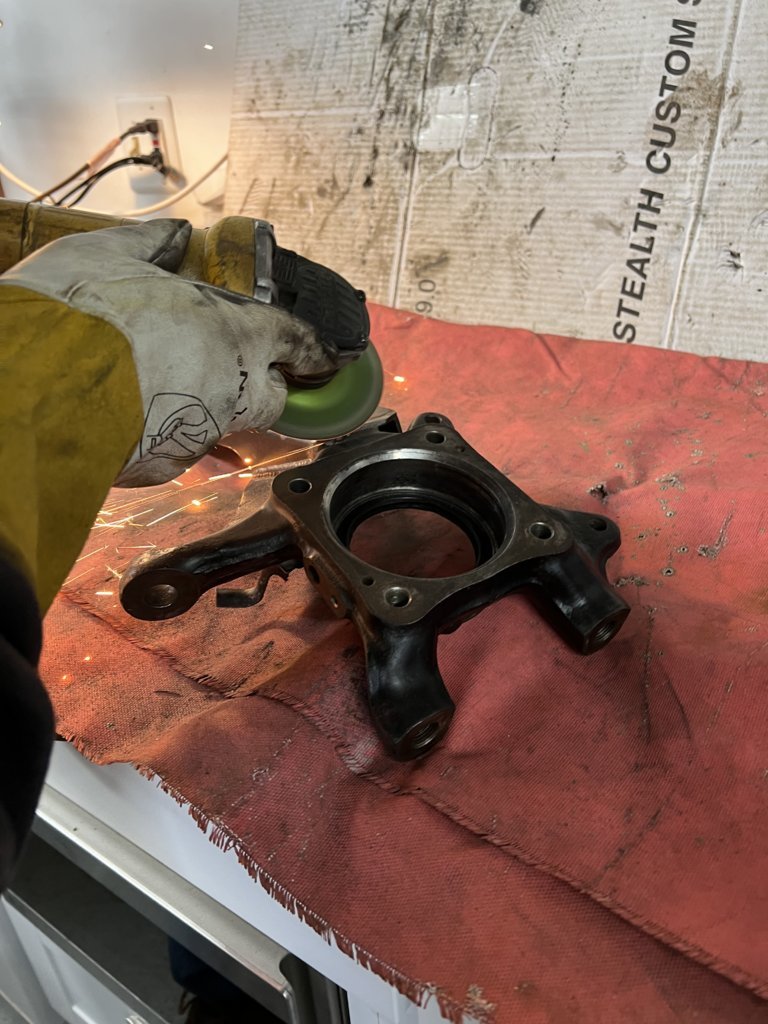

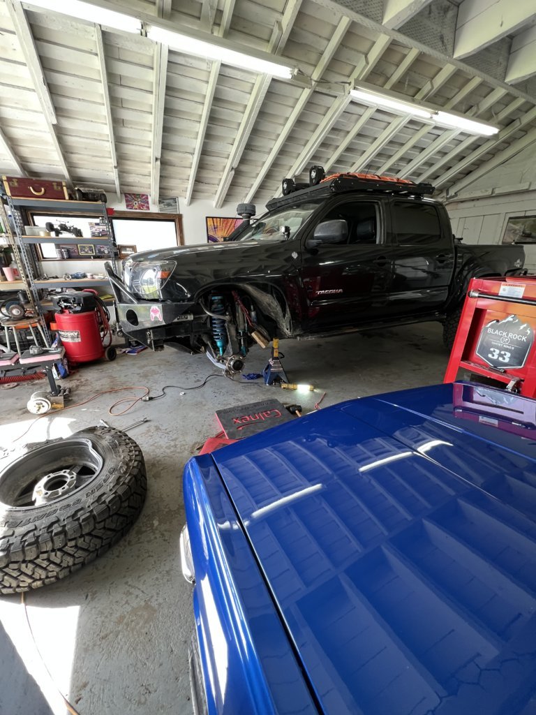

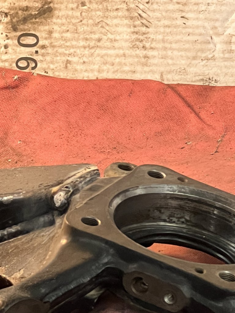

    As always I go through the truck after a good baja trashing-
    Things to fix

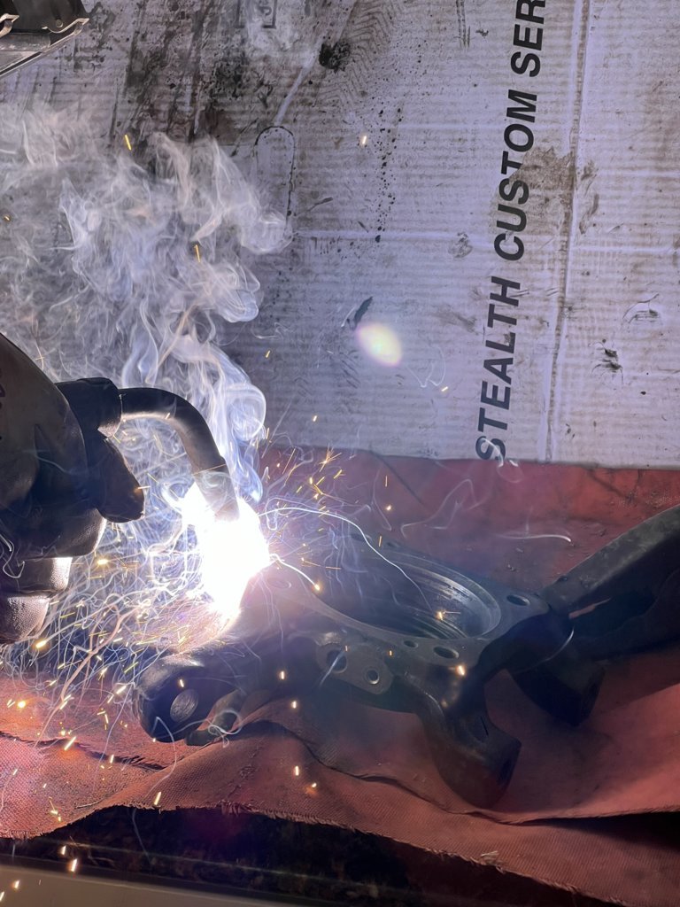

    uniballs, shocks getting rebuilt, cv boot repair, new upper and lower bushings for controll arms,bent lower controll arm mounting point-, checked reinforced spindles found crack- rewelded, oil change all around, new Rim new tire,broken antenna, cabin air filter, check all that stuff.... ya never know what you will find untill you look
