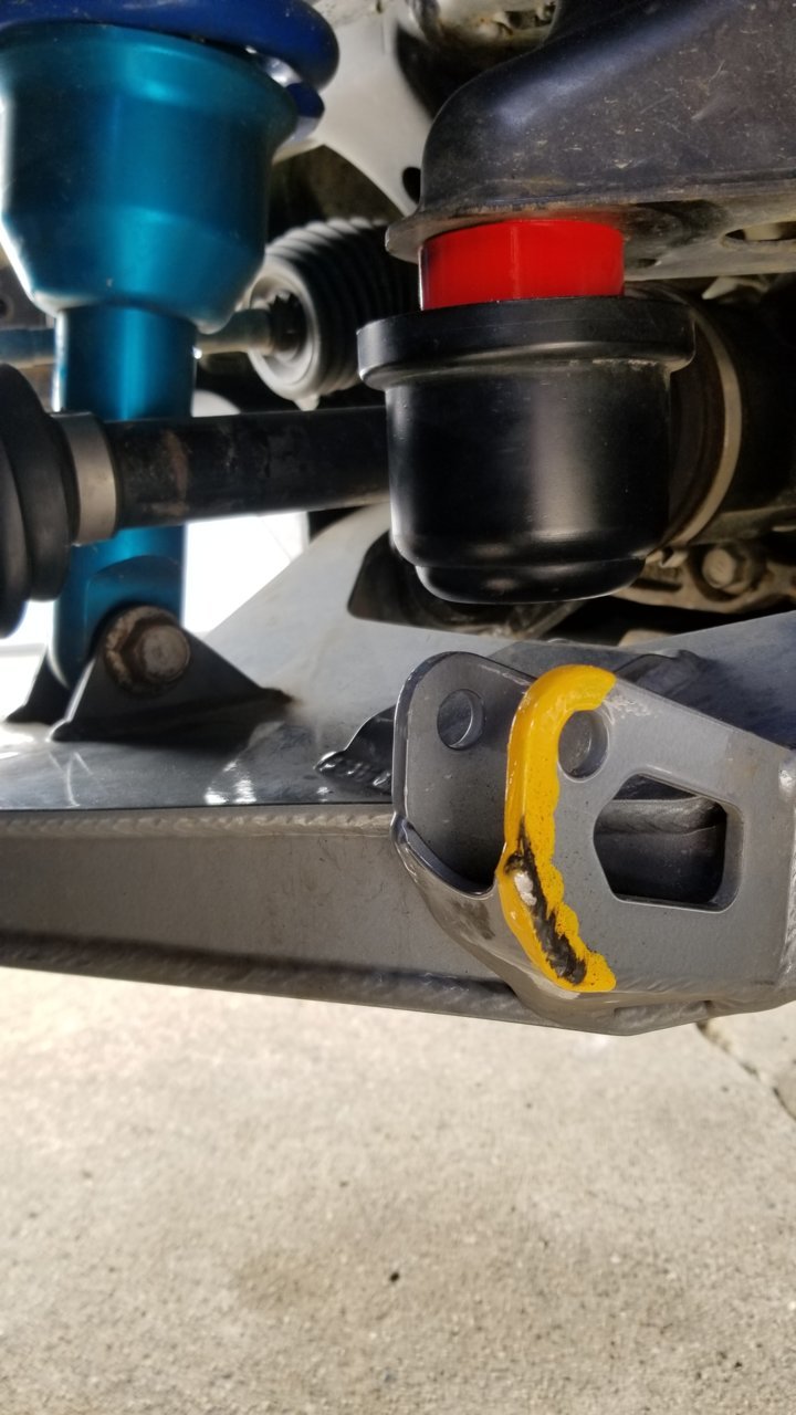

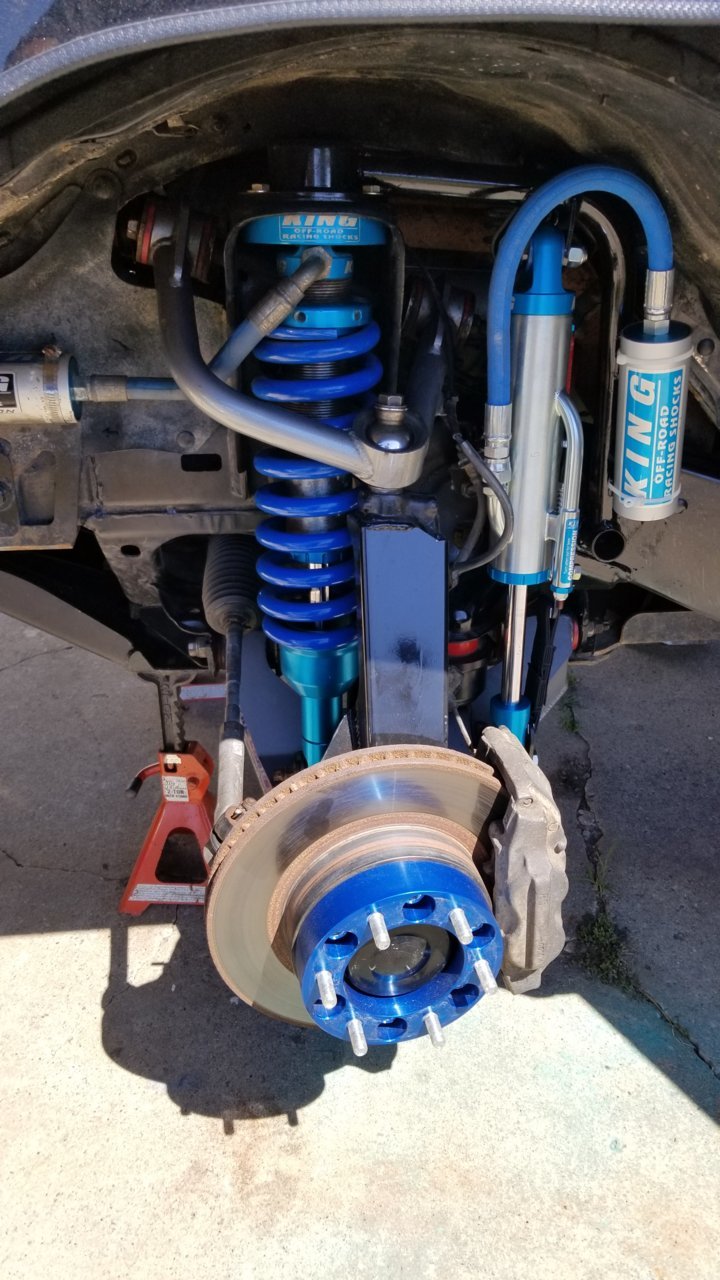

    With the new set up comes new rubbing issue this with 1.5 spacers
    whatstcp likes this.

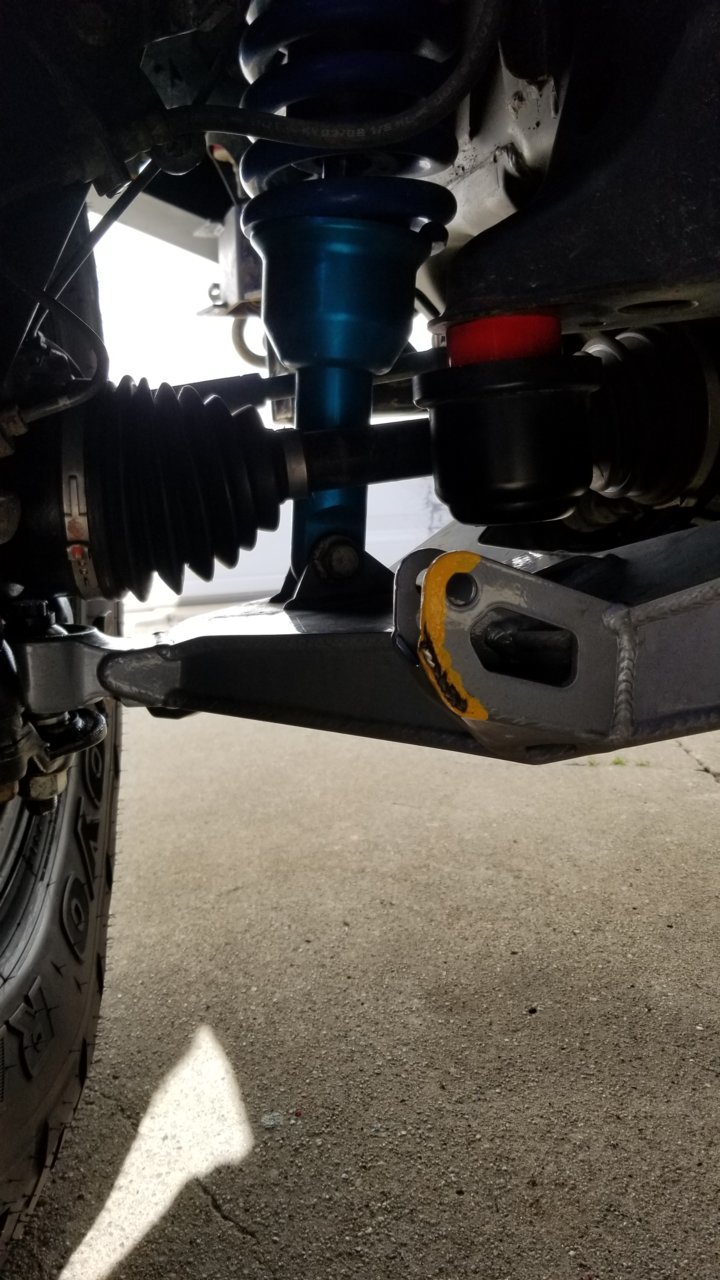

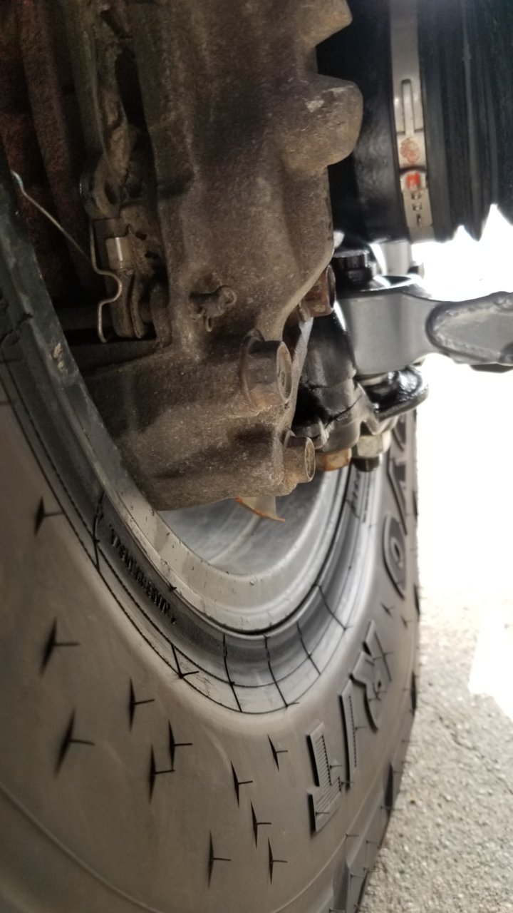

    And really dont like my caliper showing that much

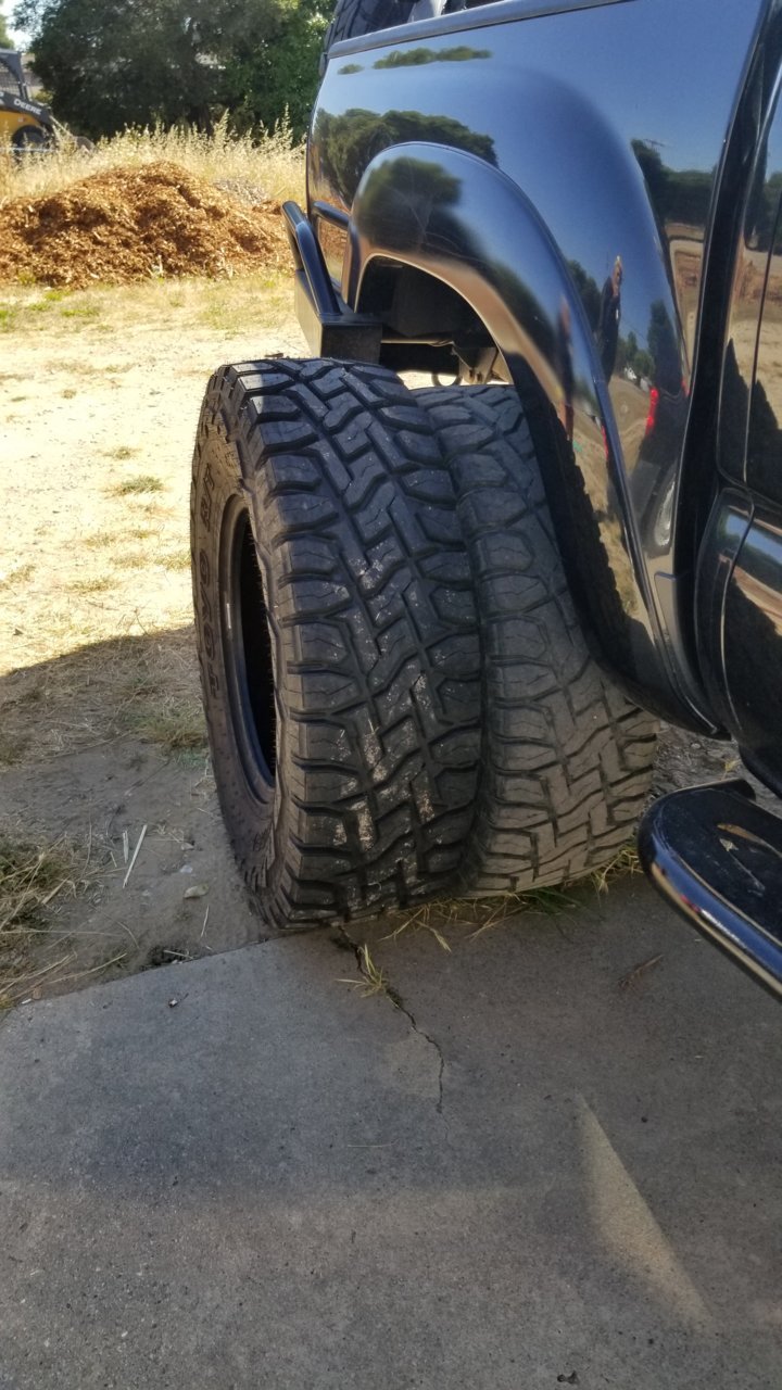

    You can see where the LCA is rubbing the tire.

    I had the 1.25 spacers on there and it rubbed so I marked it to see if the 1.5s would help..nope

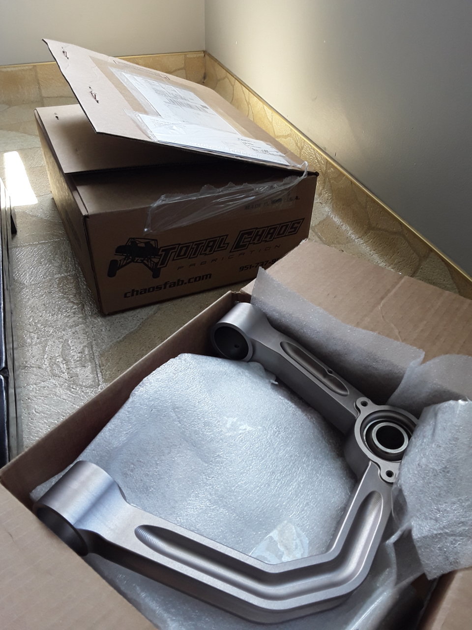

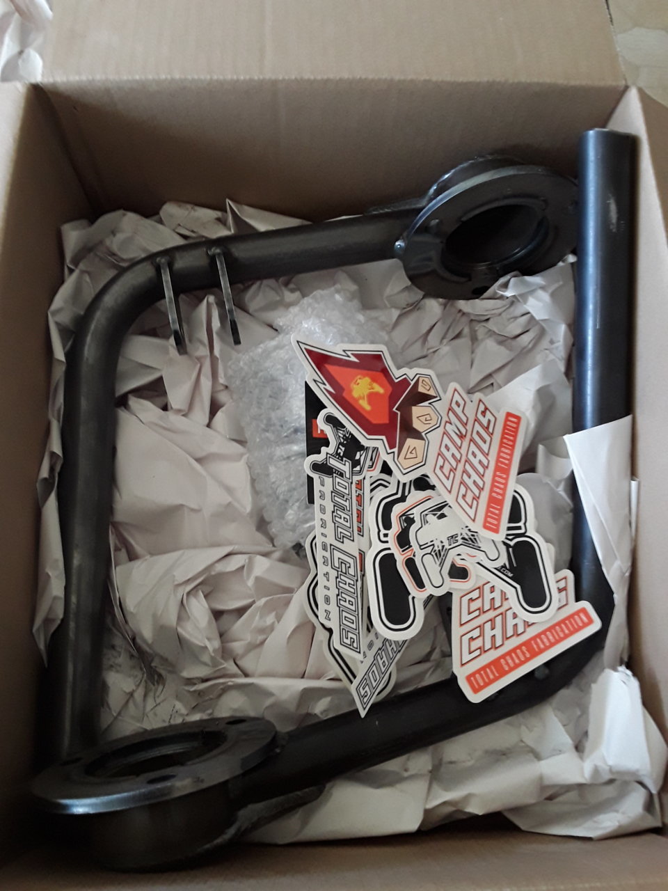

    Things are arriving
    The UCA s going on the 4runner

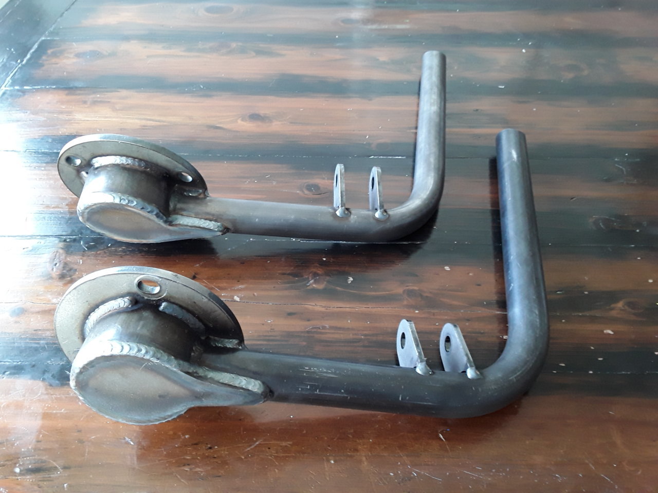

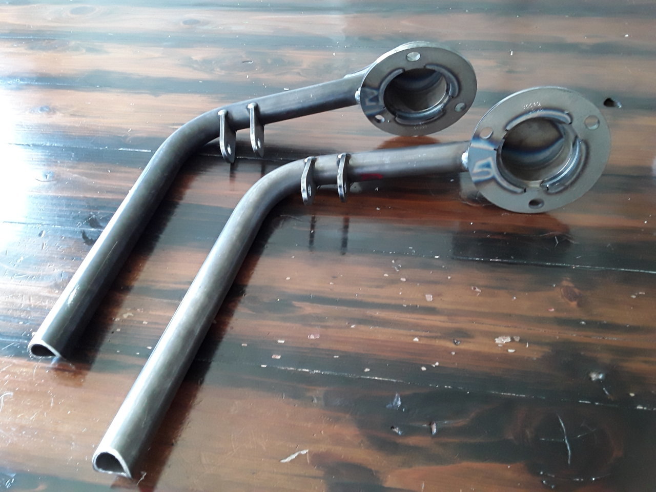

    Going to put the front TC LCA dual mount to use

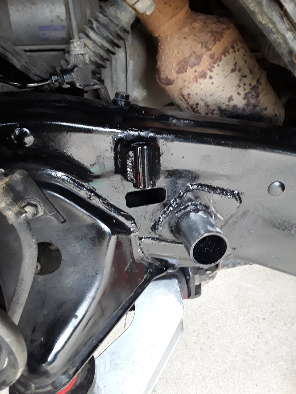

    :101010: those welds
    I have all the parts now just need to put it together.

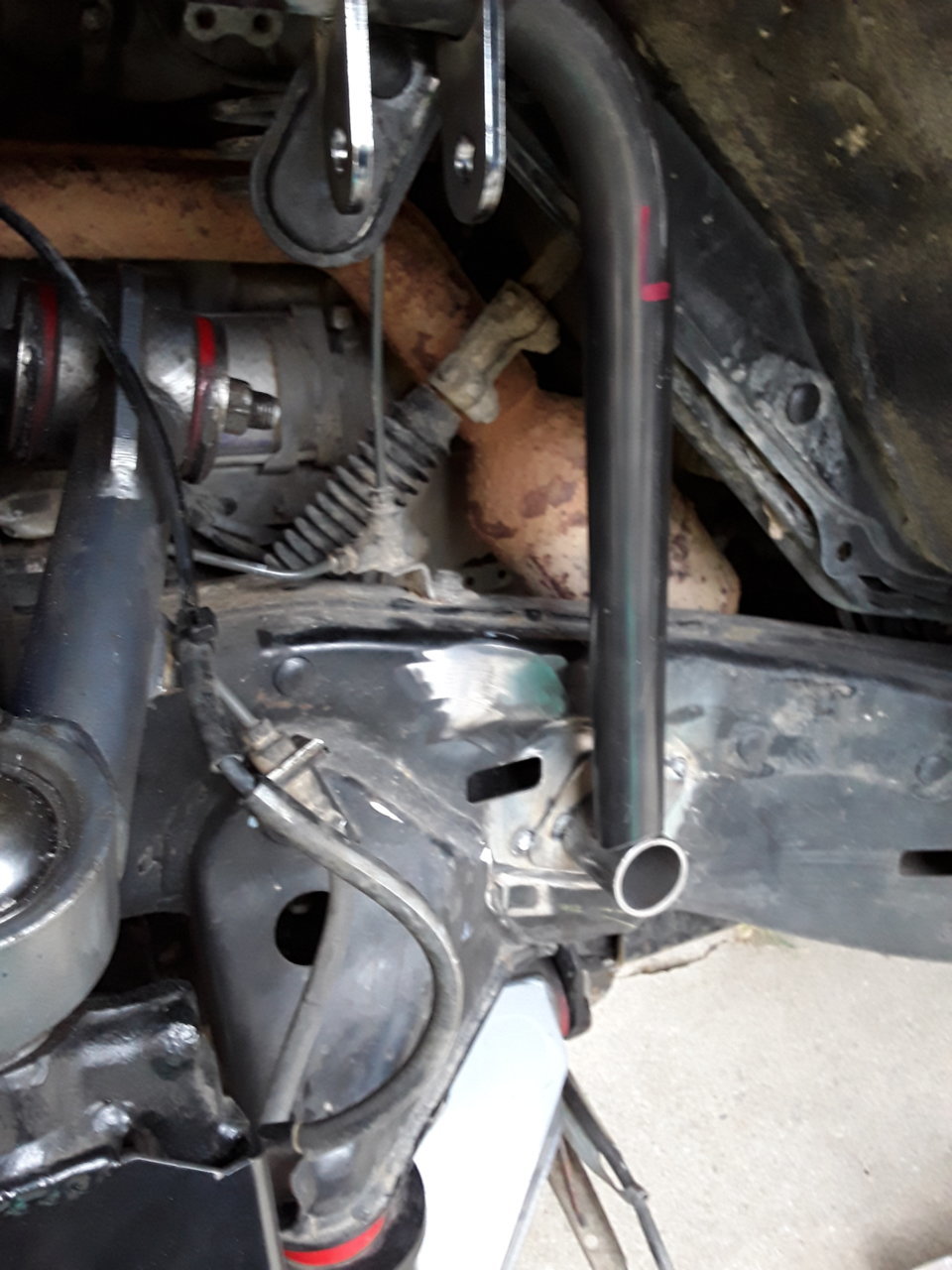

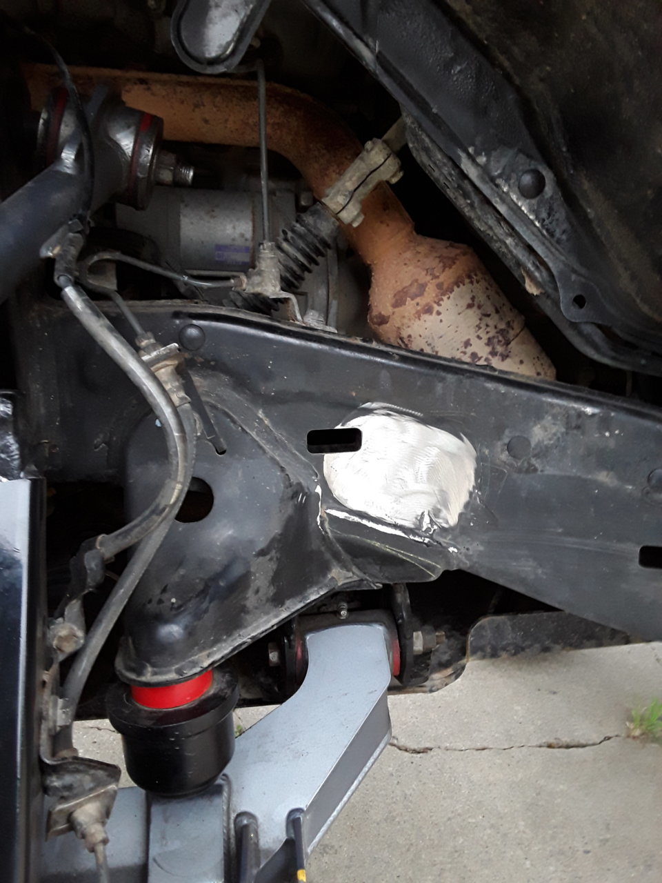

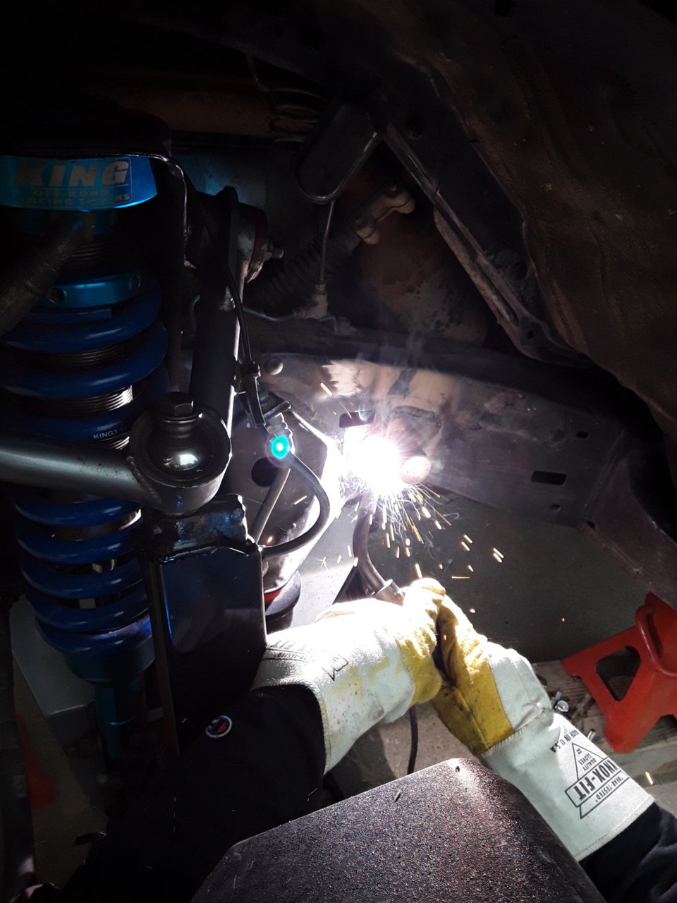

    Test fit going to weld it up tomorrow
    Have to adjust this mount over a bit

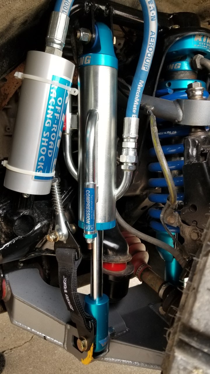

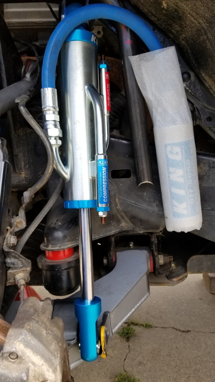

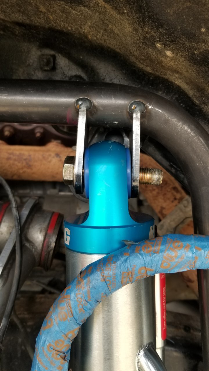

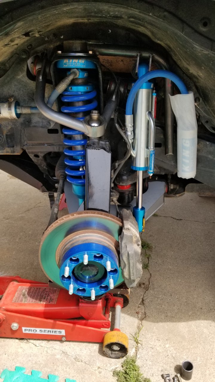

    Since this pic I have removed the limit strap and added hose clamps to keep the rr in place.
    I removed the 8 inch strap because it was to short and the hardware would interfere with shock compression. I am going to switch to 9 inch straps that should bolt together above the end of the shock cap where the piston goes in and out.

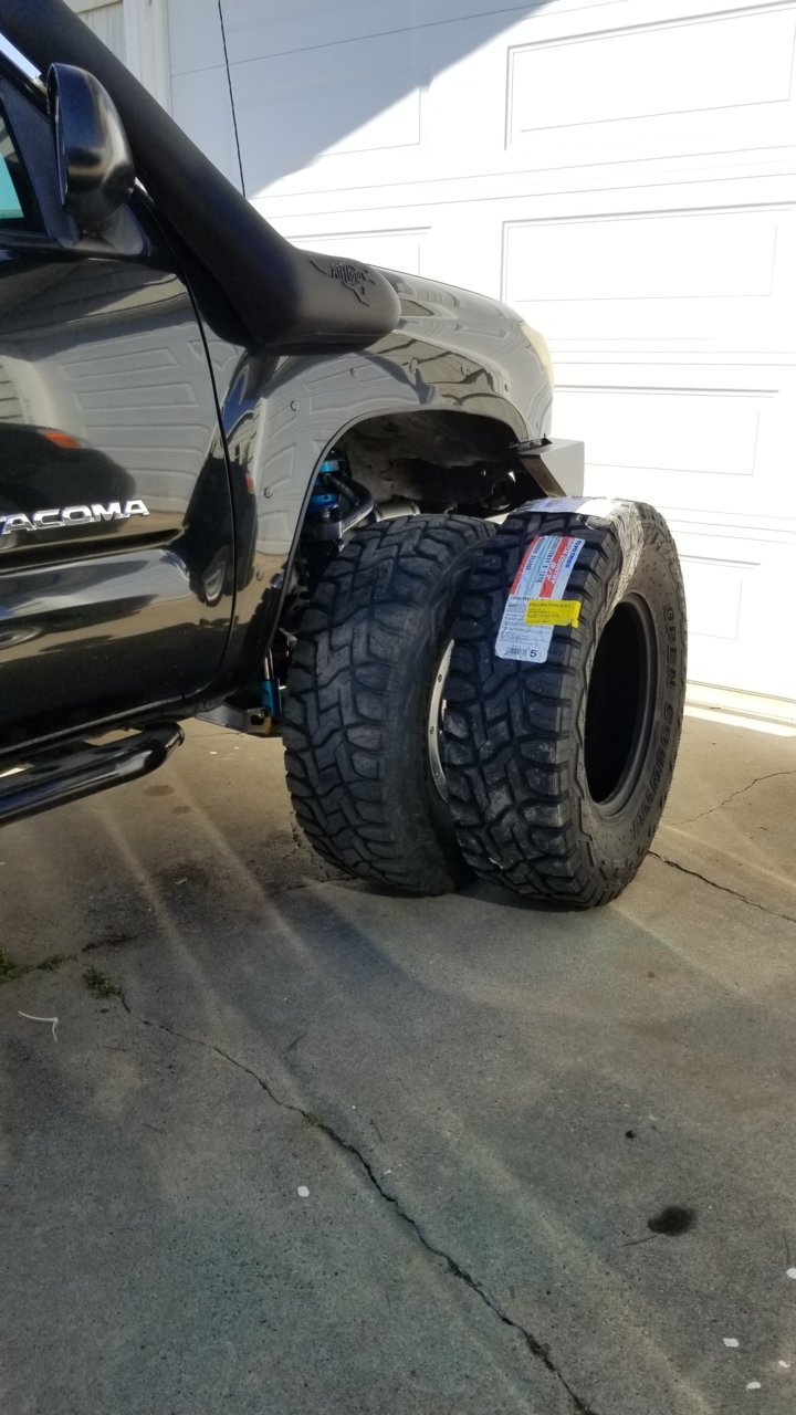

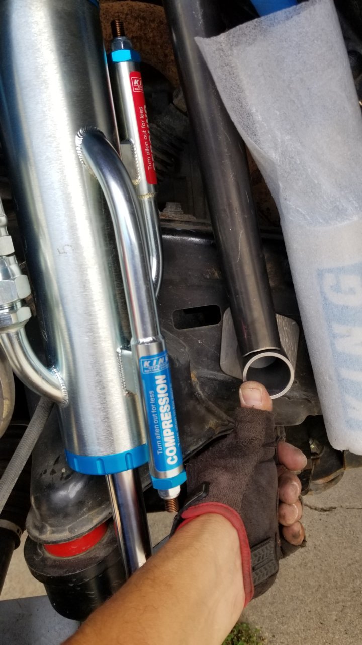

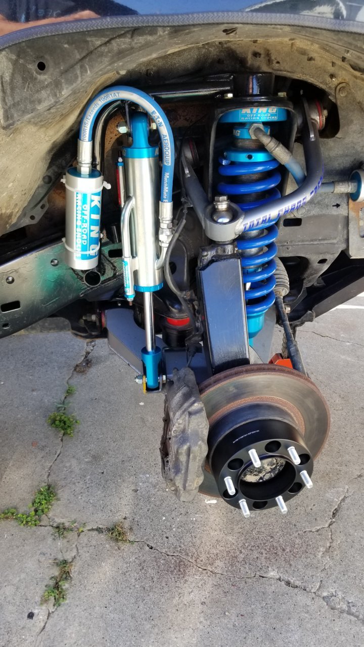

    In addition I think I have solved the rubbing issue
    1.5 inch spacer
    2 inch spacer
    Yikes did not really want to use a 2 but it has solved my rubbing issues. Also I have about a fingers clearance between the compression bypass tube and my tire ...I know there was an issue with this with another member.

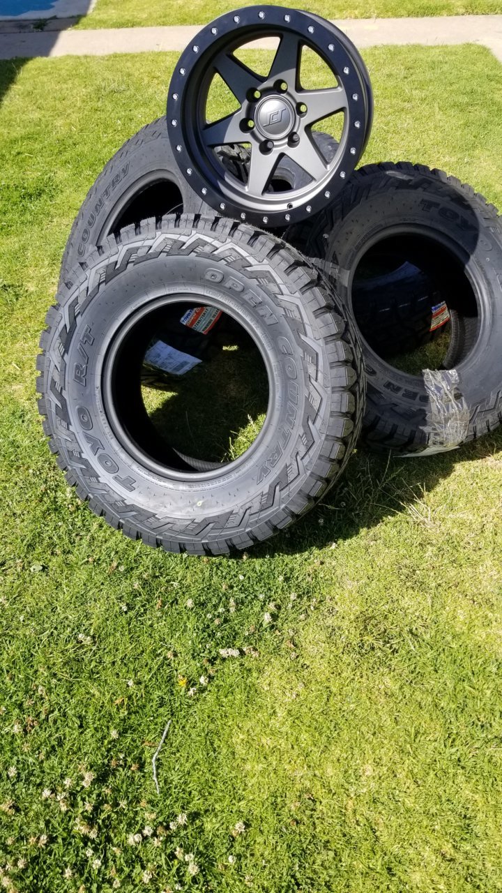

    Now waiting for 285/75R17to show up

    Relocated rr for moar clearance. Now it only barely rubs at full lock. Have tire appointment on Friday.
    These should solve that :fingerscrossed:

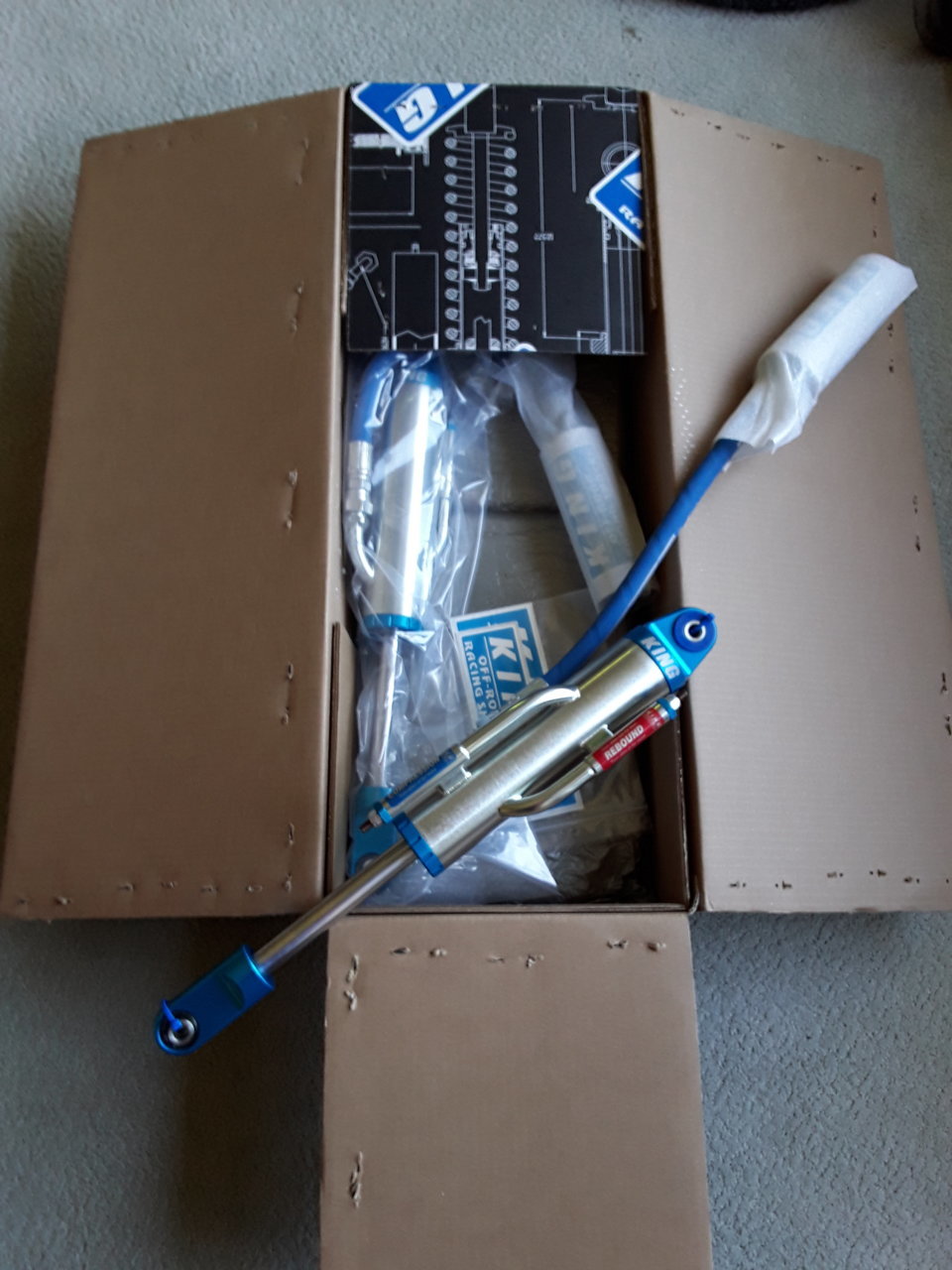

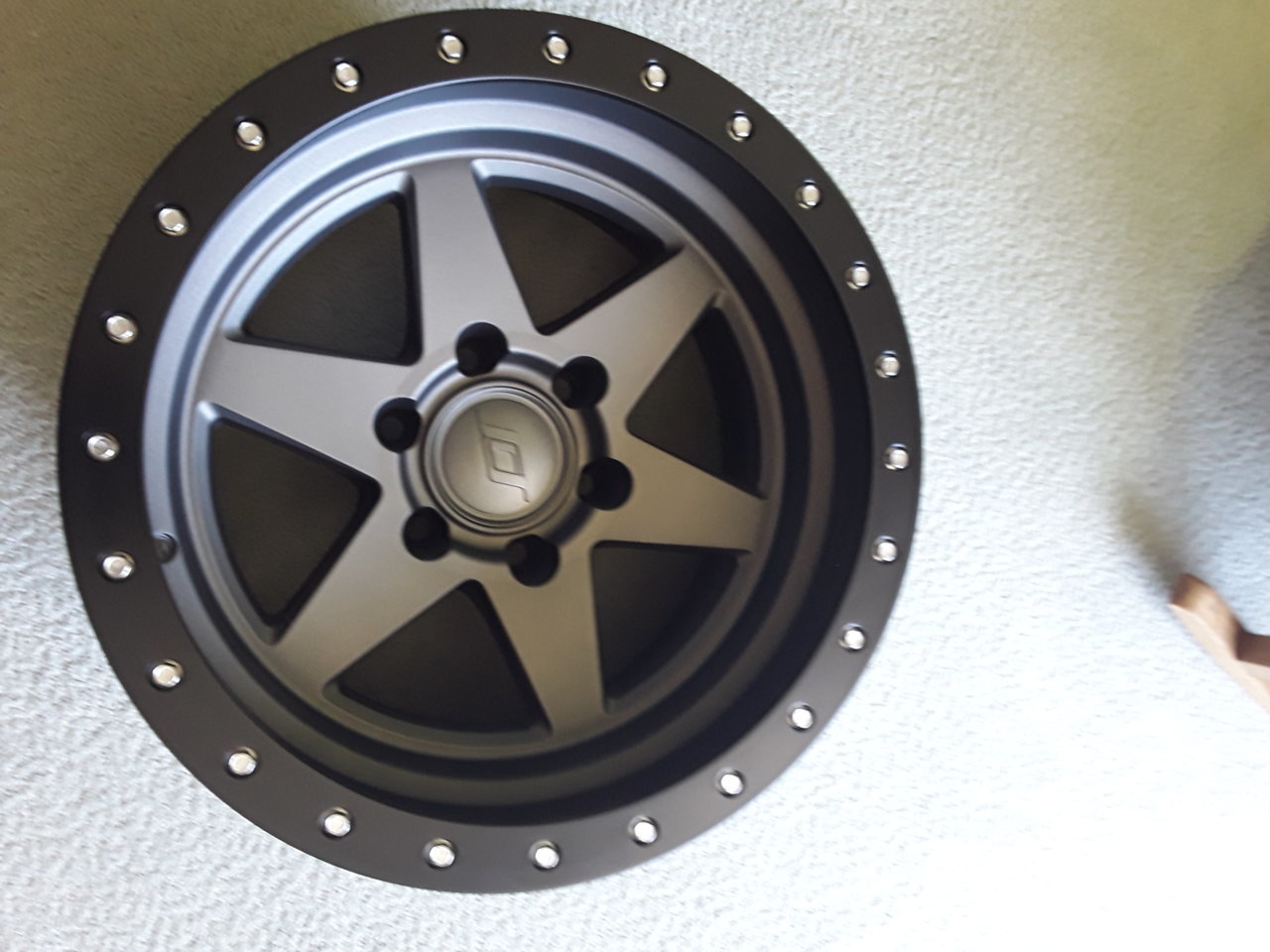

    These just arrived
