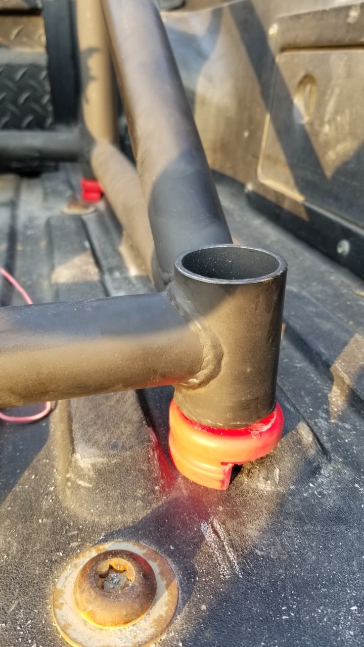

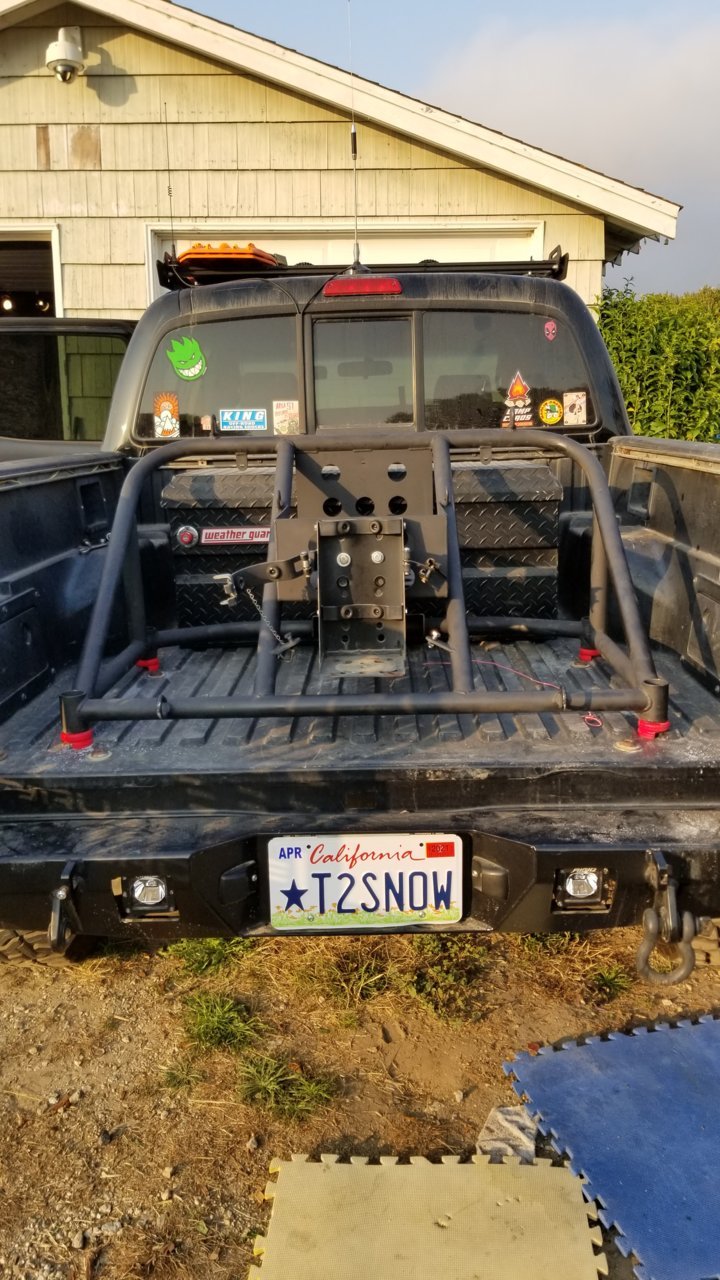

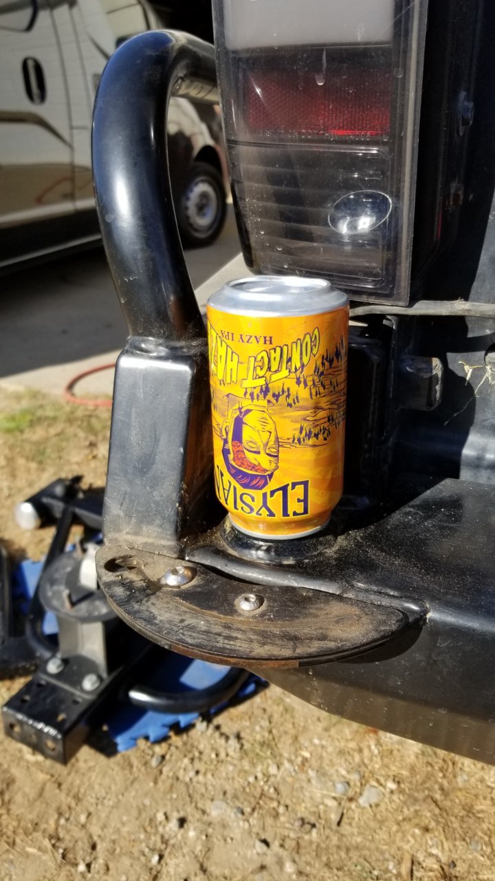

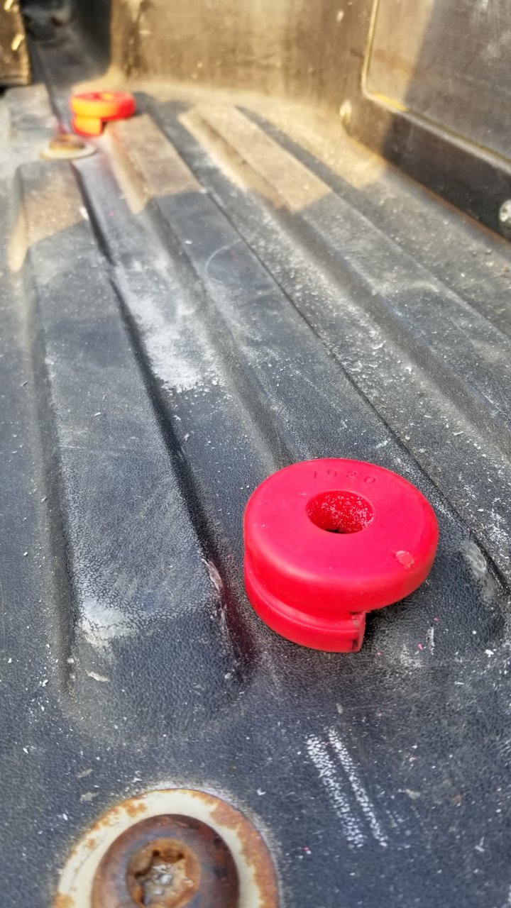

    I got the cool tire rack off of
    @J03x122
    and had originally planned to mount it up against the bed like he made it to be. Well as usual there was some unhelpful bed bolt that was rusted in place and would not budge.
    Had to come up with another plan. This is where I ended up.
    Had to get a little creative and made some bushings to get it to sit nice when I do bolt it down.

    He built it to fit a 285/16s
    I have 285/17 and had to air the tire down to get it in there.

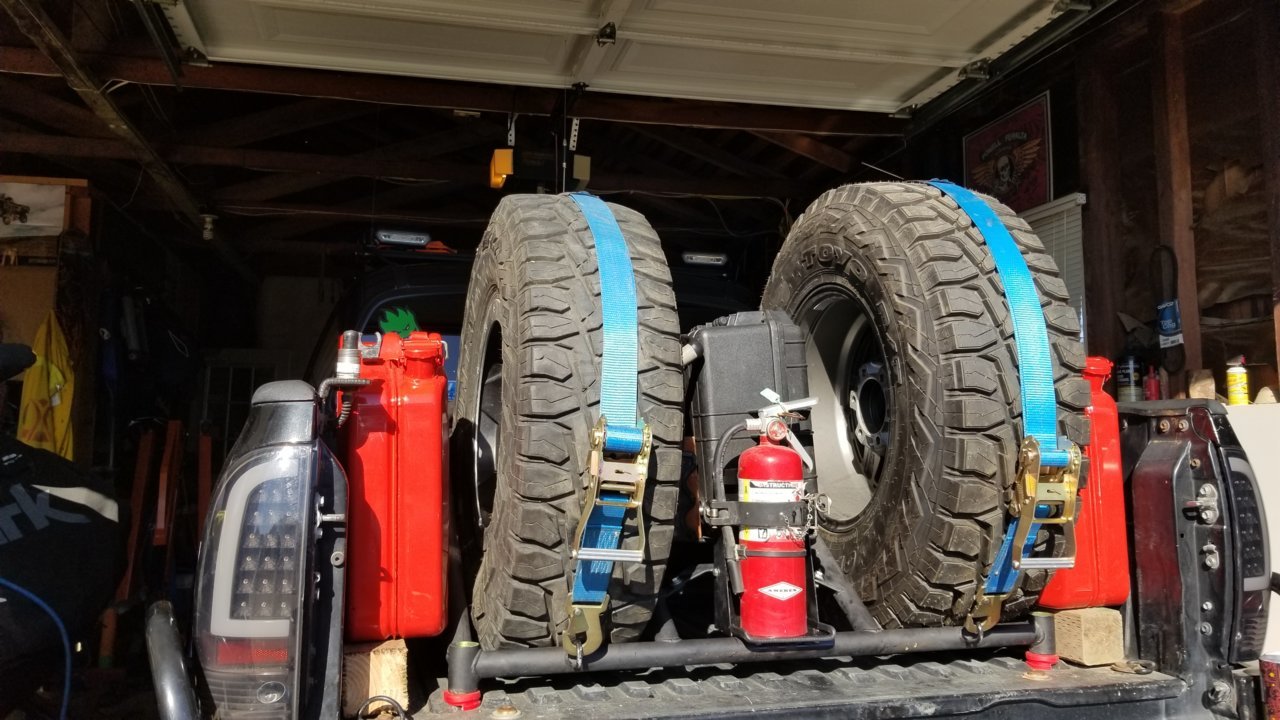

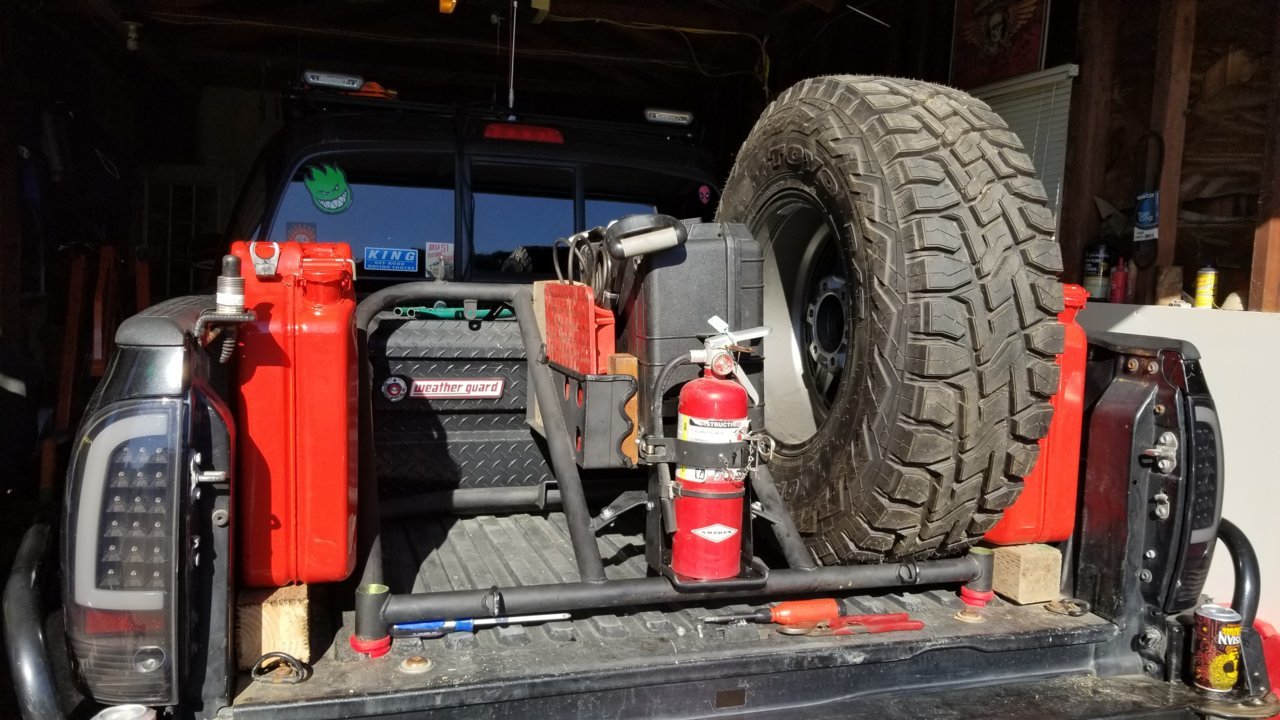

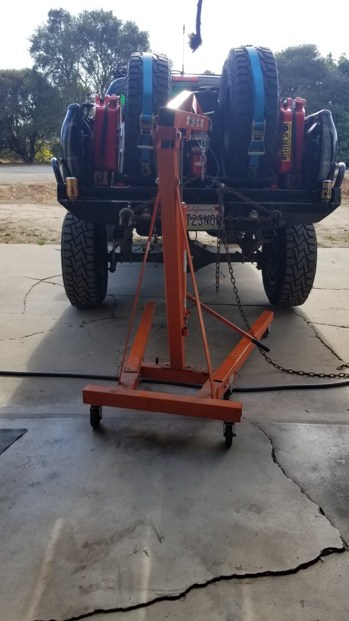

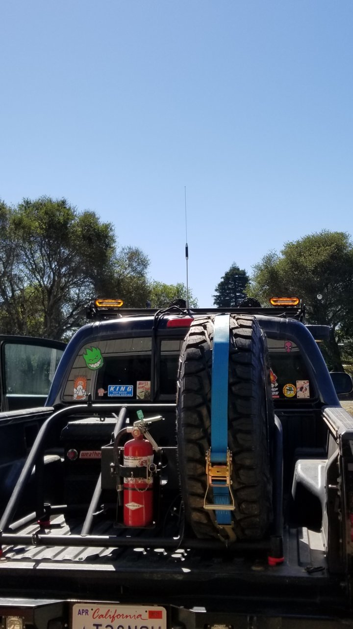

    Today's progress
    Swing gates off
    Still have to rewire chase lights
    Beer can to the rescue
    All bolted down

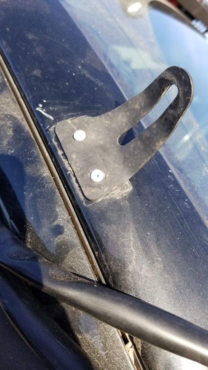

    Chase lights on uptop rack now

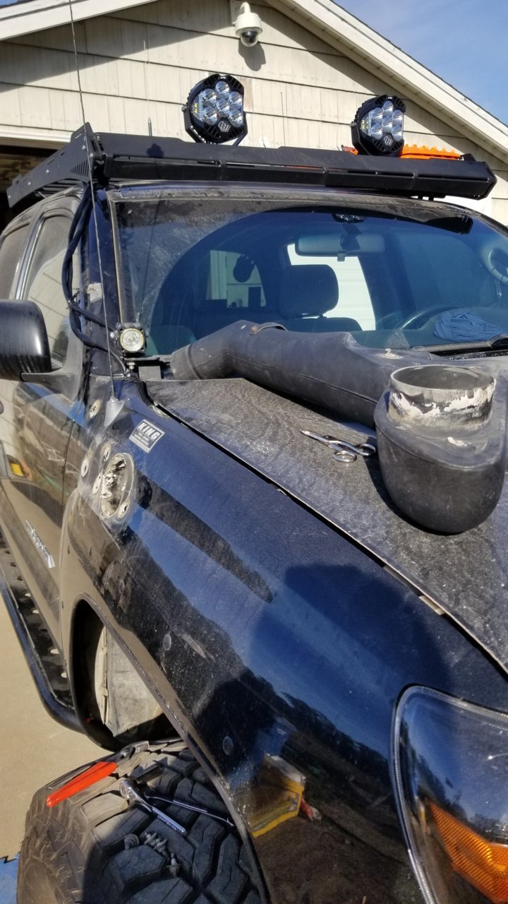

    Re-attatch snorkel to pillar with rivits. The super velcro was not enough.

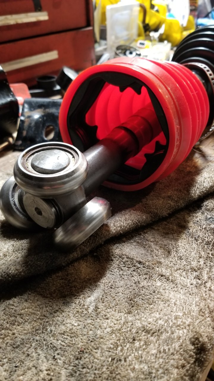

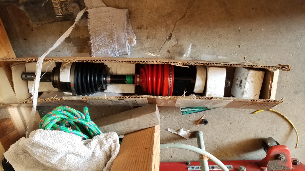

    Fitted up spare cv with new boot.
    Going to wrap the hood this weekend.

    Spare cv axle ready if needed

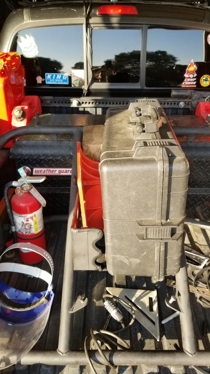

    Still working out bed storage details

    Good fit for the recovery gear box

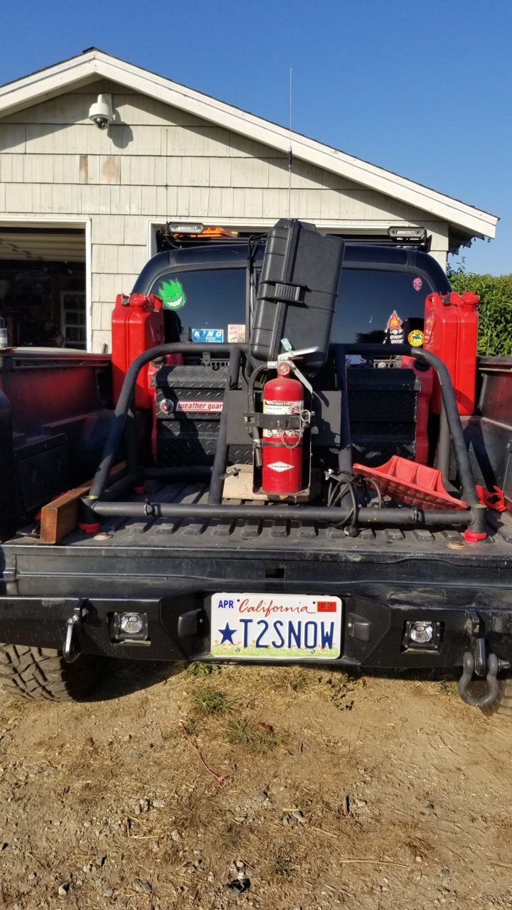

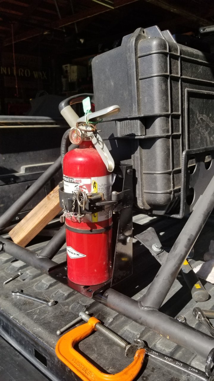

    Mounted up the fire extinguisher this morning. This position will keep the recovery box in place.
    The recovery box did not fit in the box that the rack came with so I chopped of just enough to fit it and hold the high lift stand and a nice wood block. Finished it off with some of that fender edge trim.

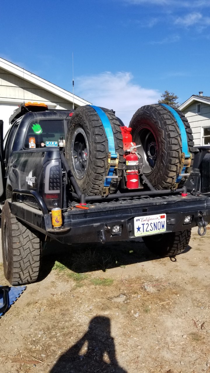

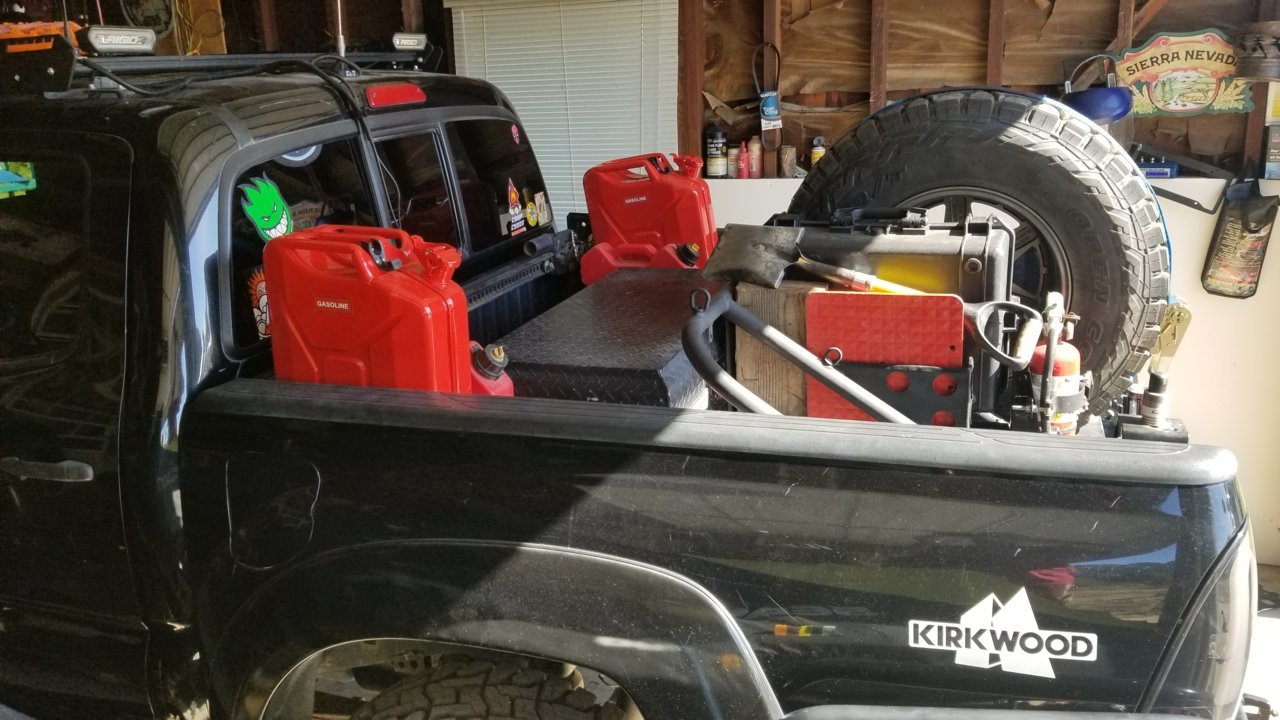

    So there is gas cans up by back of bed or
    Latest revison gas cans at end of bed? I am leaning toward the end of the bed for easy access.
    Bonus 4x4 for trail repair type shit.
    MattCowsmasher likes this.
  16. Oct 20, 2020 at 3:27 PM
    #136
    Taco-Obsessed
    Dec 23, 2018
    #276756
    7,448
    I'd go with end of bed. Looking good.

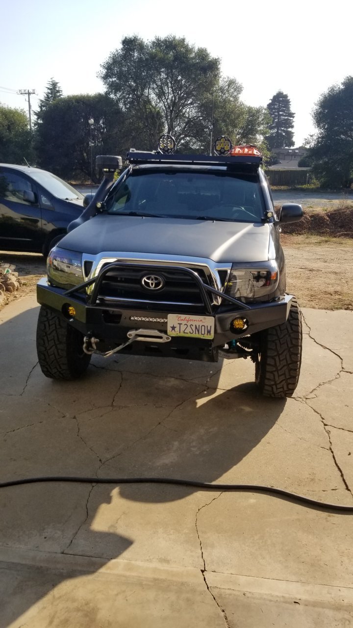

    Definitely making progress.

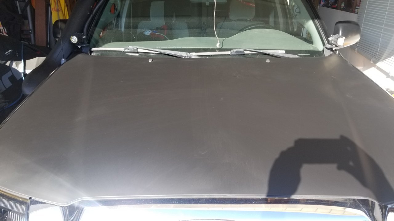

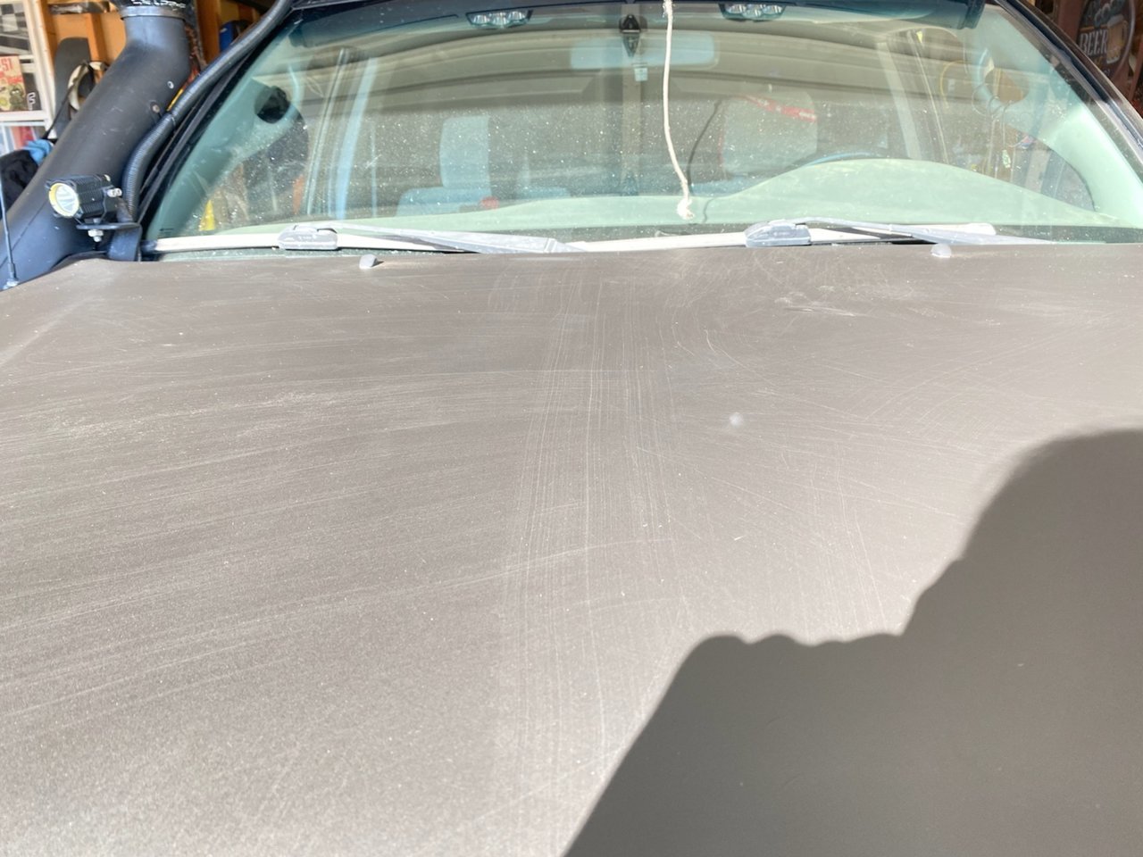

    So currently i am disappointed with the vinyl wrap on the hood. I installed fine but afterwards seeing it in some better light I see that the installation squeegee scratched it all up. Make sure you use a felt tipped or friction sleeve is what the company told me after I let them know what happened. Then they told me to remove the protective sheet that it does not have.o_OIMG_2405.jpg
    20201021_153447.jpg at this point they are refusing to replace it and I have been continuing to try and get a amicable resolution. Not ready to throw their name under the bus just yet. I blame the poor quality of the squeegee they sold me.
    lesson- use felt tipped squeegee and test it on a piece of vinyl before you install.

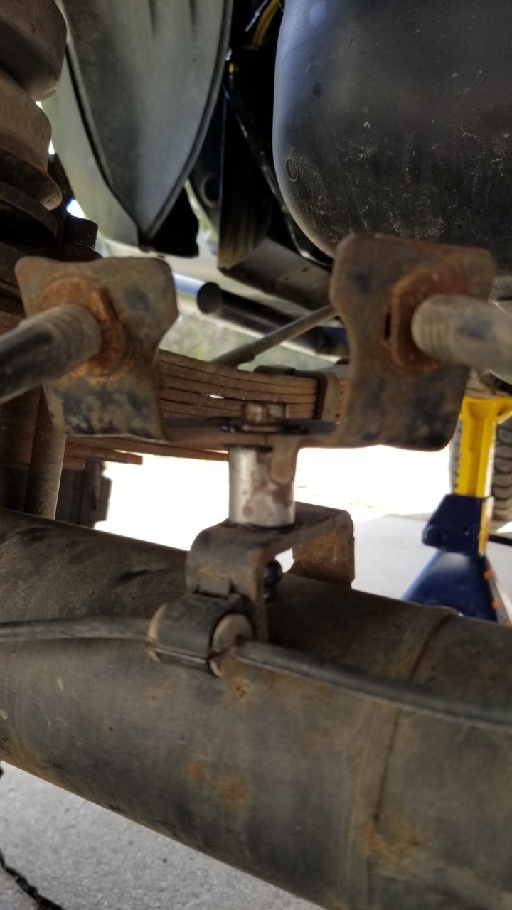

  20. Nov 7, 2020 at 2:05 PM
    #140
    Micatom33
    Micatom33 [OP] Under the Truck with Beer!
    Jul 17, 2013
    #108443
    1,673
    Santa Cruz,CA
    2008 BSP DCSB

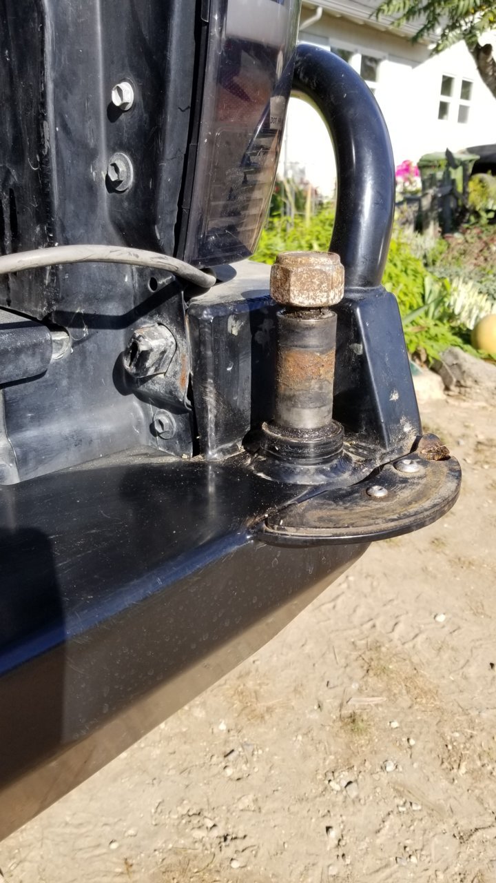

    Made a spacer for more slack in brake lines
