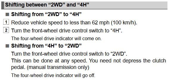

    I think the misinformation is coming from misreading what the manual says:
    It states that you need to be under 62mph to engage 4wd. It says absolutely nothing about speed once in 4wd. In fact, it states that you can disengage at any speed, which clearly indicates that it is find to travel over 62mph once in 4wd.
