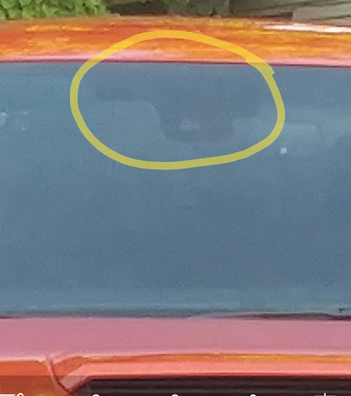

    To to right of the rearview mirror is where the camera sits.

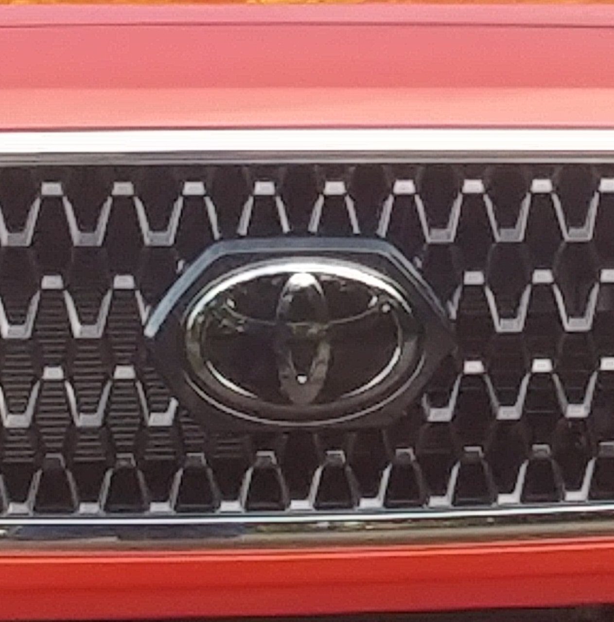

    The front sensor points forward, should just need to clean the face of it not behind it. It's the flat part of the grill not the honeycomb part. So you are not cleaning the emblem as much as the part of the grill below it

    Just clean these two areas and you will be O.k. No need to remove the grille or sensors.
