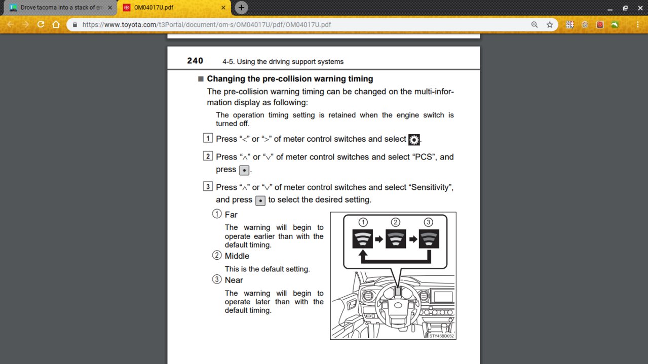

    You probably need to adjust the sensitivity of the radar. I have a '19 SR and you adjust the sensitivity with the buttons on the steering wheel.

    No. That is for the adaptive cruise control. You are not adjusting the radar's sensitivity. You are adjusting the following distance to the vehicle in front of you.

    NO, you can adjust the Pre-Collision warning, nothing to do with Cruise Control, that is a separate setting.

    Thanks. ChaseFan ignore my post.

    read the owners manual you have pre collision WARNING, not braking http://imgur.com/ls3Yntj.gif

    Maybe I am reading it wrong?
    "the brakes are automatically
    applied to help avoid the collision or help reduce the
    impact of the collision."
    Radar in OP is doing as it should. Does not see a solid object. Might as well be rain.
