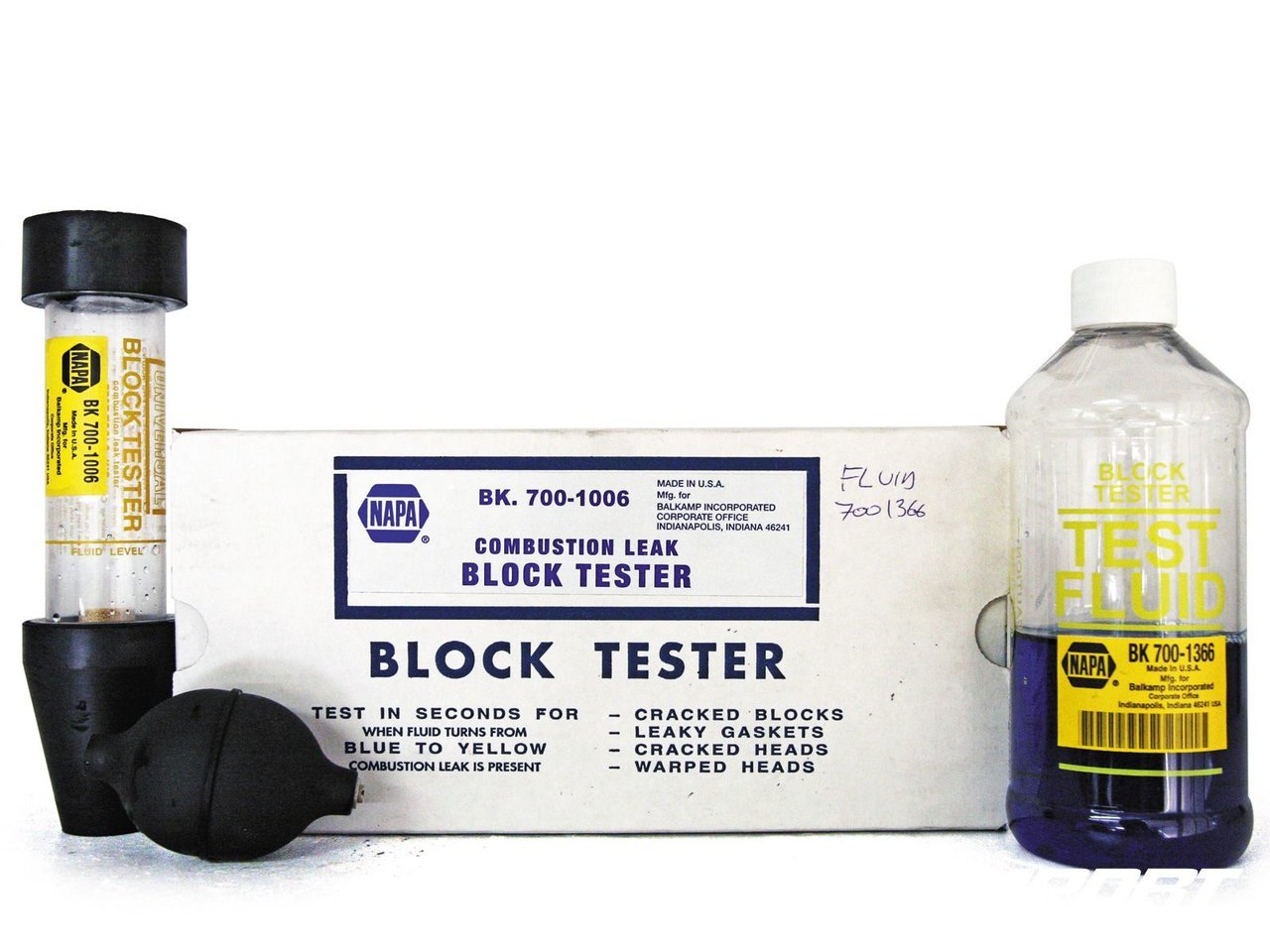

    that kit works great. used it to find a cracked block last week.

    Do the block check:fingerscrossed:
    Other than that there's not much you can do.. time will tell
